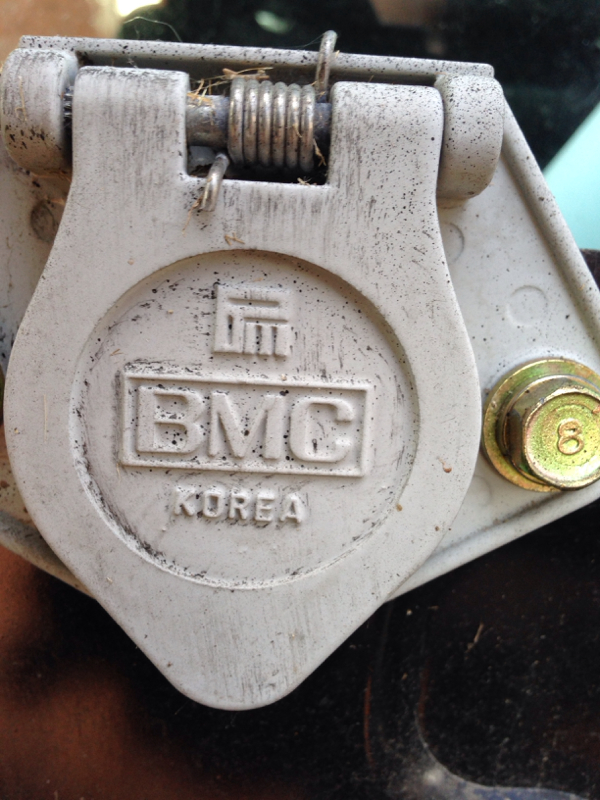

The small two leg connector goes to the work light. It has power when the key is on. Every factory Kioti work light that I have seen has its own on/off switch. The connector shown is for an adapter kit use for trailer lights. Many countries require the tractor to be licensed and for the trailer lights to work. Being this tractor is sold world wide, they just leave it.

The female pigtail plugs into it's male counterpart and provides wiring for a trailer connection to the tractor, as I stated/ suggested it might in post #2. The tractor also has a hot and ground for work light(s), not switched, but fused, for owner use.
If I was a dealer such as 'MIE' is...and not ignorant on the subject like I said I was (unfamiliar)...I would have linked the OP to the adapter that is needed to connect the pictured connector to a typical 7 pin trailer lead...
The pictured connector has zero resemblance to any typical 7 pin connector...and that is also a fact...!

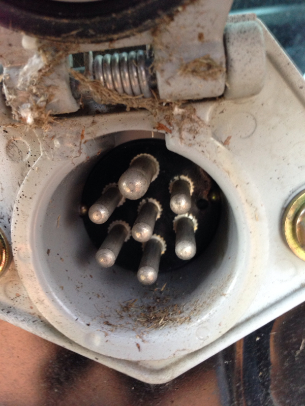

Let the watt's roll. I believe the connection shown plugs in the back of this plug.

MIE is a dealer in Michigan, ( Michigan Iron & Equipment). They should be able to get you part B of part A and B, of which you are missing part B. Once you have what Ozley showed in his pics, (thanks BTW for the pics:thumbsup:), you will be good to go to connect a 7 pin standard trailer pigtail to the socket you're missing. Questions?
And in response to /pine's comment: "The pictured connector has zero resemblance to any typical 7 pin connector...and that is also a fact...!"
It's on a South Korean made tractor. It may not resemble anything you're familiar with, BUT it does connect to wiring on a 7 pin socket as shown above, that renders it useable. FACT.
