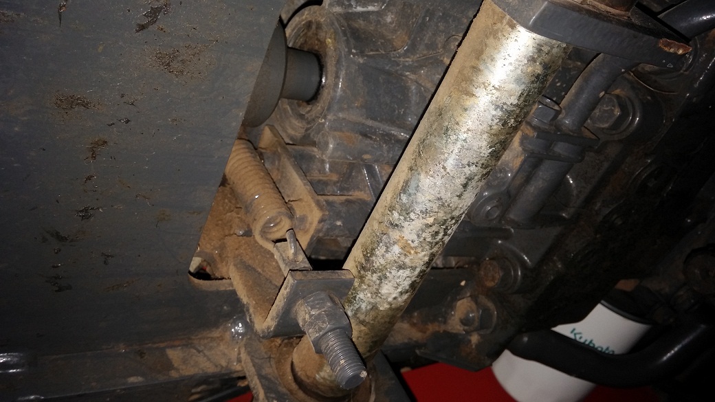

The spring has grey over spray on it...I doubt it belongs with the mower deck...Is there another implement (blade, blower etc) that it may belong to....BTW...What is the model # of the deck... eg RKCxxxx...I tend to believe some of the previous responders that it belongs to the tractor and possible something doesn't work as well as a result of this broken spring..
   / What does this spring go to? #12
My guess is that went up from the bracket it's hanging from. Do your brake pedals and clutch still work normal?

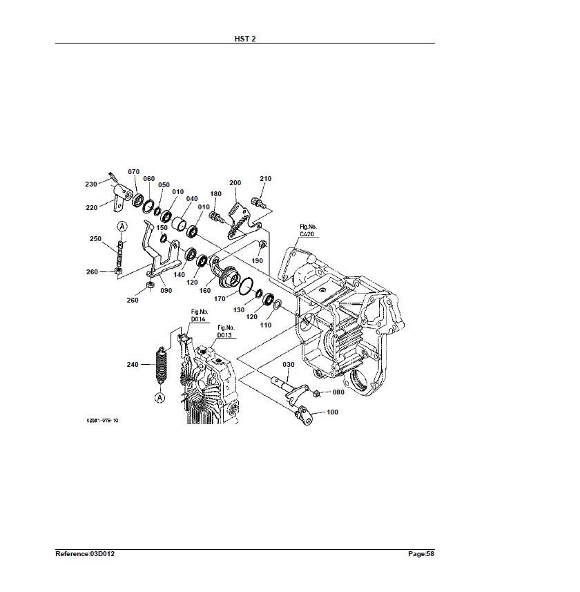

If you go to Kubota.com and lookup parts for B2320HST. Look at the transmission section and I believe it is the last section, and there is a spring that hooks to an adjustable rod that looks similar to what you are looking at.
I found it and tried to post a link to it, but it is in pdf and you could not open the page afterwards. :(

I was putting my mower deck on my B2320 hydrostatic tractor and found this spring hanging down.I looked on Messicks website and even went to the dealer and they couldn't find a picture of the spring.Any clue to where it hooks too?
Didn't have time to see exactly what it hooked to, but here is what it should look like.

The spring is broke on one end.

Everything seems to still work normal
