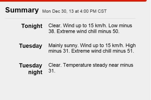

I guess I should have taken a video but my Kubota B2620 start fine in cold weather.
I kinda have to shake my head as starting in cold weather is all about the prep. work and care / attention to the details.
Used my snowblower (60" Buhler on 3pt) on my Kubota B2620 to clean the yardsite to make parking for family during New Years Eve around my hunting / summer cabin.
Temp was -38c (-36f) and with windchill it was closing in on -51c (-60f) so actually colder here than the North pole!
In an unheated - detached storage shed I gave it 90 minutes on the block heater, 60 minutes with battery charger on the battery, hit the pre-heat for 2 10 second cycles and it fires up first with throttle set at 1200 rpm.
I live in Manitoba Canada and we are in a wickedly cold snap now.
