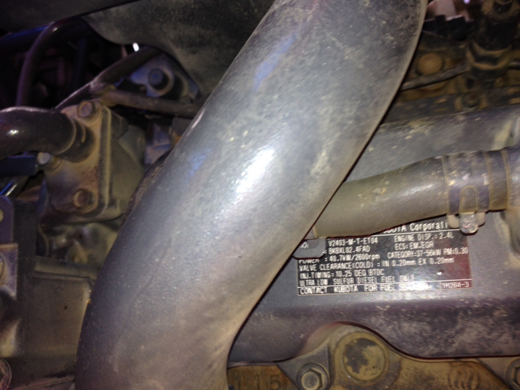

Here is a pic of the sticker on my valve cover, I was wrong before when I said the timing was 8* btdc it is really 10.25*. I'm waiting on my new cold start video to upload and then I'll post it.
Interesting.. yours is turbocharged, right? I remember seeing one that was 17-18 degrees, the same as mine, but that may have been a 4240.

Interesting.. yours is turbocharged, right? I remember seeing one that was 17-18 degrees, the same as mine, but that may have been a 4240. Sean
yes it is turbocharged but the timing is retarded because of the egr/emissions. I believe 50 hp was the cutoff for egr, the lower hp models don't have it.
