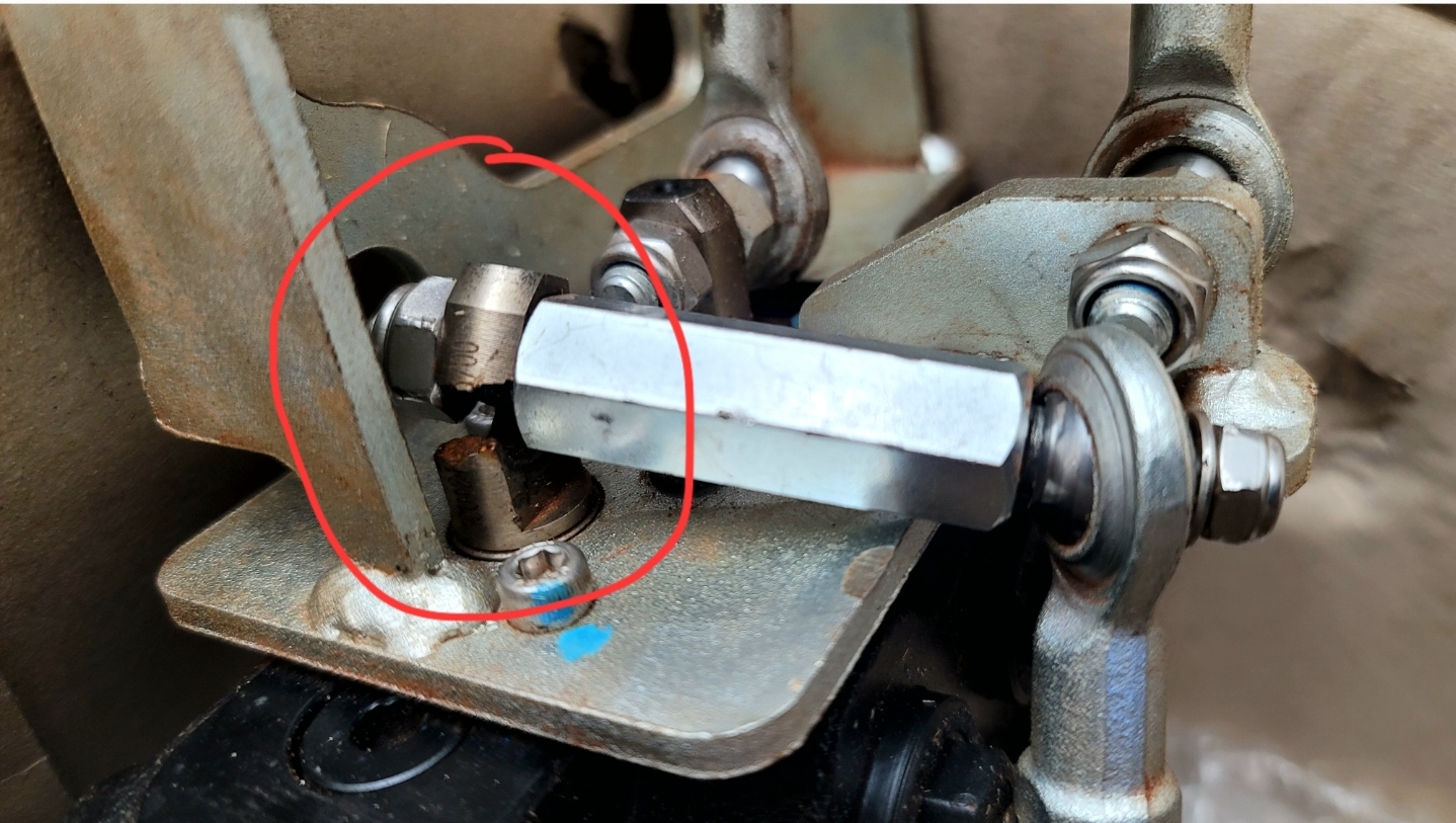

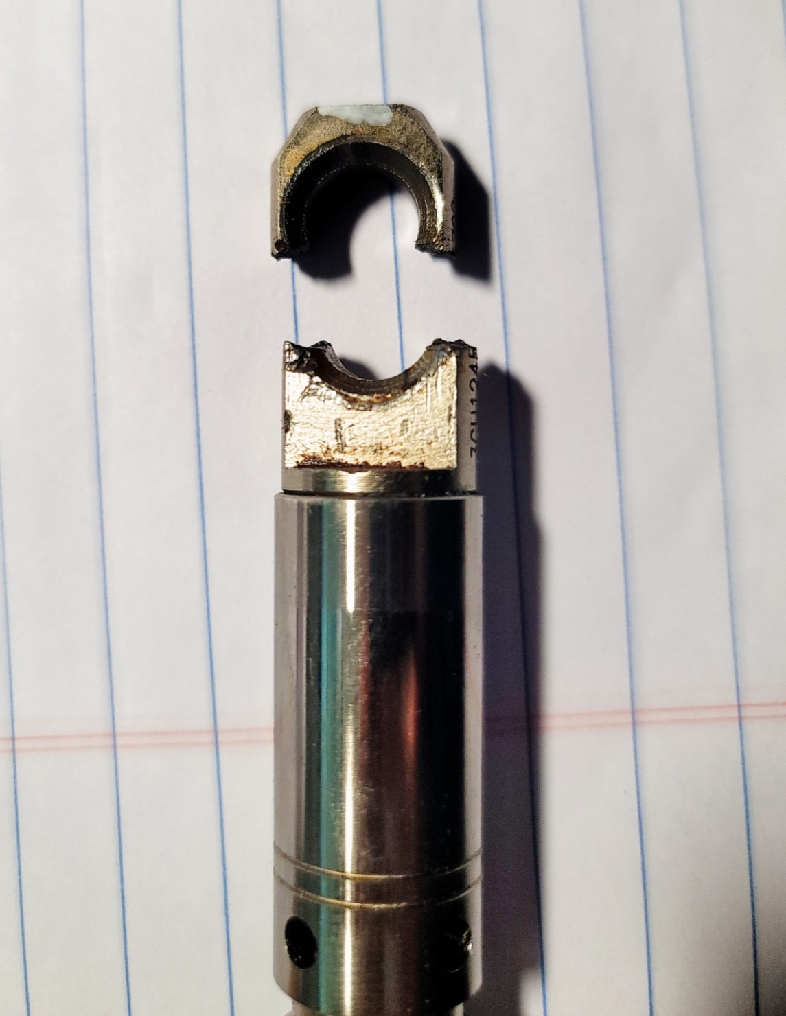

Not sure I understand #1. Moving the FEL to float physically hits one of the hydraulic connections and knocks it off? If so, which valve? one on the FEL, or a front remote/3rd function?
On the MT225s, pushing the bucket control down so the bucket goes to the ground. Then a push pressure down to engage the float function. A down pressure on the bucket control is an up pull on the valve. This up pressure snaps the top of the spool off.
No...take a look at the picture on the right...Moving the FEL to float pulls the valve spool upward which cracks the connection to the control lever assembly.
