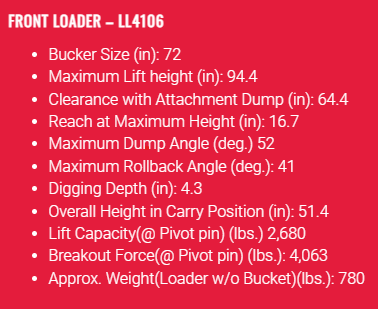

I finally found the limit on my MT357HC. Was trying to pick an oak log up and the loader with forks couldn't pick it up. Log was 11.5' long by 28". I'm figuring it weighed about 2200lbs. According to LS specs for this tractor I should be able to pick up 2700lbs. Using the pallet forks I was able to get the log tight against the frame so it was as close as I could get to the pivot pins. I was able to move it but not lift. Rev'n it didn't make any difference. Had the wood chipper on the back so that was a nice counterweight.

Here's the info on the loader that is installed on my MT357.
Yes sorry I was definitely wrong, looked it up in owners manual when at home it’s rated at 2,718 pounds which is way more than I had expected .

It was a red oak, 11.5 ft long and about 28" in diameter. The tree had been dead a few years but the trunk was solid. I looked it up and found red oak to be about 45-48 lbs/cubic ft but I believe that was with 12% moisture. Figuring about 50 cubic ft I came up to the 2200lb+ weight. I did contact CID on the weight of the forks I had installed and they came back at 400lbs. All in, pretty close or above the 2700 lb spec on the loader for lifting capacity. I thought I read somewhere that white oak was heavier than red but it all depends on the moisture in the wood. My next purchase is a grapple which again will be 400+ lbs of weight but using that or the forks is better than cutting it up into small pieces until I want to.
