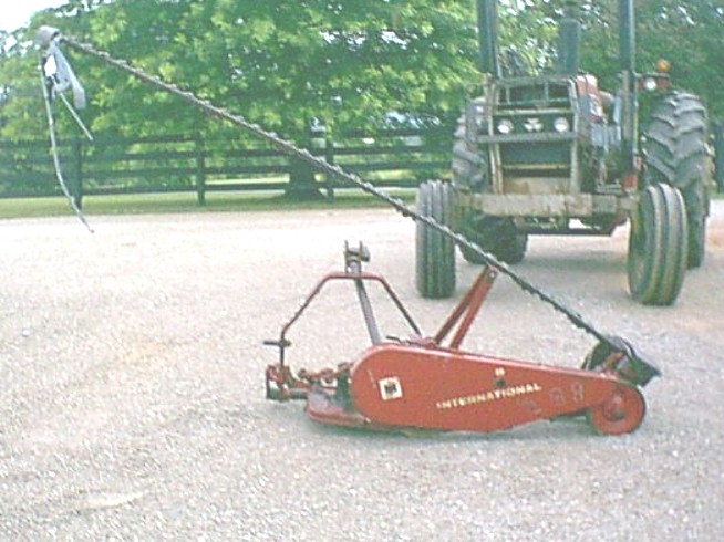

Here is the mower with the 9 ft reach and handy for many other mowing projects as well. International #1300 with 9 ft cutter bar. Standard catagory 1 three point hitch. Priced at $1750 + modest shipping. Ken Sweet

Is there a sickle mower that simply rides the terrain and doesn't need a rear hydraulic remote?
John
Both the 3pt mount and the trailer type will ride the terrain, the cylinder only raises the bar to clear obstacles... the tip and heal down pressure is set via a spring load, that lets the bar follow the ground. KennyV
John
We sell about 150 sickle mowers a year that do just that. The only thing a cylinder is good for, is when a operator has health or back problems and can't lift 40 or so pounds to transport position. Ken Sweet
