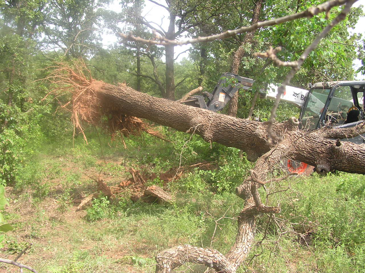

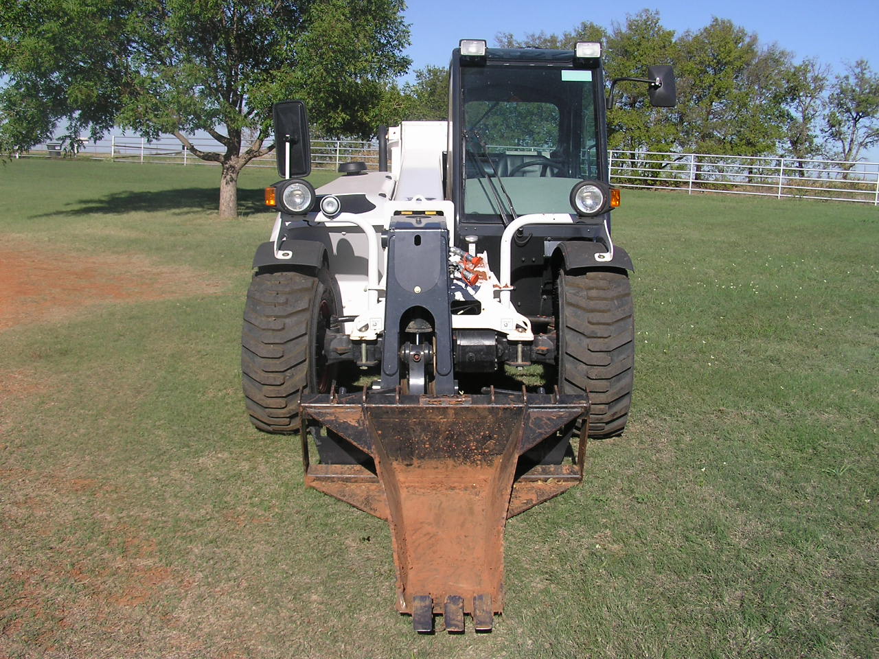

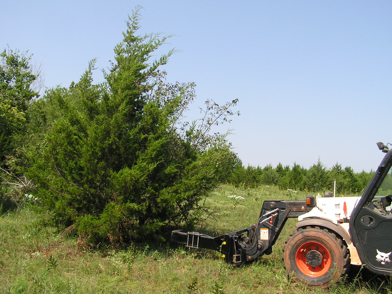

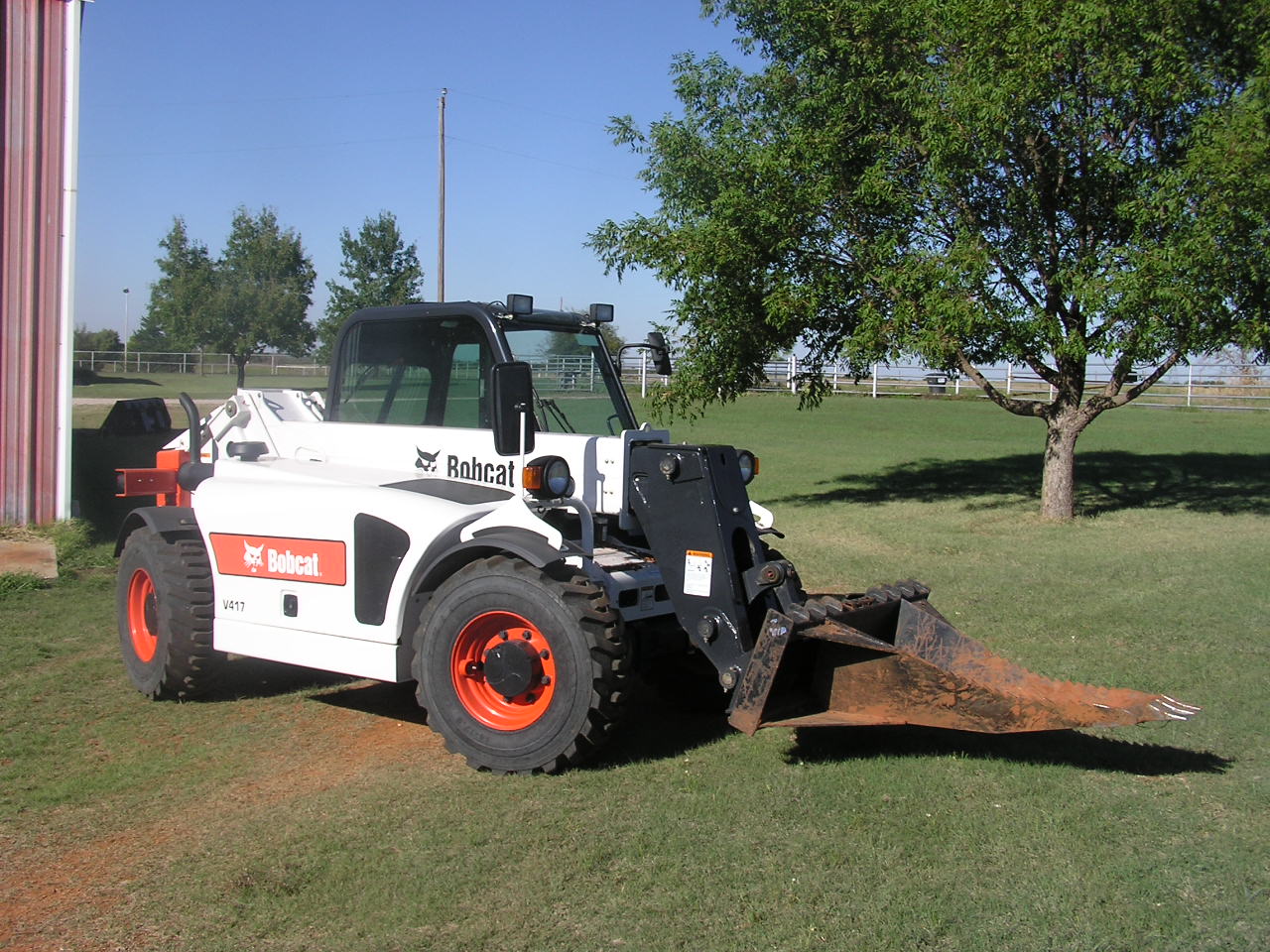

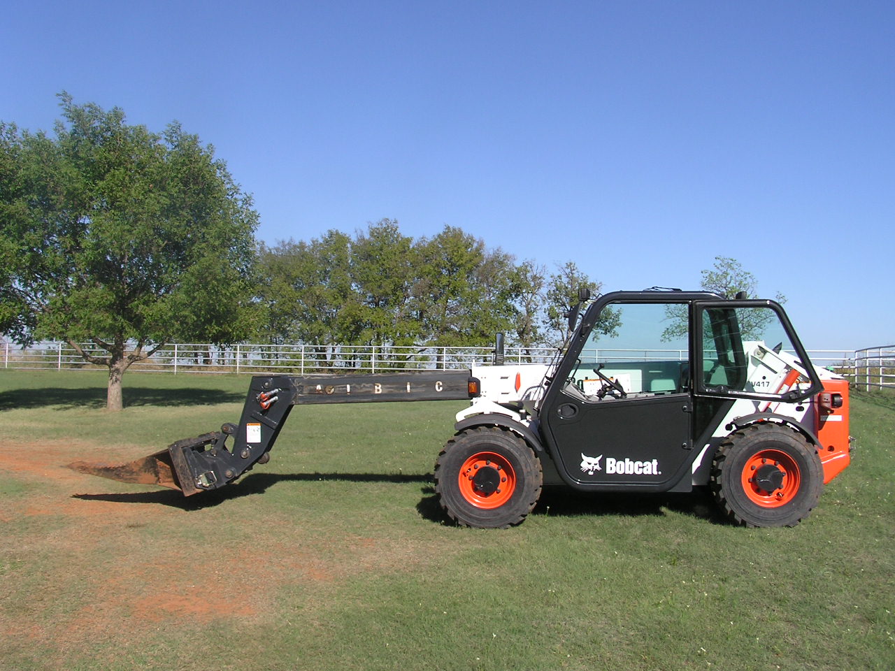

Not sure if you could find one to rent, but my Bobcat V417 is very stable on slopes and only 6' wide.

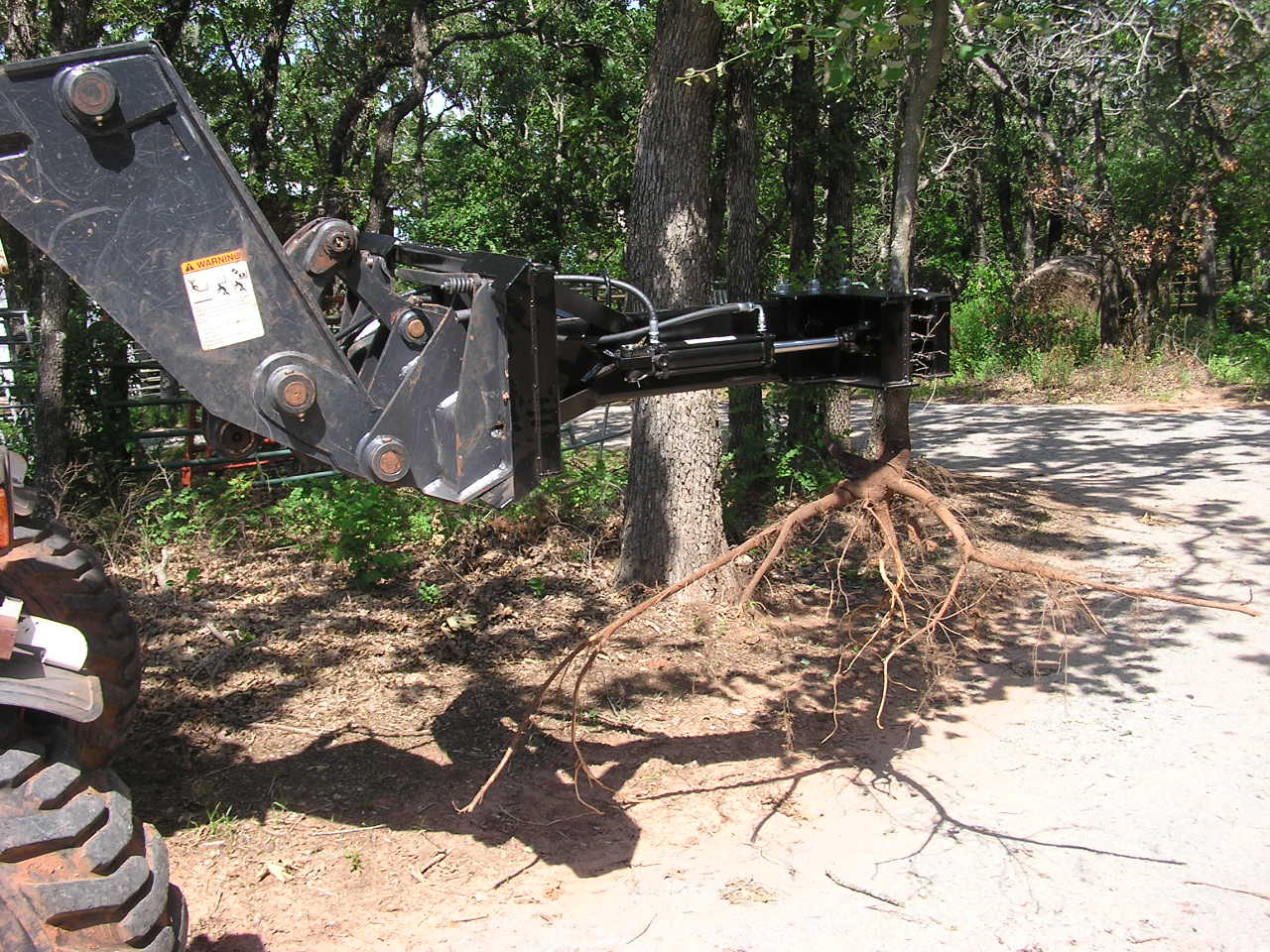

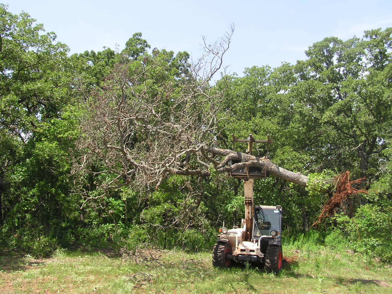

Pushed over this dead 40' tall tree with the stump bucket.
Click for more info: TODAYS SEAT TIME - Page 263

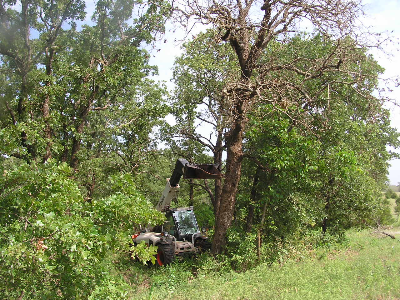

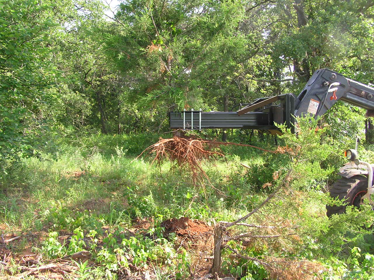

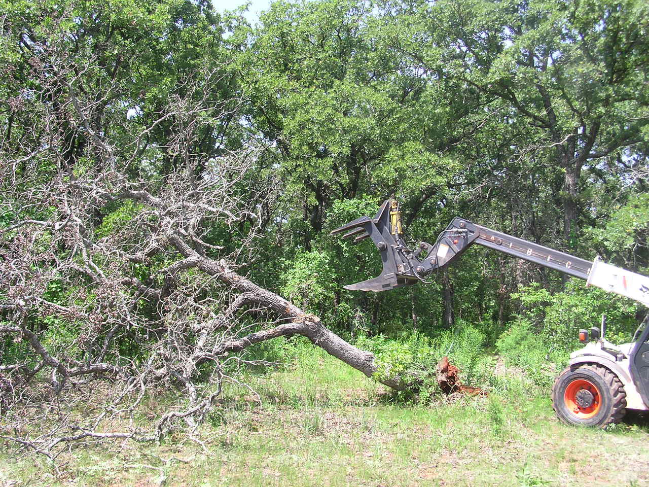

Another one with the grapple.
The rest of the story: http://www.tractorbynet.com/forums/...our-technique-removing-trees.html#post3356253

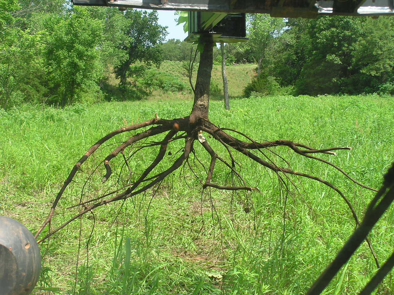

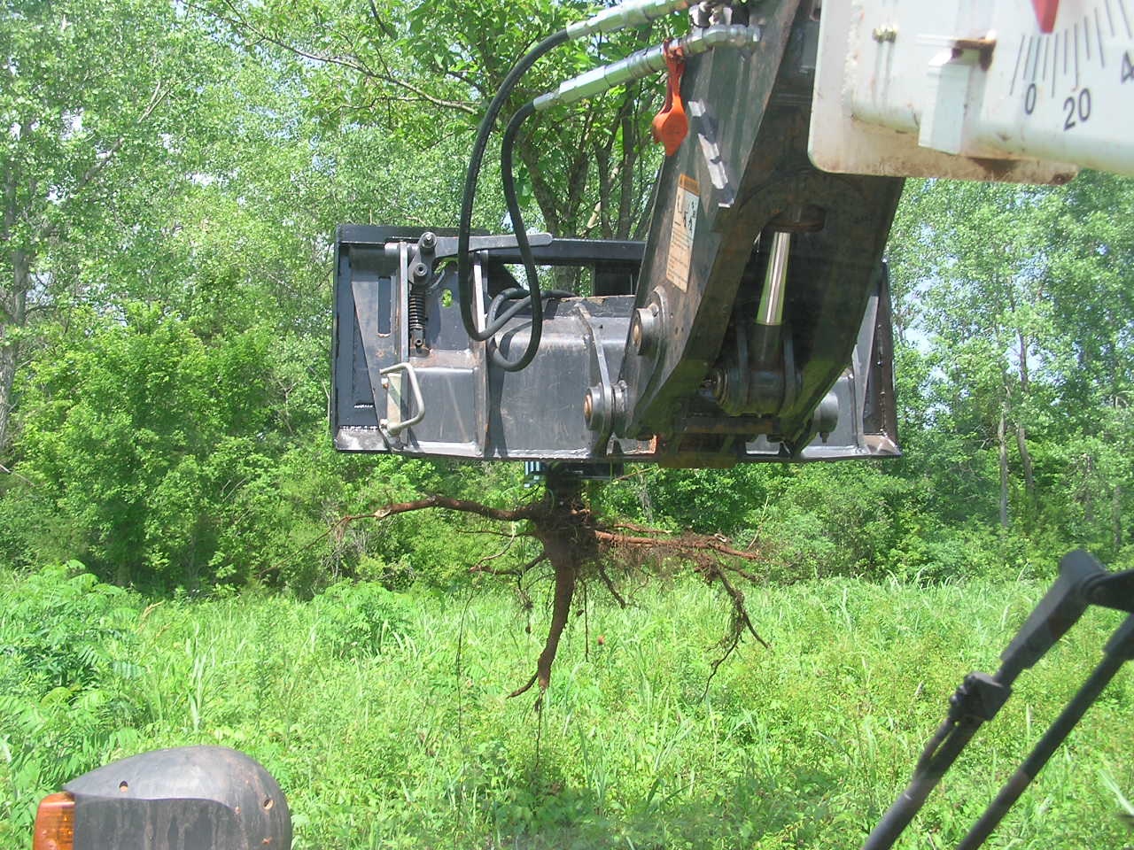

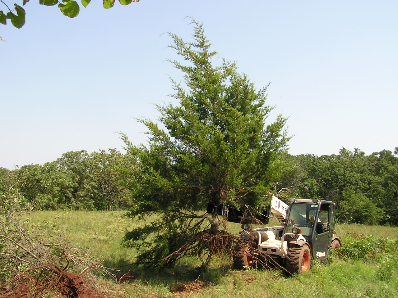

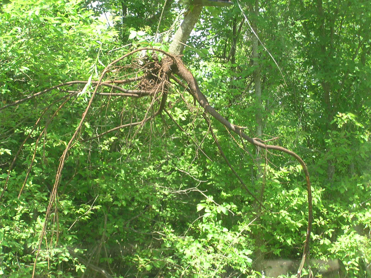

Just pull the little ones :D
P6140015.JPG P6140018.JPG P6140027.JPG P6140033.JPG P6140035.JPG P6210017.JPG
And the biggest one was two!
Details: http://www.tractorbynet.com/forums/attachments/277824-tree-puller.html#post3444397
