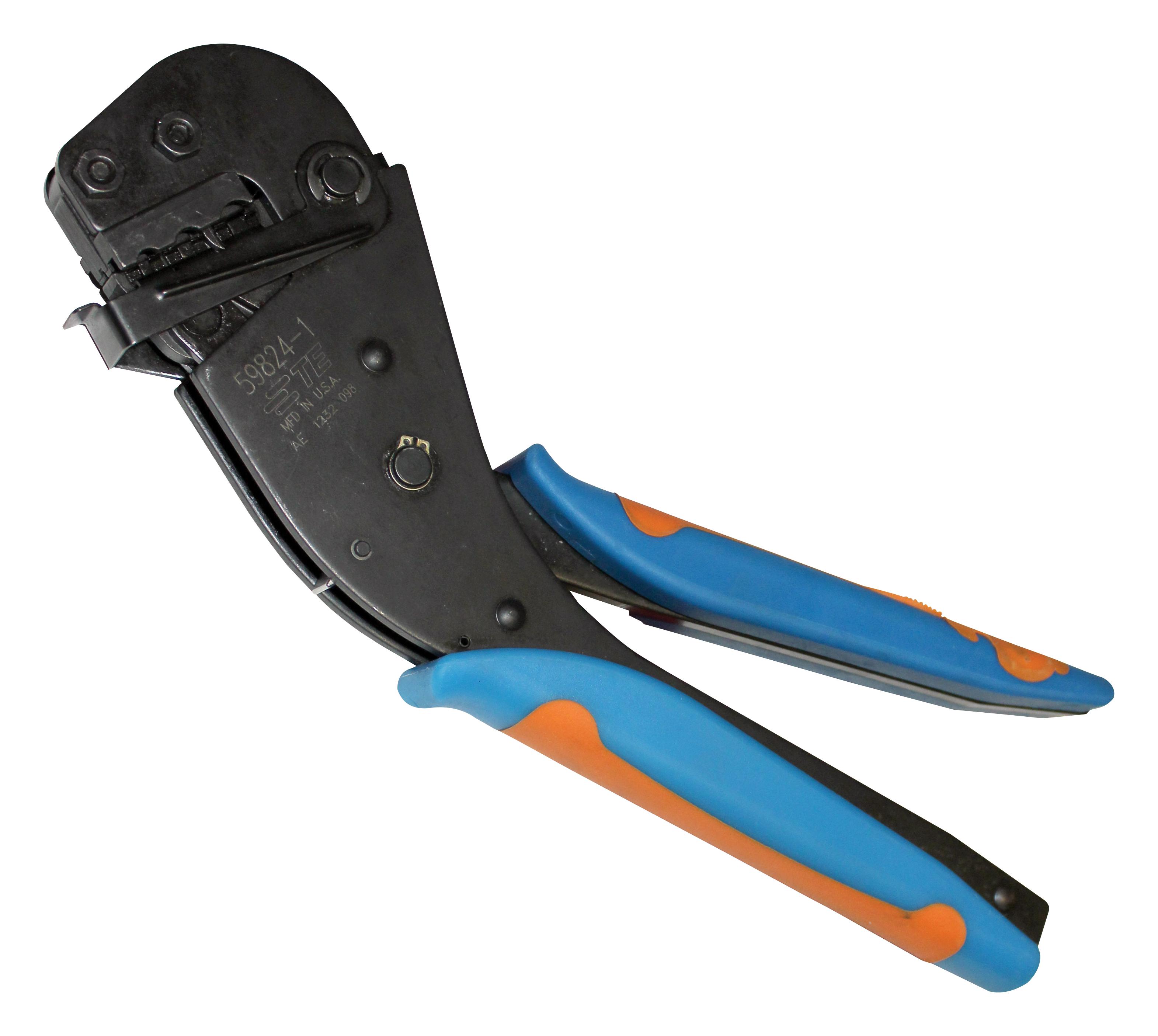

Years ago I worked as a quality assurance tech for a passenger rail car company. We would have to test the crimping tools to make sure the pins wouldn't pull off the wires when subjected to the listed force for the connector type. Often the government would have different levels of force. Because of this we always went to the highest level for our tests. If the crimper failed it was removed from service. I have several around the house. Industrial crimping tools can be found used on ebay as well. The work so much better than the cheap style crimping tools. This is the style I use for butt splice/ spade connectors. They make a similar crimper that has removable dies for doing the pins for the connector sets.
