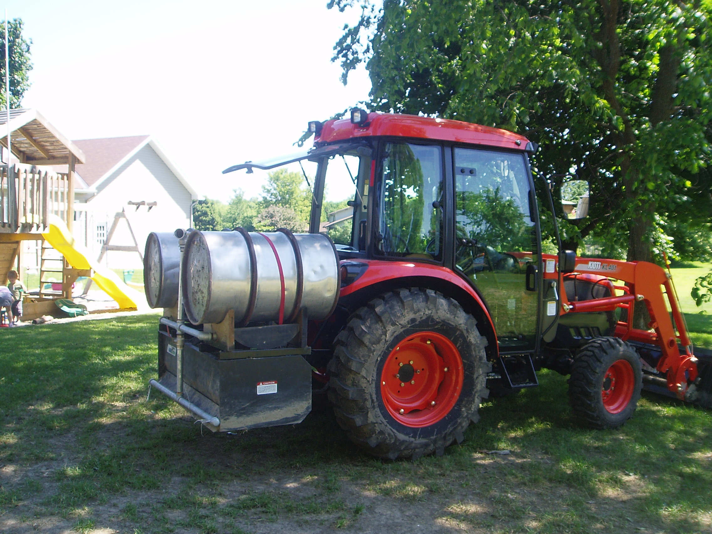

Thanks Mace, you've just described why I was concerned about using a heavier oil. Not many people get to "enjoy" stuff colder than -30 F or C, it really is an incredible feeling, although, it's pretty rare for me too. I was hoping that once the engine was running, it would generate enough heat to keep the oil warm enough, now you're casting doubt on that. When I'm flooding the rink, the engine is started and once the prime is established, run wide open for about 20 minutes. That's not what really concerns me. I'm more worried about when I start using my little zamboni attachment and fill up the two tanks on it. After they're full, I idle the pump, returning the water to the creek while I use the water, then come back and crank up the pump for another round.
I filled it with 10W30 earlier today, maybe I'll give it a second thought.
