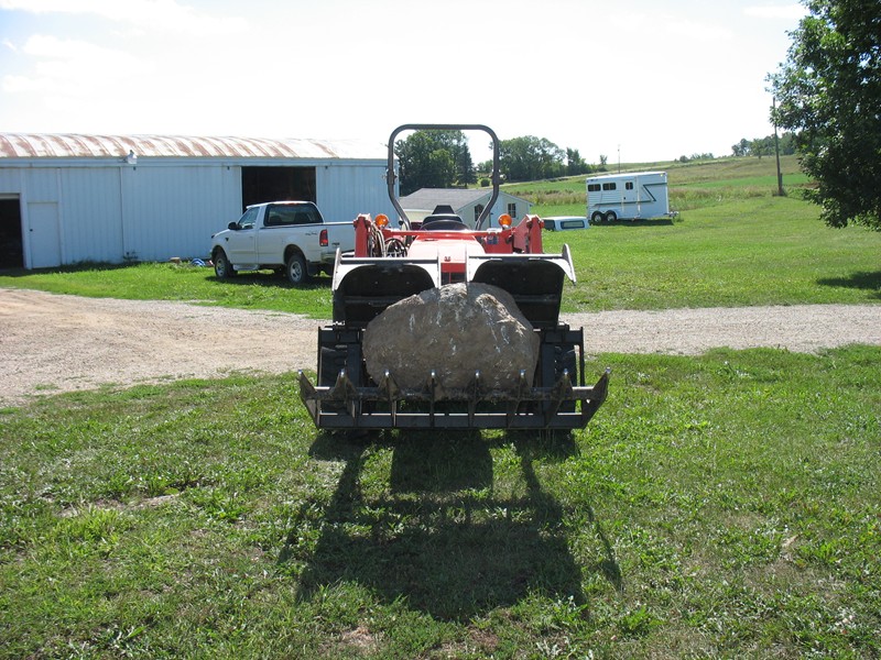

A potential downside of dual upper grapples, besides the added weight and cost, is how you would load a small but heavy object like a boulder. Presumably it is not difficult to have one side of each upper grapple grasp something in the middle but that then leaves you with the same asymmetric forces on the grapple jaw that are potentially harmful. If instead you grasp the rock with just one of the grapples, then you have an asymmetrical load on the FEL itself which ain't good for the loader or tractor stability. For an example, look at the big rock I pulled out of the ground in the photos in my first post. I could not have done that, I don't think, with a dual grapple.
I don't want to confuse the OP with arcane details of pros and cons of different grapple types and would reemphasize and earlier point that no one with any style of grapple seems to complain much at all about any deficiencies. Any grapple is better than no grapple.:)
This is how you pick up a boulder with a dual grapple.
