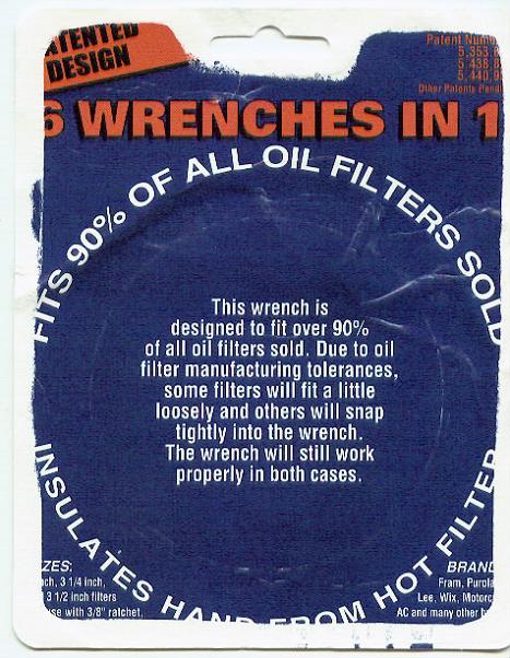

And that is exactly what I bought. It is tough getting any other type of wrench in there. So I got me one of them universal ones that you can spin around, slide in another do-hicky and you can adapt to six different sizes. Yep that is 6, I said six different sizes?? Big deal but I got it anyway from Wally World.

OK I just learned something here. I now have 3 different oil filter wrenches like the picture that I posted earlier and now none of them fit the new oil filter. You say Wally World sells one that fits 6 different size filters and you can still get on the oil filter behind the FEL mount?
I need to make a road trip back to Wally World I guess.

It does work on the large orange one behind the FEL mount. This is the hydraulic filter. It does work on the new smaller oil filter. It does not seem to work on the Hydro filter though. Which the hydro is out there where you can get at it pretty easy.
Attached is the back of the filter wrench. I will scan the front also next.

I still wished they would put the old 9/16" nut on the bottom of the filter. I have not seen one of them in a long time.
