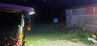

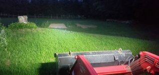

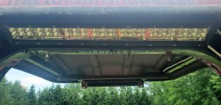

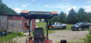

finished lights on sun shade. 20" led in back aiming down/out to wards my pto and 2 4" pods (mounted to my tail light hoops) pointing backwards.
then a 24" mounted on front of shade. am gonna put one on each side illuminating my tires on both sides.

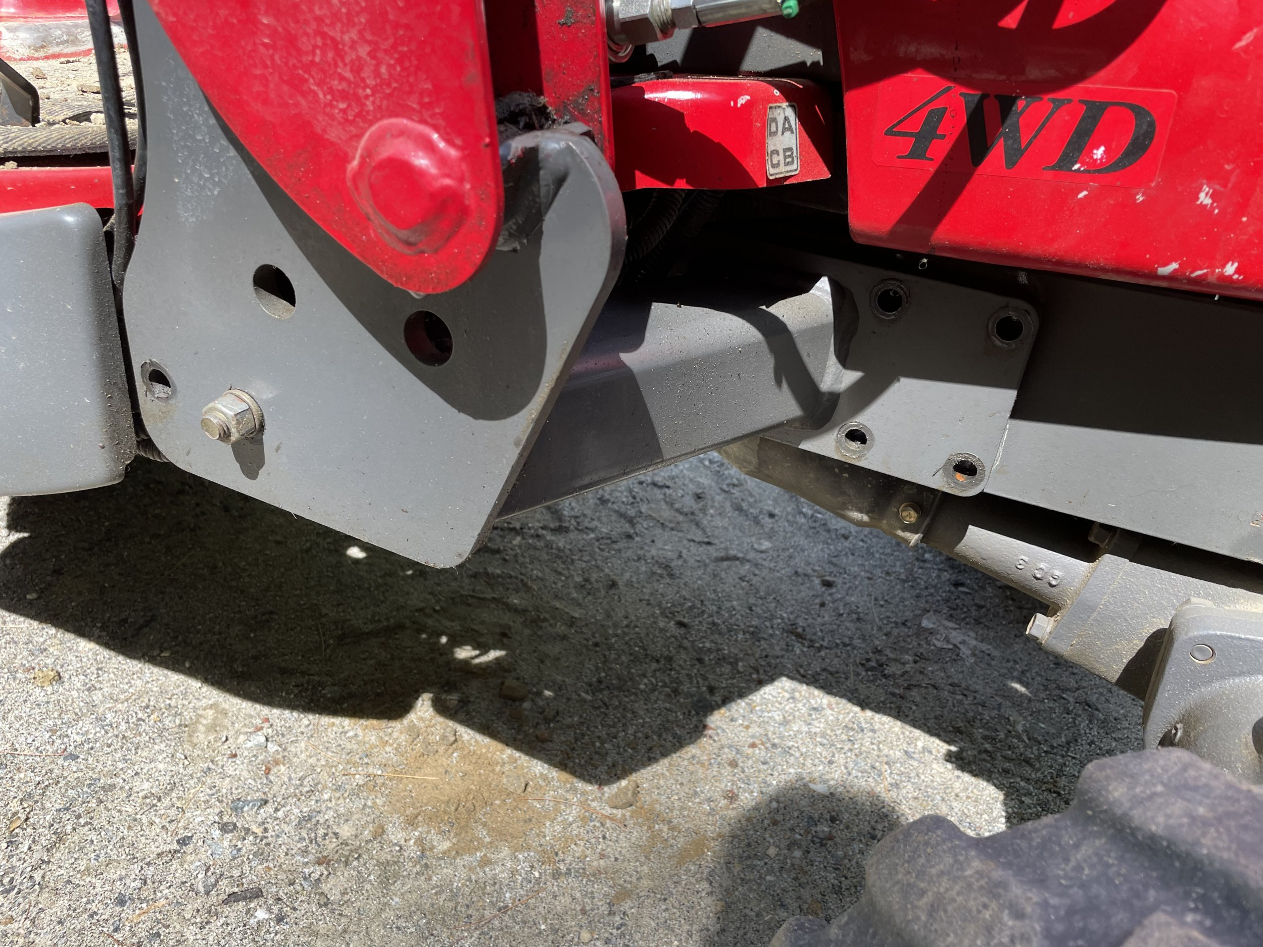

Working on my FEL after losing a few bolts and snapping a couple more. 🤬
I heard a snap when lifting a load and the the bucket leaned to the left. Ooops
Oh that sux, but yeh coulda been a lot(!!) worse. What method you use to line it up, with loader on or off?
   / What have you done with/to your GC Series 2300, 2400, 1700 Tractor TODAY #1,456
Loader was on but I couldn't get it to line up perfectly so I used a hydraulic lift to raise the chassis frame and then it lined up.

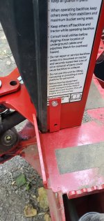

My Massey GC1723EB backhoe control panel anchor tabs snapped off. This is a simple fix. Two Stanley "L" brackets, a couple of bolts and some Massey red spray paint from Tractor Supply. I cut off the corners on the "L" brackets so they would not rub on the hydraulic hoses. The existing bolts on the backhoe platform matched up with the holes in the "L" brackets. I had to drill two holes for the side bolts. The control panel is rock solid now.
