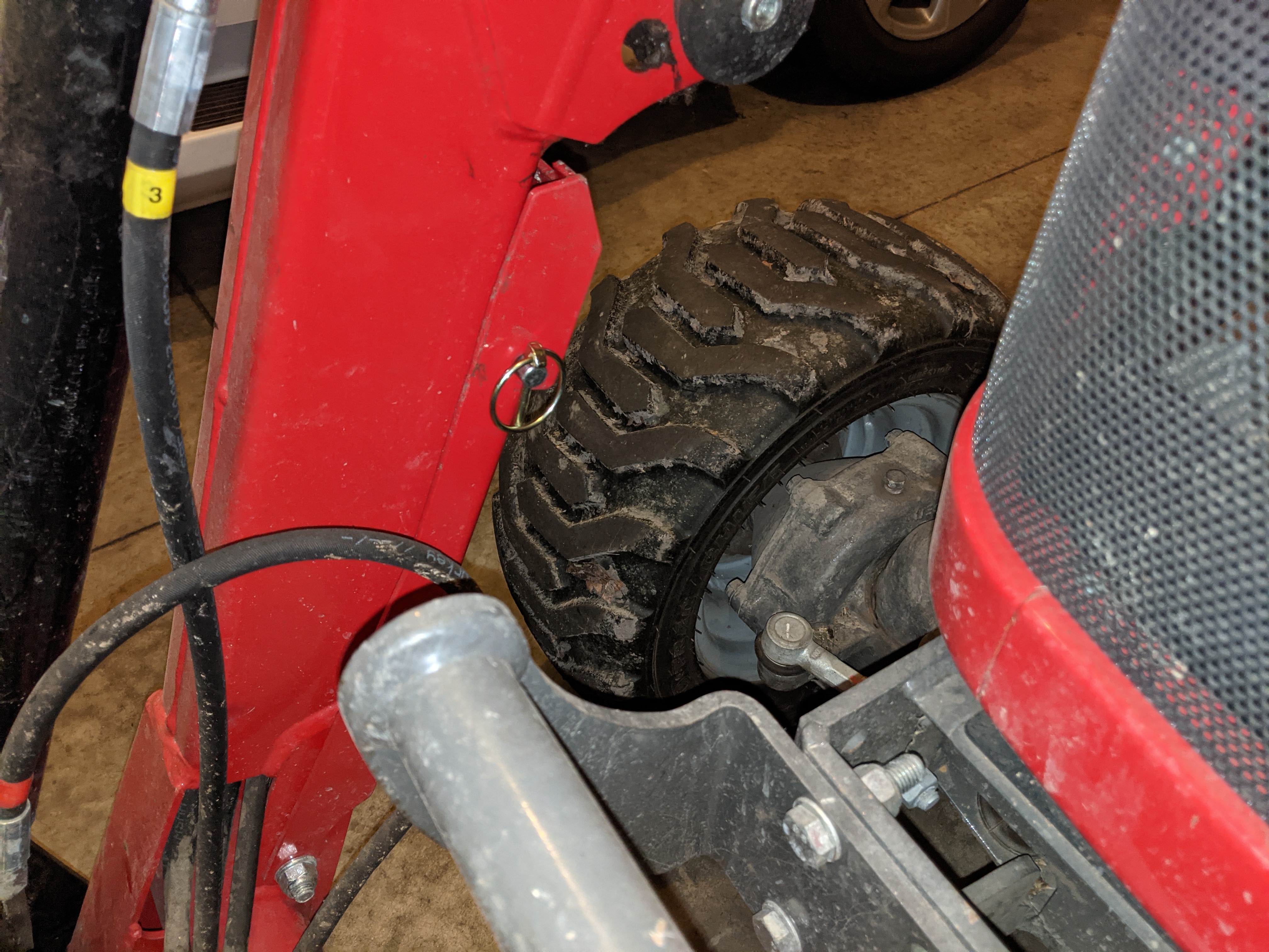

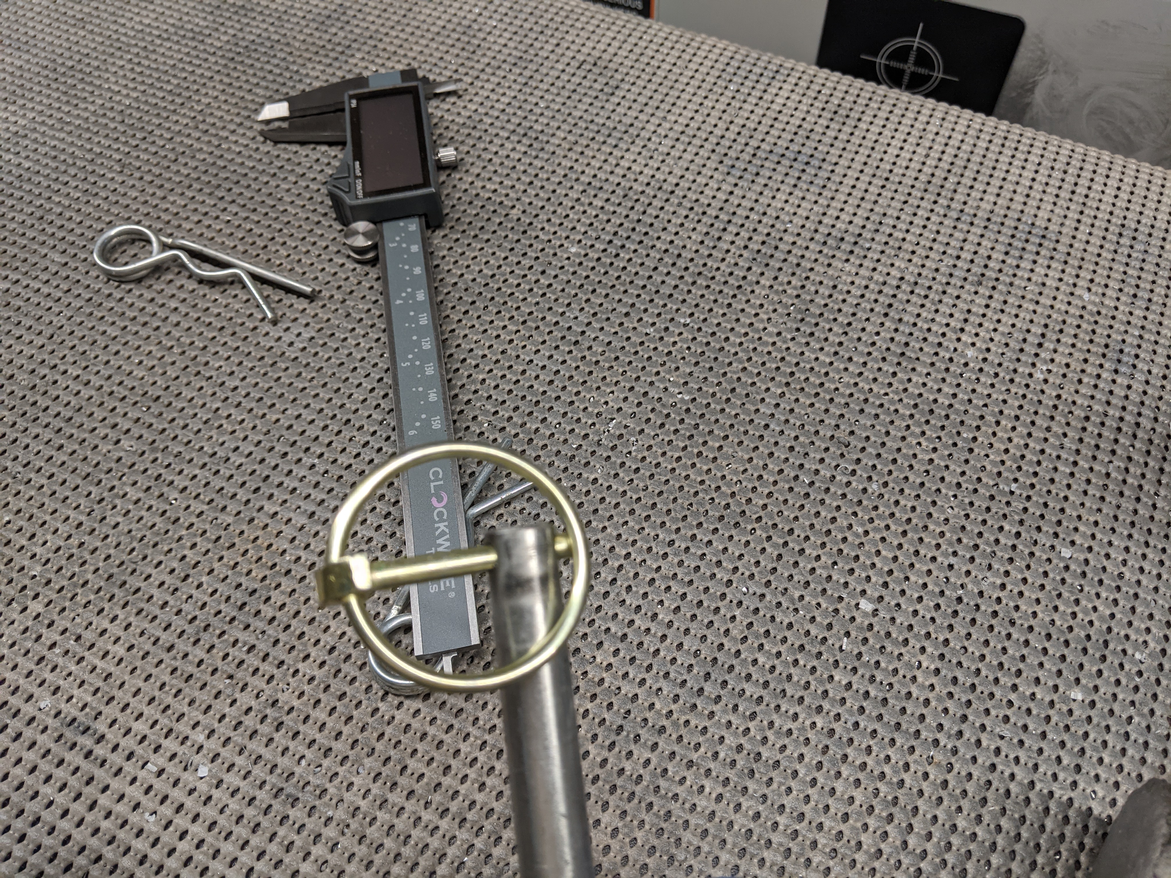

Thanks guys, yeh hair pin clips are just irritating to me, they had to go! Dmacleo, I got the lynch pins from tractor supply, they're like a dollar each.

Dave, your link took me to their general page. I'm sure all the tractor supply stores have a similar layout, around here the shelf with all the pins is at the back wall of the store.
   / What have you done with/to your GC Series 2300, 2400, 1700 Tractor TODAY #758
odd worked for me even logged out and different browser. of well internet is all magic anyway its a wonder it works.
was link to these
want to make sure on sizing as I have not done any measuring yet.
The SpeeCo S070904ZBU Lynch Pin can be used for numerous farm and other applications. The pin is zinc plated for long-term performance. Each pack includes two lynch pins. The overall length of the pin is 2-1/8 in., while the usable length is 1-1/4 in.
Diameter of pin: 1/4 in.
Usable length: 1-1/4 in.
Shank length: 1-3/4 in.
Overall length of pin: 2-1/8 in.
Clevis lynch pins are zinc plated for long-lasting use
Pack includes two lynch pins

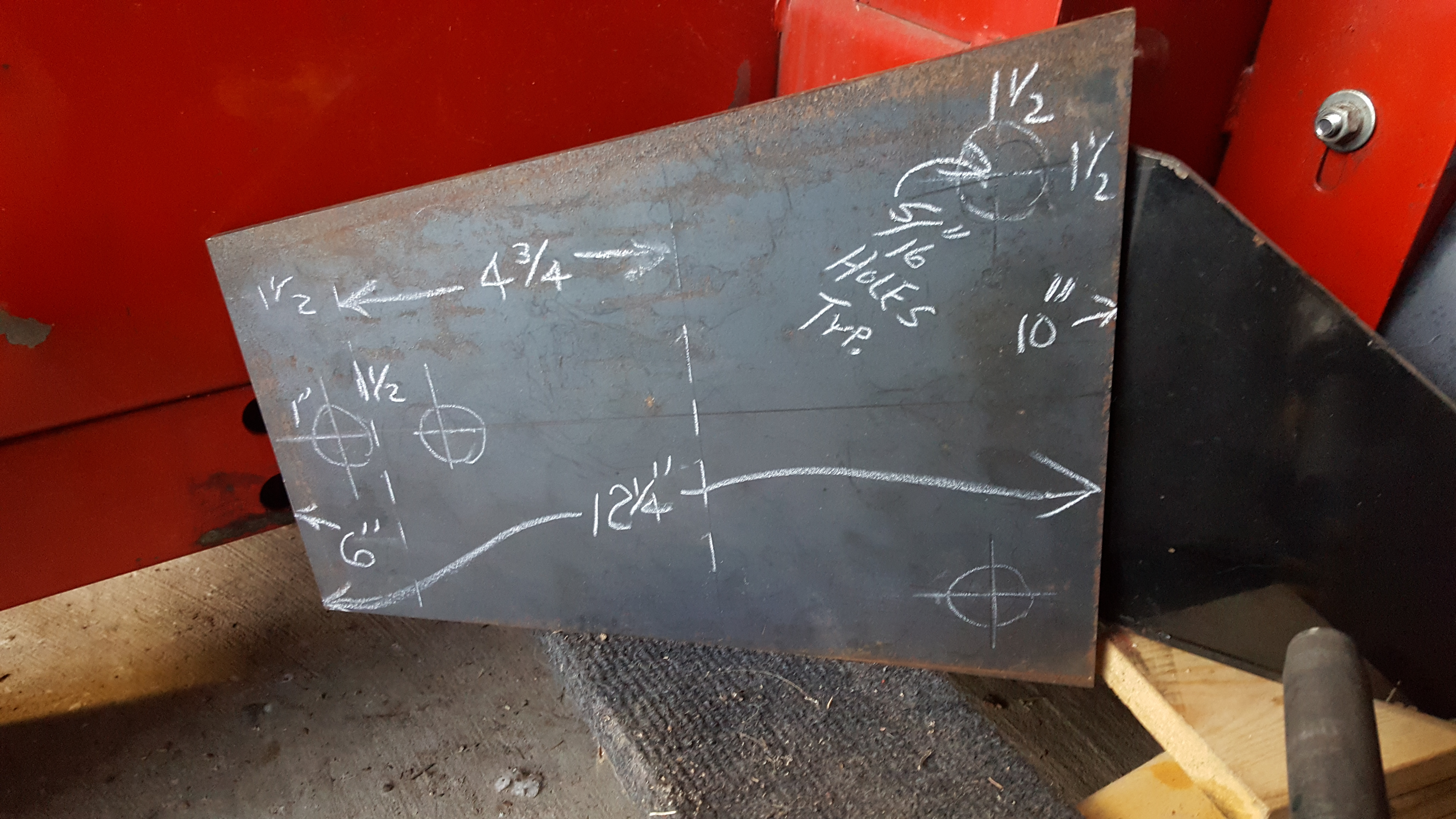

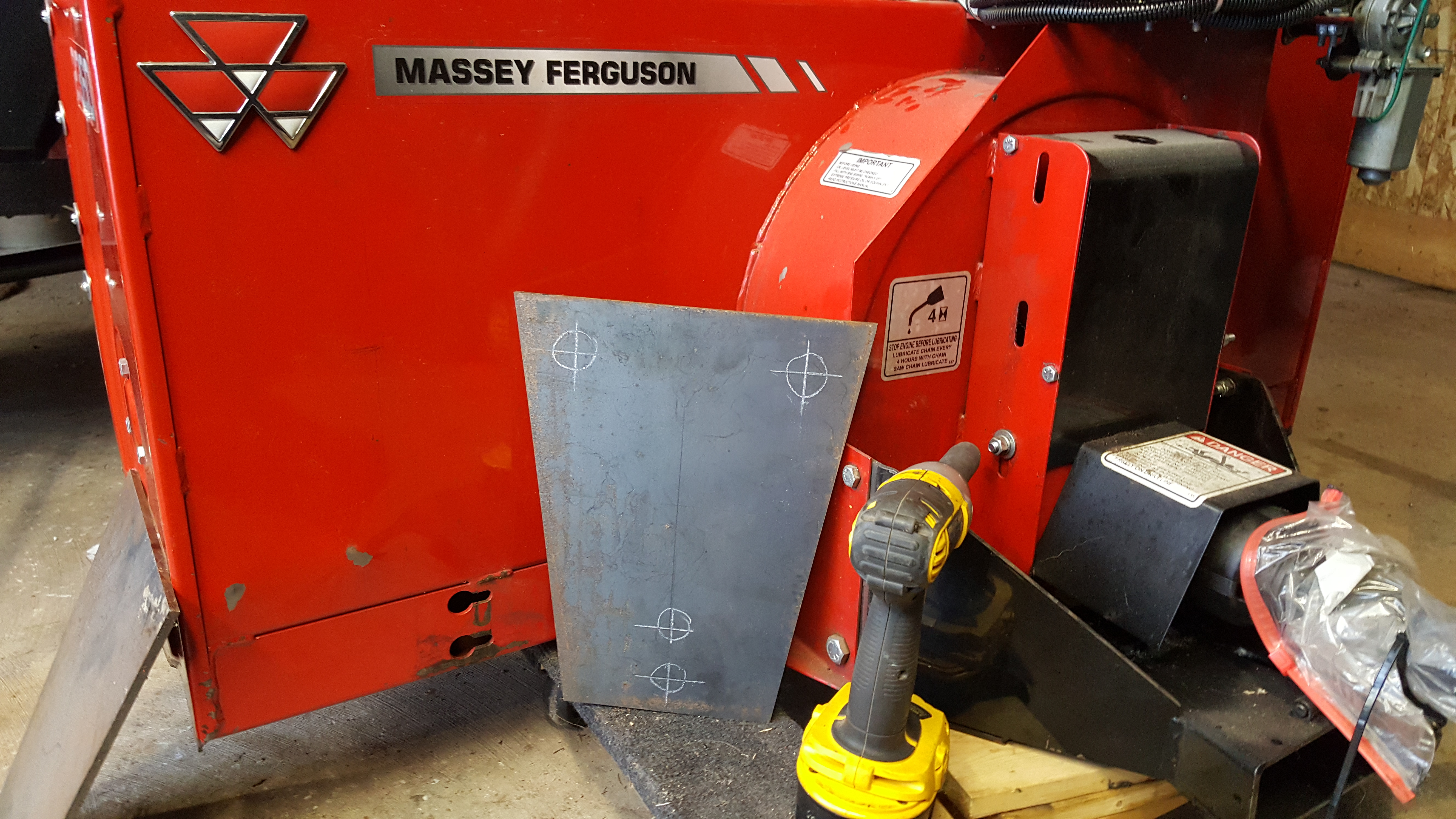

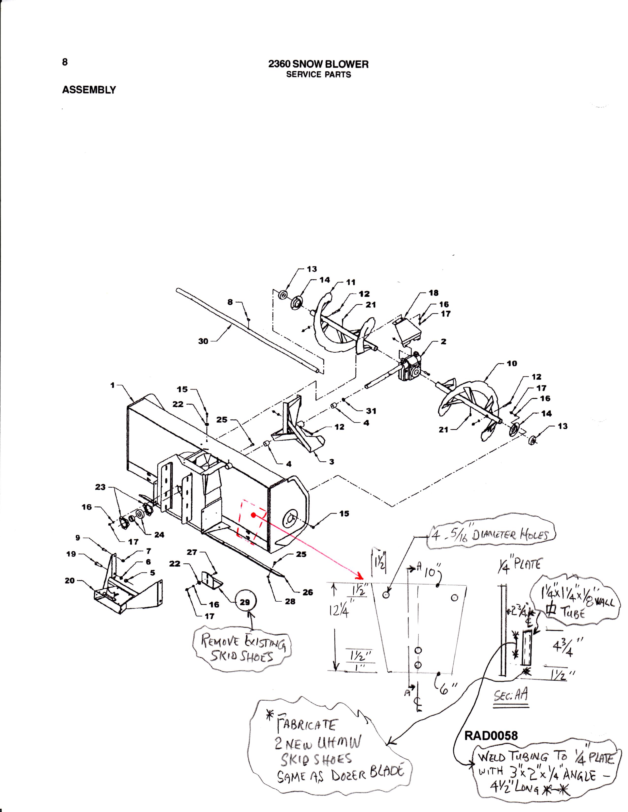

My previous postings for the new UHMW MF 2340 Dozer Blade skid shoe project are #671, #672, #675, #678, #681, #701, & #705.
And now I'm beginning the new UHMW MF 2360 Snowblower skid shoe project.
Upon thinking about this awhile, I'm decided to duplicate the Dozer Blade skid shoe size, 4" x 10", and use the same square slip tubing, and also use the same round spacer washers for height adjustments.
I'm going to use some 1/4" plate that I already have that's a trapezoid shape and bolt these using the existing skid shoe holes/bolts plus 2 more holes/bolts near the top of the new plate.
I'm going to use the 2 UHMW skid shoes from the Dozer Blade this winter and make sure they work ok for me before I fabricate 2 more of these skid shoes next spring for the snowblower.
Here's a couple of pictures of the start of this project showing the backside of the snowblower, and a sketch of the project:
KC
(for this project update see post #787)
20201227_112557.jpg 20201227_113811.jpg MF 2360 Snowblower Parts Book Pg. 8  .jpg
Also:
irvingj, my snowblower risers I added are only 12" tall.
And I'm going to add a UHMW cutting edge to my snowblower but it looks like I can only use a 1/2" thick piece.
Also I cannot bolt the existing cutting edge to the top of the UHMW because it seems there's a conflict with the snowblower augers.
I don't know if it's the same for your snowblower?
was link to these
HF has a assortment 50pc. kit.
