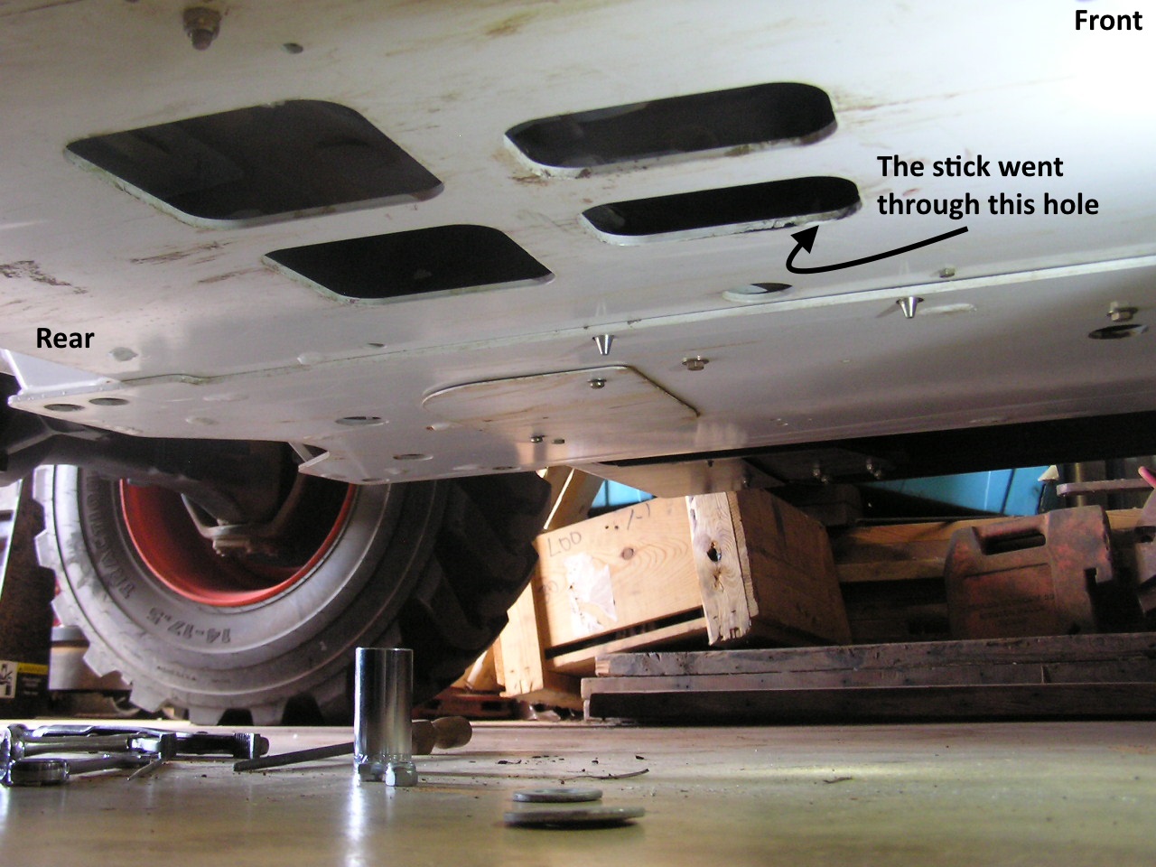

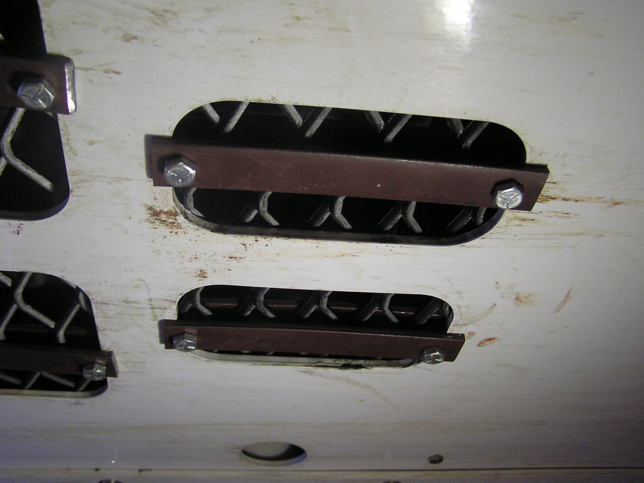

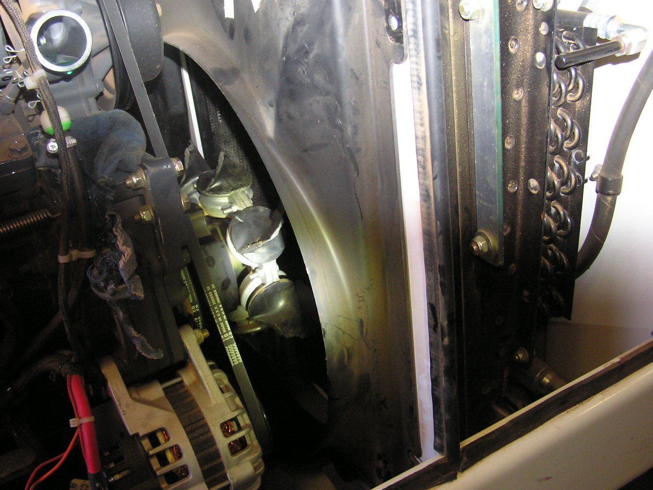

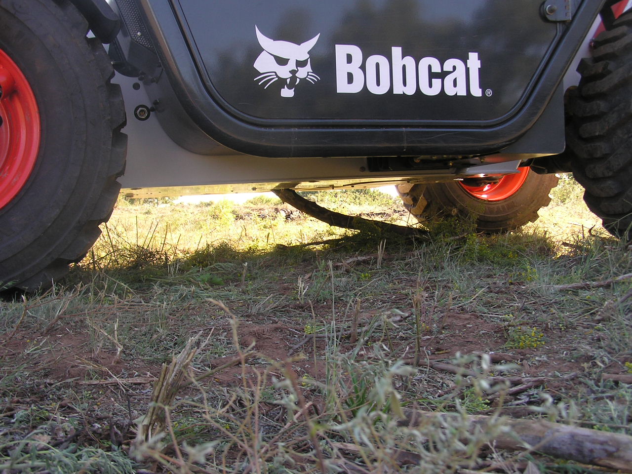

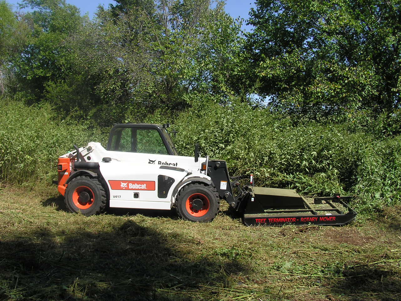

Was brush hogging four years ago, with the V417, backed over a large, long, curved stick. The right rear tire rolled over the stick, causing it to rotate upward, with the end poking through a vent hole underneath.

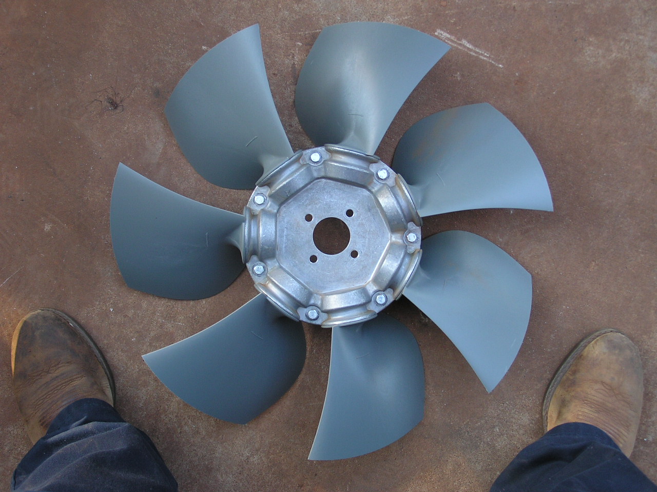

The stick came up on the backside of the engine, right into the plastic fan blades. :eek:

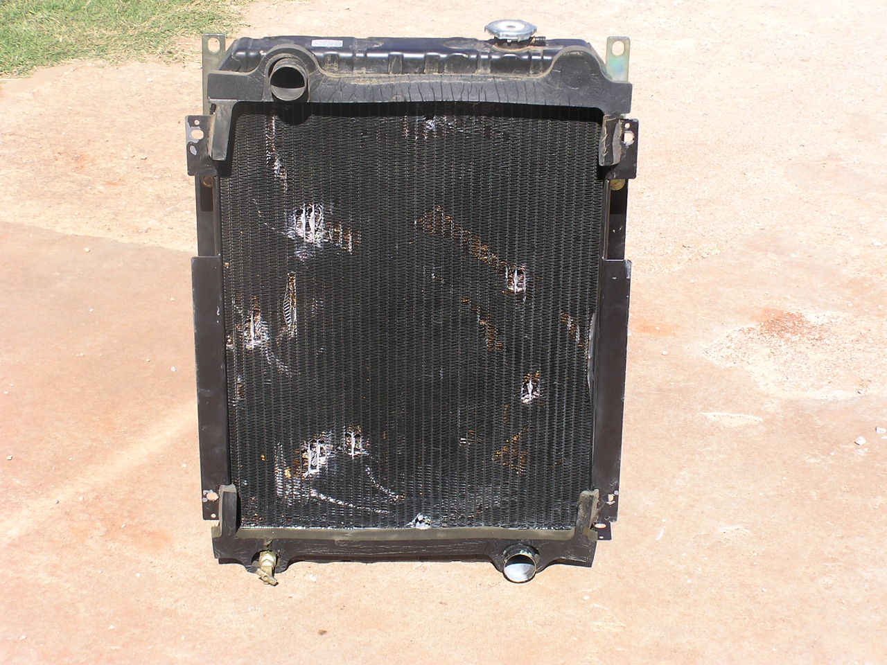

They punctured the radiator in several places. Here it is back from the radiator shop.
It won't happen again!
I bought new blades and reused the hub.
It has over 800 hours on it now, no leaks from the radiator. :thumbsup:
