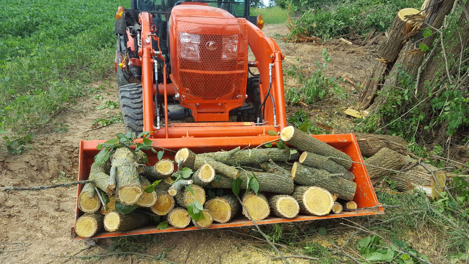

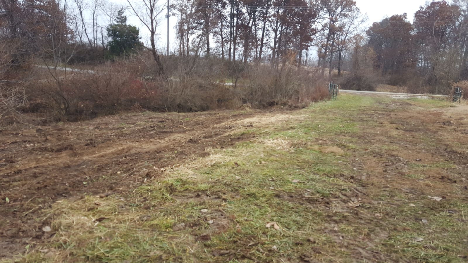

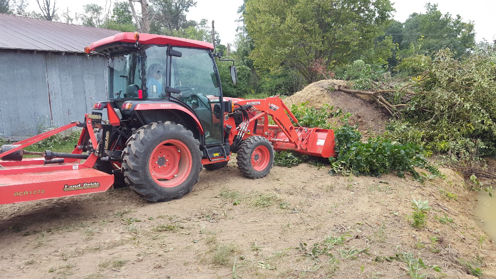

I will toss in the Kubota L3560. Used it dig, move dirt, clear brush, level areas, and mow.
