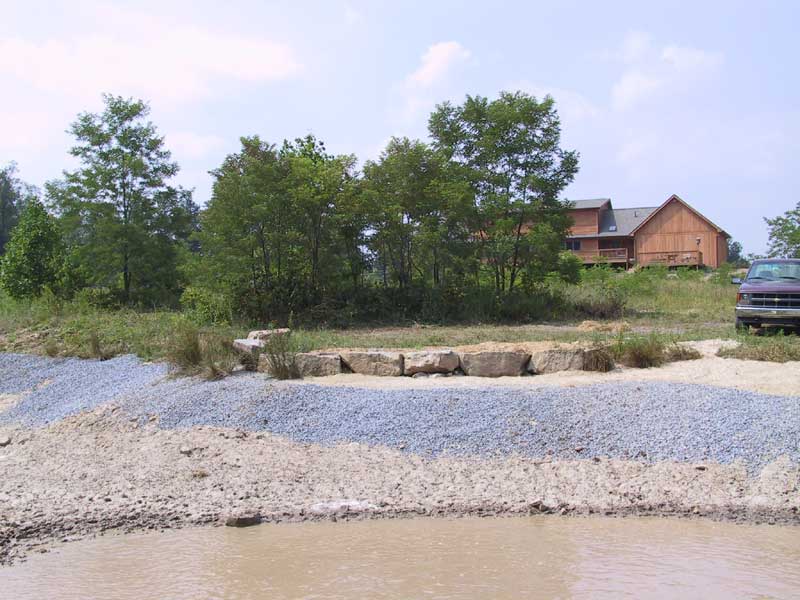

It is said you can dig a pond with a teaspoon. I felt like I was using one the last two summers as I built this pond. It is approximately 180' x 75' (widest point) and is about 10' deep at the deepest point. I needed fill for my house (shown in another pic later). The ground is very heavy clay with rocks out the kazoo. Some are shown in a small wall I built along one portion of the pond.

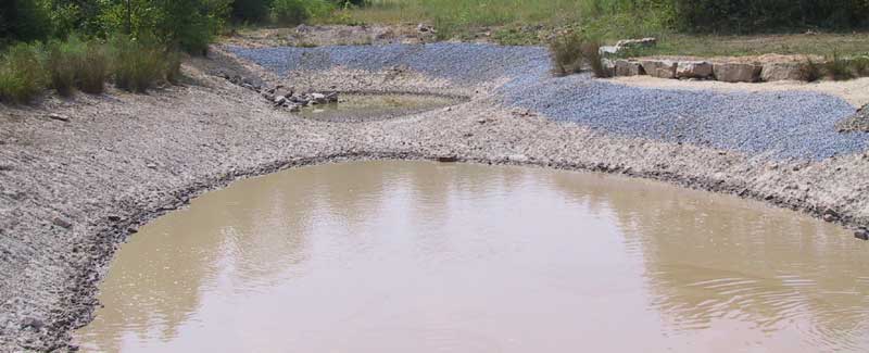

The first pic is the first (larger) hole. I thought I would not need as much fill as I eventually needed so I actually dug two holes for a kidney shaped pond. I used the backhoe to loosen the material and the FEL to remove it.

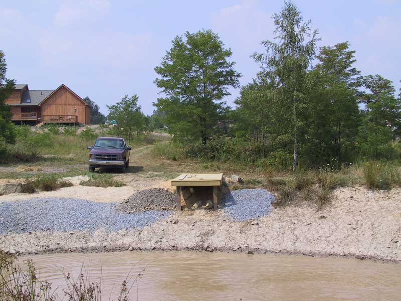

This pic is looking toward the smaller hole. To the right you can see the rock (boulder) wall I made. Positioning the boulders was a lot of fun! There are some smaller rocks deposited into the small hole. My intent was to provide some cover for the new inhabitants of the pond. Also not the gravel lining the banks. I discovered the pond bottom was very muddy and my two dogs really stirred the muck up. The gravel worked wonders in keeping the muddy water at bay.

Looking toward my house and the rock wall 'peninsula'. At the right of the house, you can almost see the fill I deposited.

Last pic for now. Again toward the house but shows the newly completed dock. The fill around the house is more apparent.
I rode the Cub Cadet and its backhoe/FEL pretty hard. It worked like a champ (just one busted hose on the BH) but was really undersized for this project. Next time I hire a big boy to come in and do the job in a couple of days.
I haven't taken a pic of the pond filled yet. When I do, I'll post it.
Dutch
