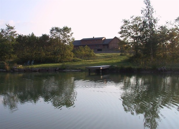

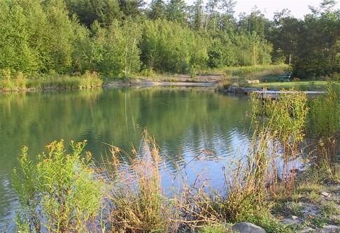

I just took some pictures of the present state of affairs. As I mentioned the water level is down about 12-15 inches due to the leak.

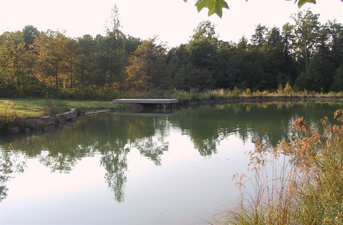

#14
Another. Sorry about the lighting. The sun is in the front right quarter.
