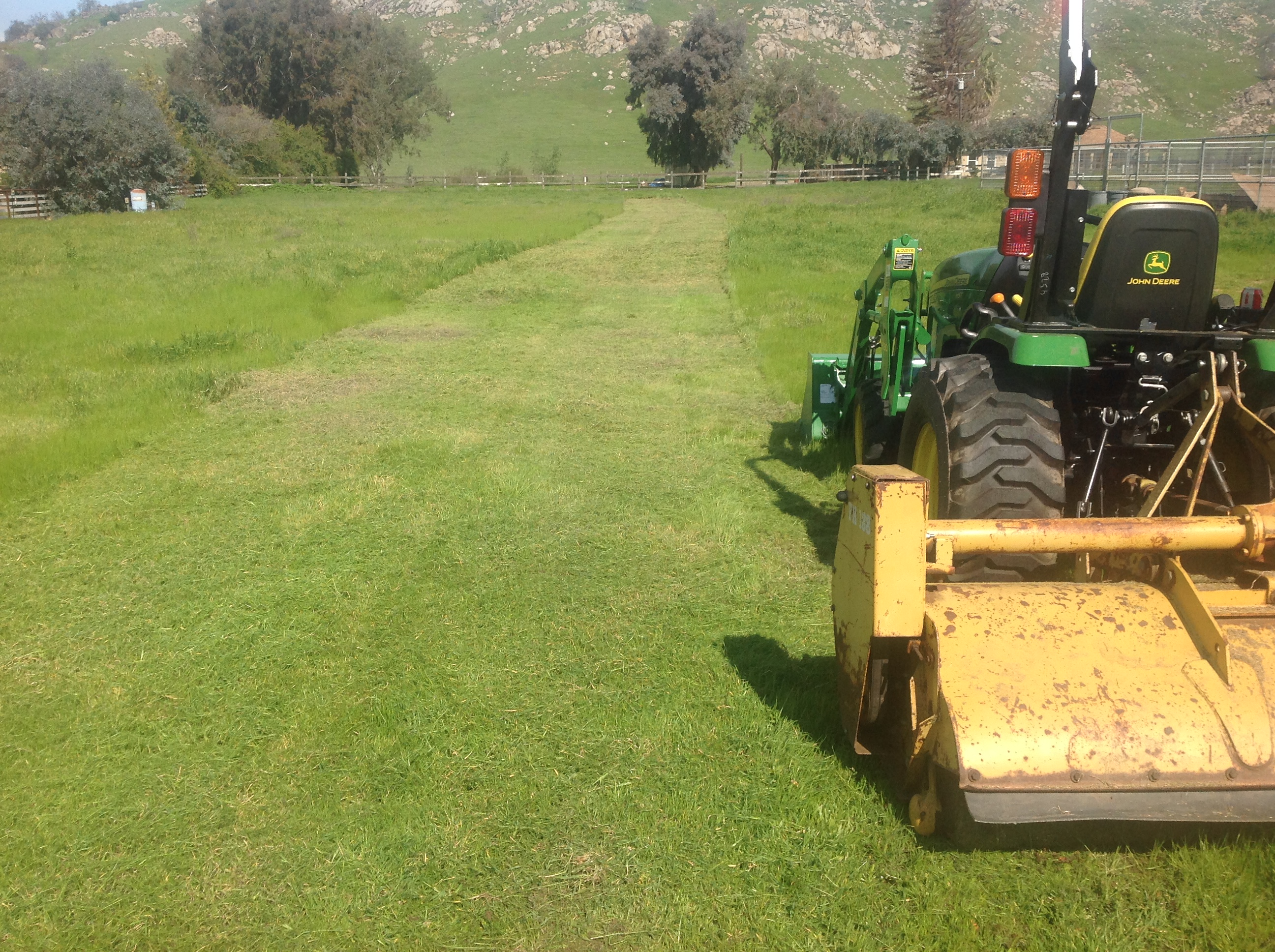

What implement would work best?
I have five acres of weeds that are mostly foxtails, I tried flail mowing them but of course in no time they grow back, the ground squirrels dig up mounds and impedes the progress of flail mowing, I tried my tiller and that is way to slow for five acres. I have no desire to use chemicals.
One advantage to mowing is the ground is intact and easy to drive over with a truck and cuts down on dust, the tiller leaves the dirt flat but way to soft.
So what implement can I use with a 2 series tractor that would be faster, turn the dirt over and somewhat kill the vegetation growth and cut down on the foxtails, My soil is pretty soft, decomposed granite. I live in an area that is agricultural so these weeds would grow to four foot tall if left alone. Spending my life mowing weeds is not my idea of fun.

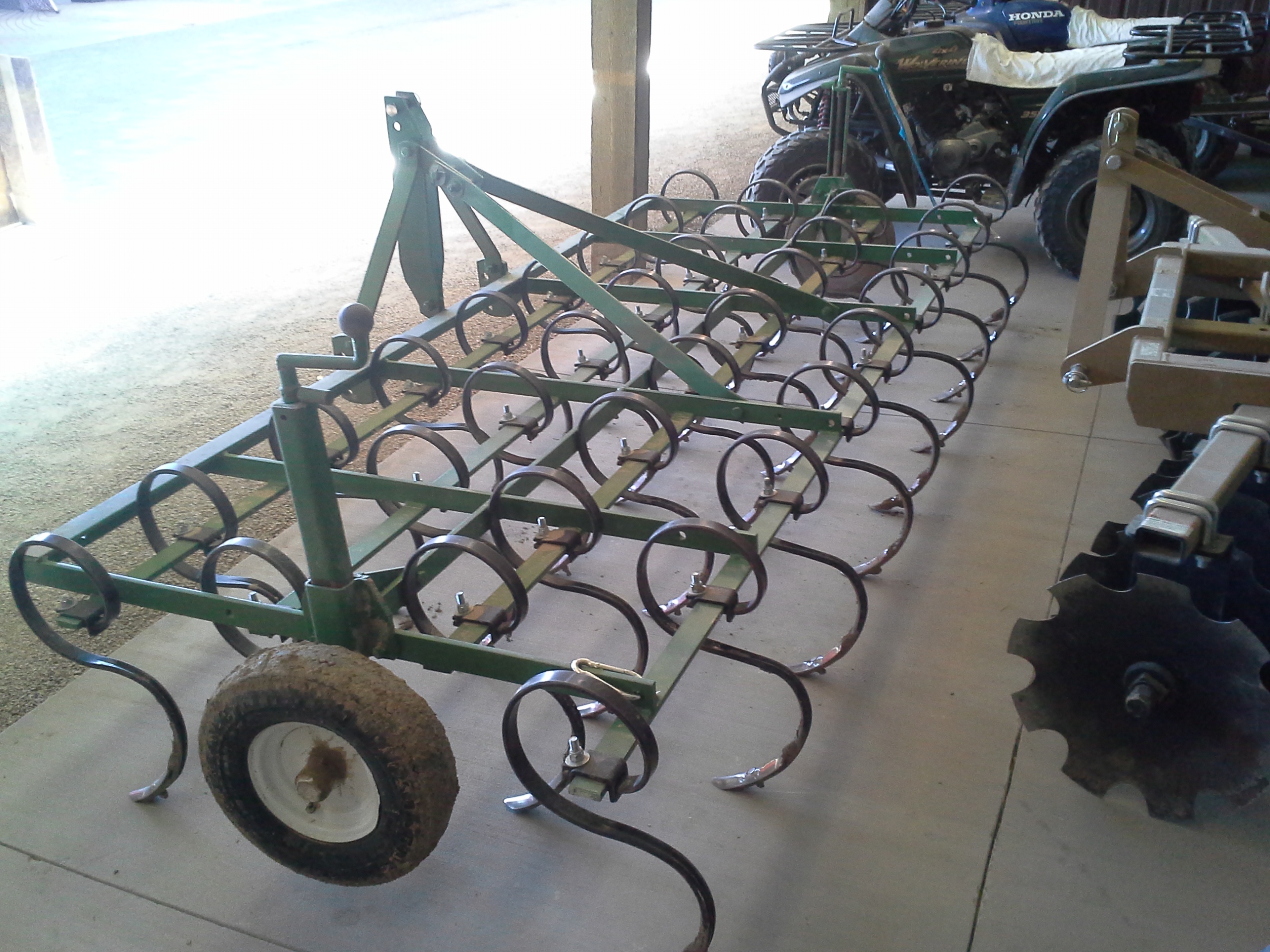

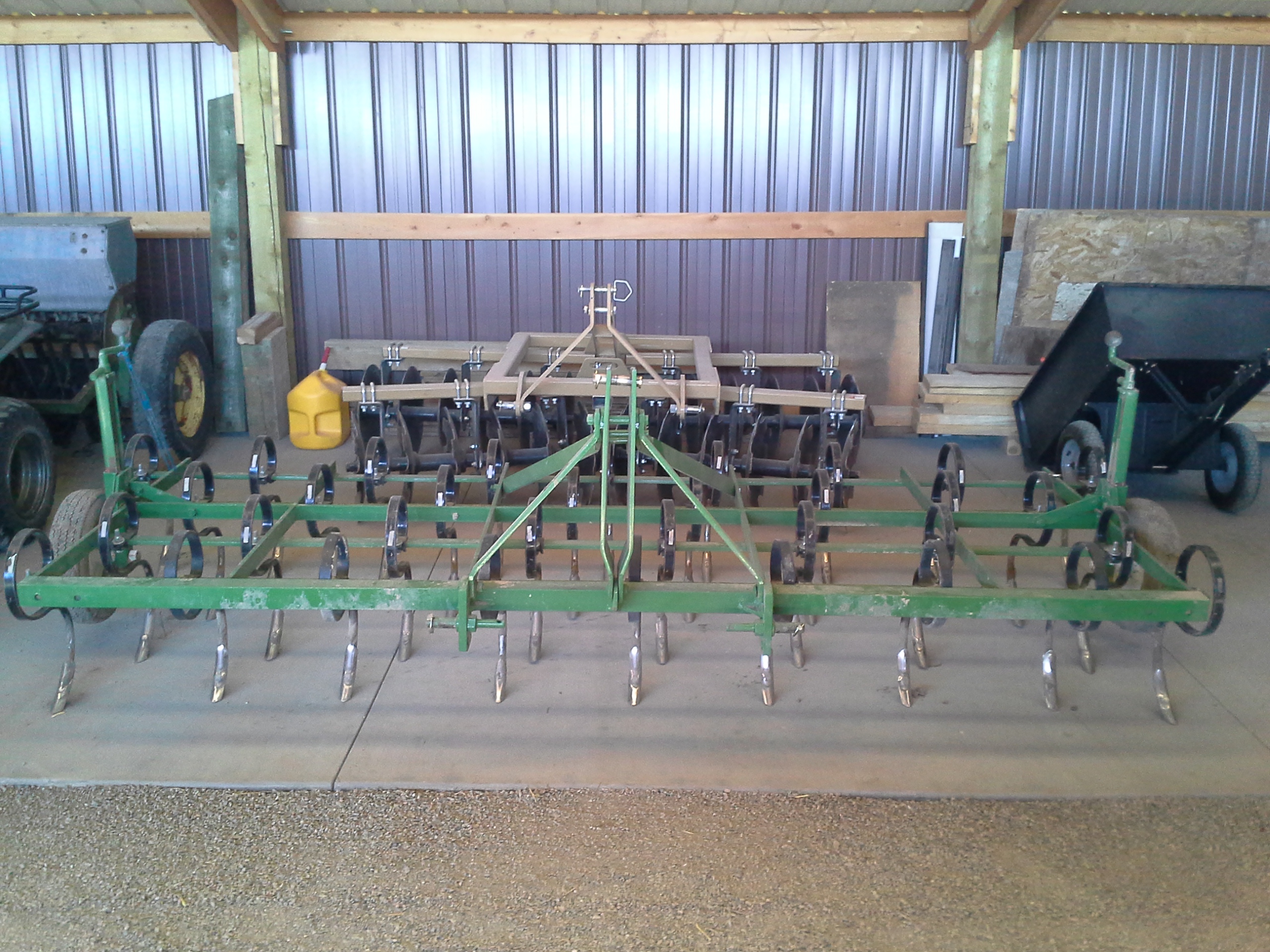

Use a spring tooth harrow and just keep hitting every time it turns green.
View attachment 508711View attachment 508710
Lynn, my dirt is soft but it will harden up some in the summer, will a spring tooth harrow cut through hard dirt or only soft. I see you have a disc in the picture behind the spring tooth harrow, what do you use your disc for.
What kind of finish does a spring tooth harrow leave. How deep does it dig. Does it uproot the weeds and they die.

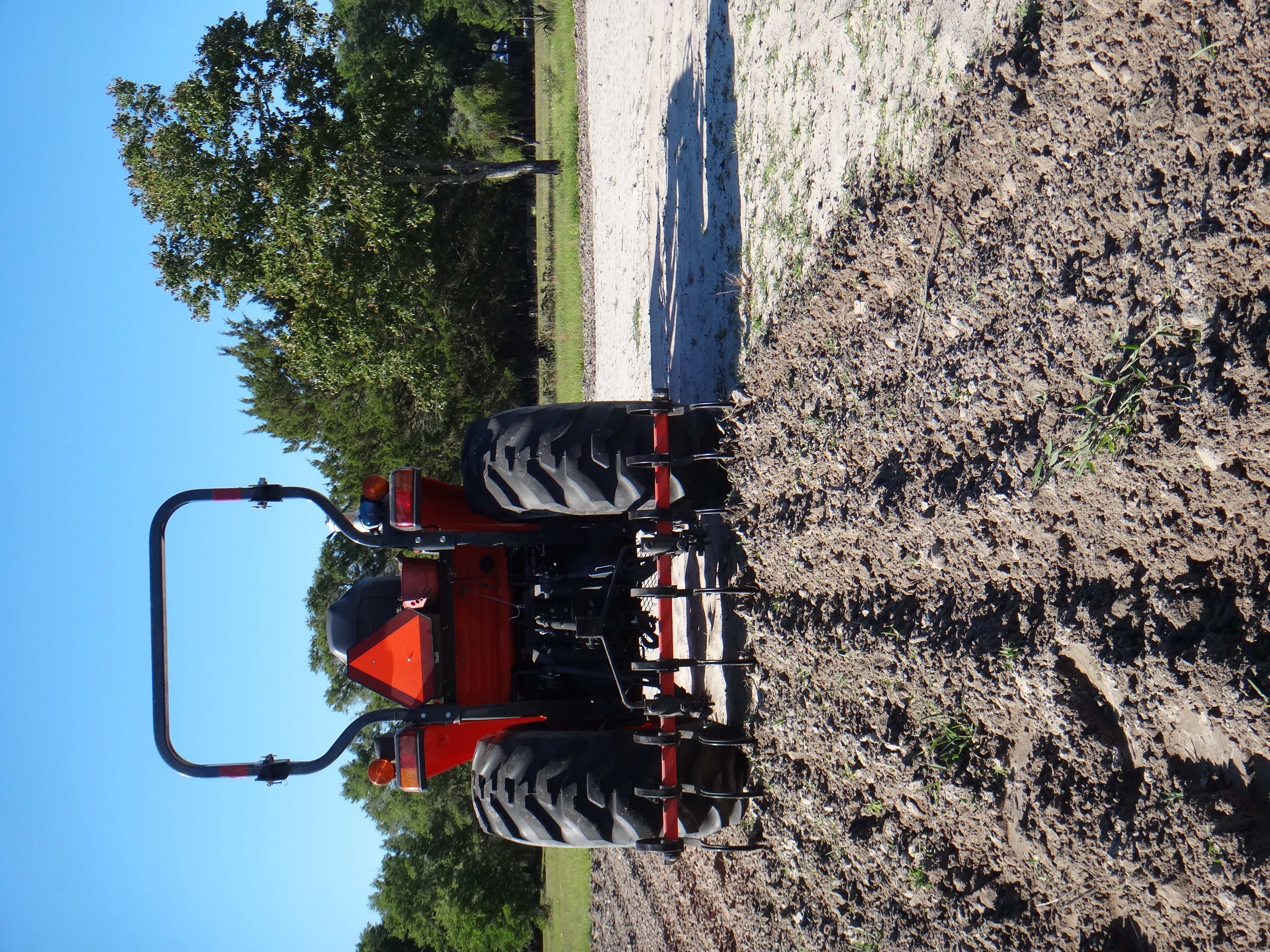

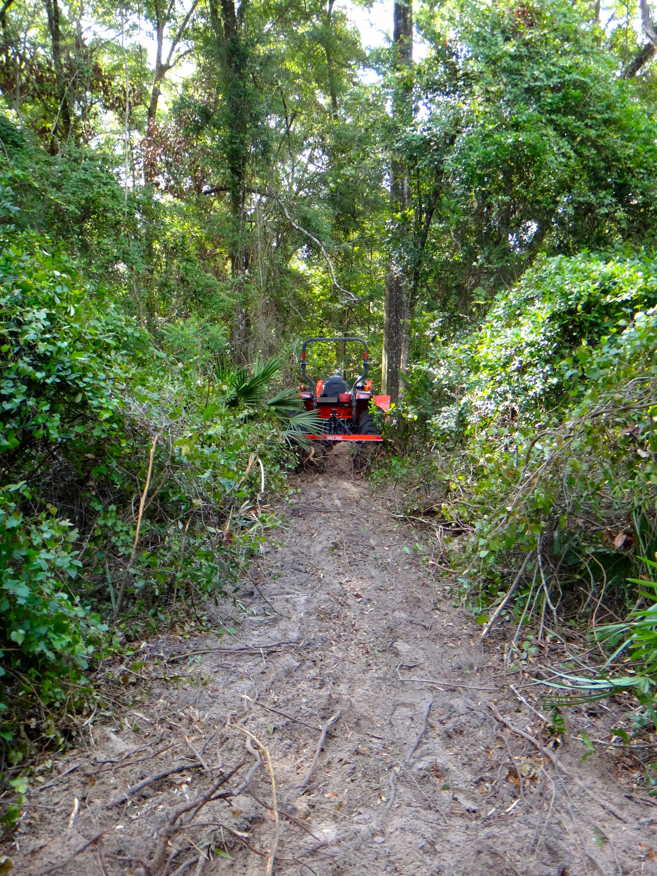

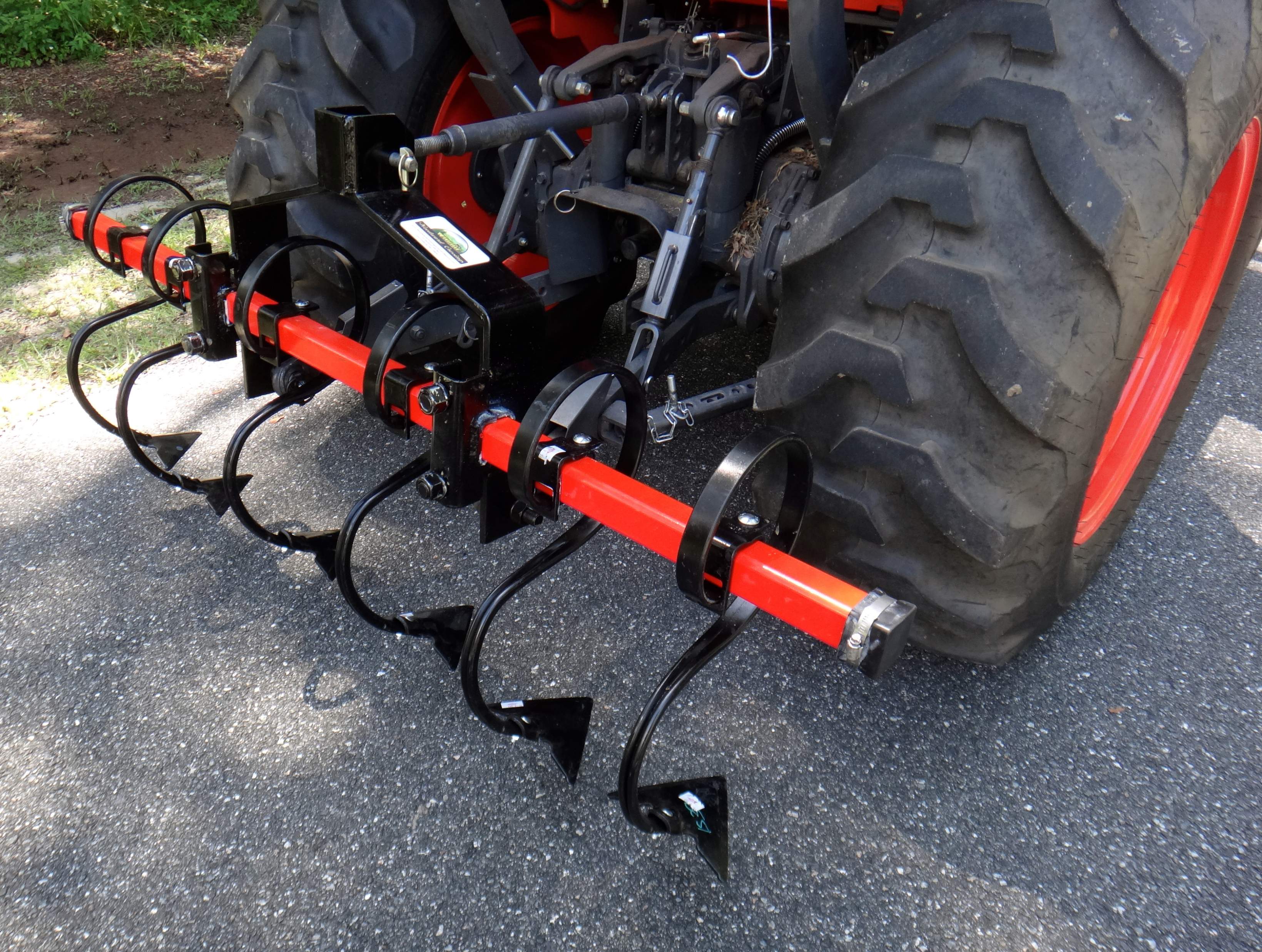

WHAT LENGTH ARE THE ROOTS OF OBJECTIONABLE FOXTAILS IN YOUR SOIL?

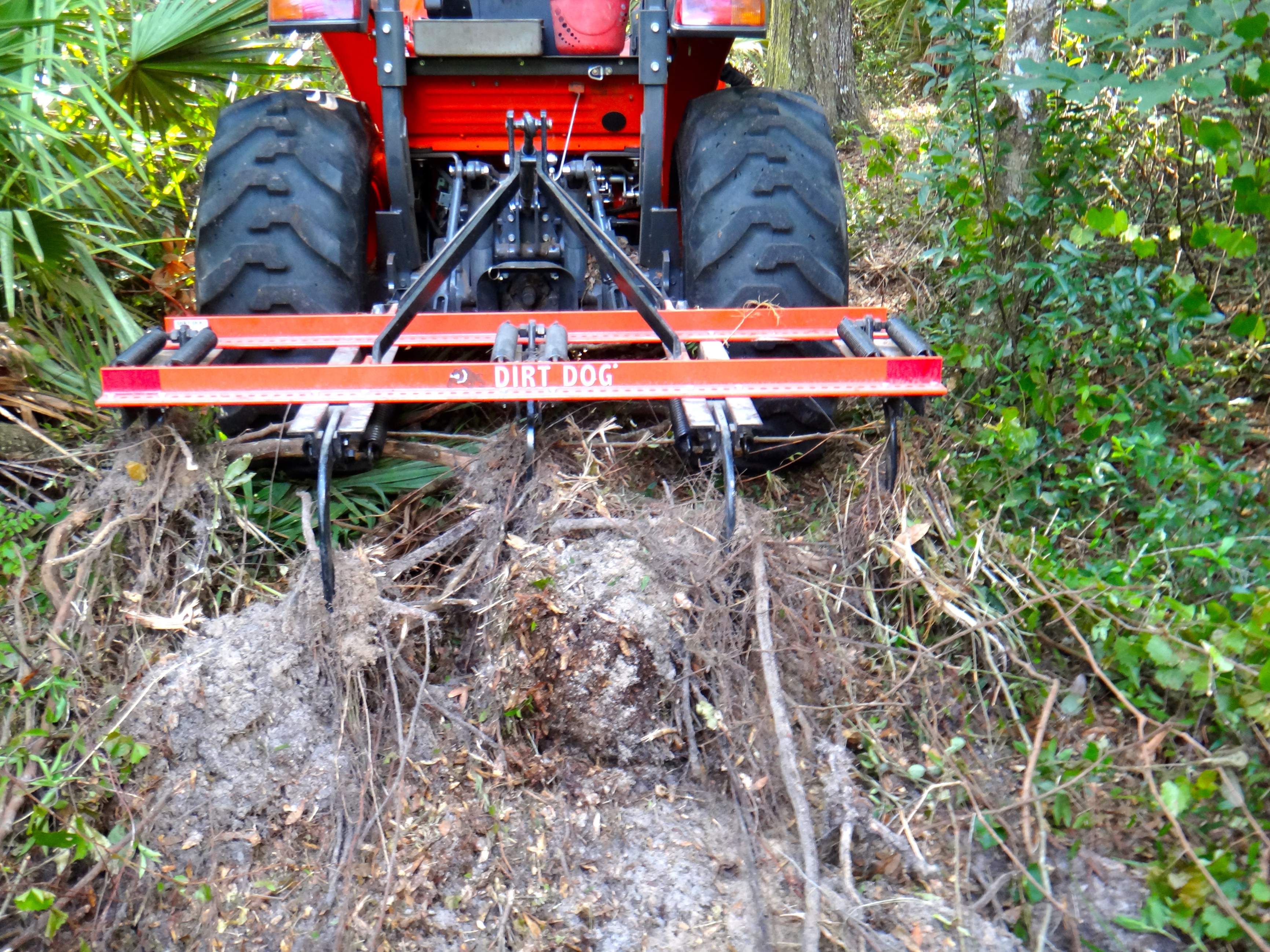

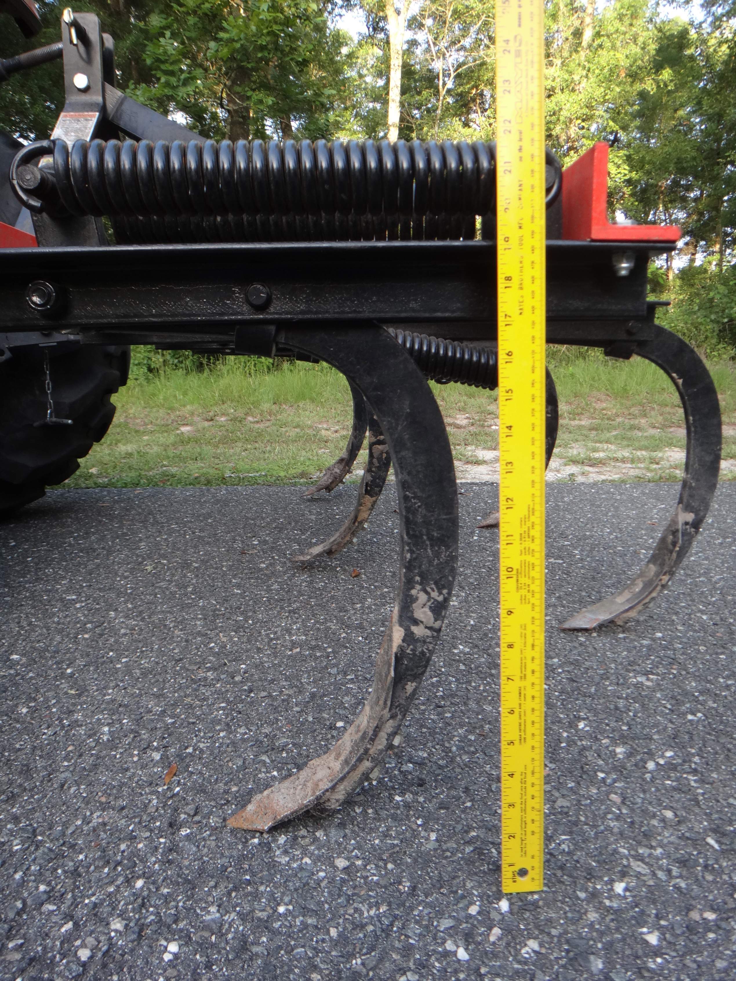

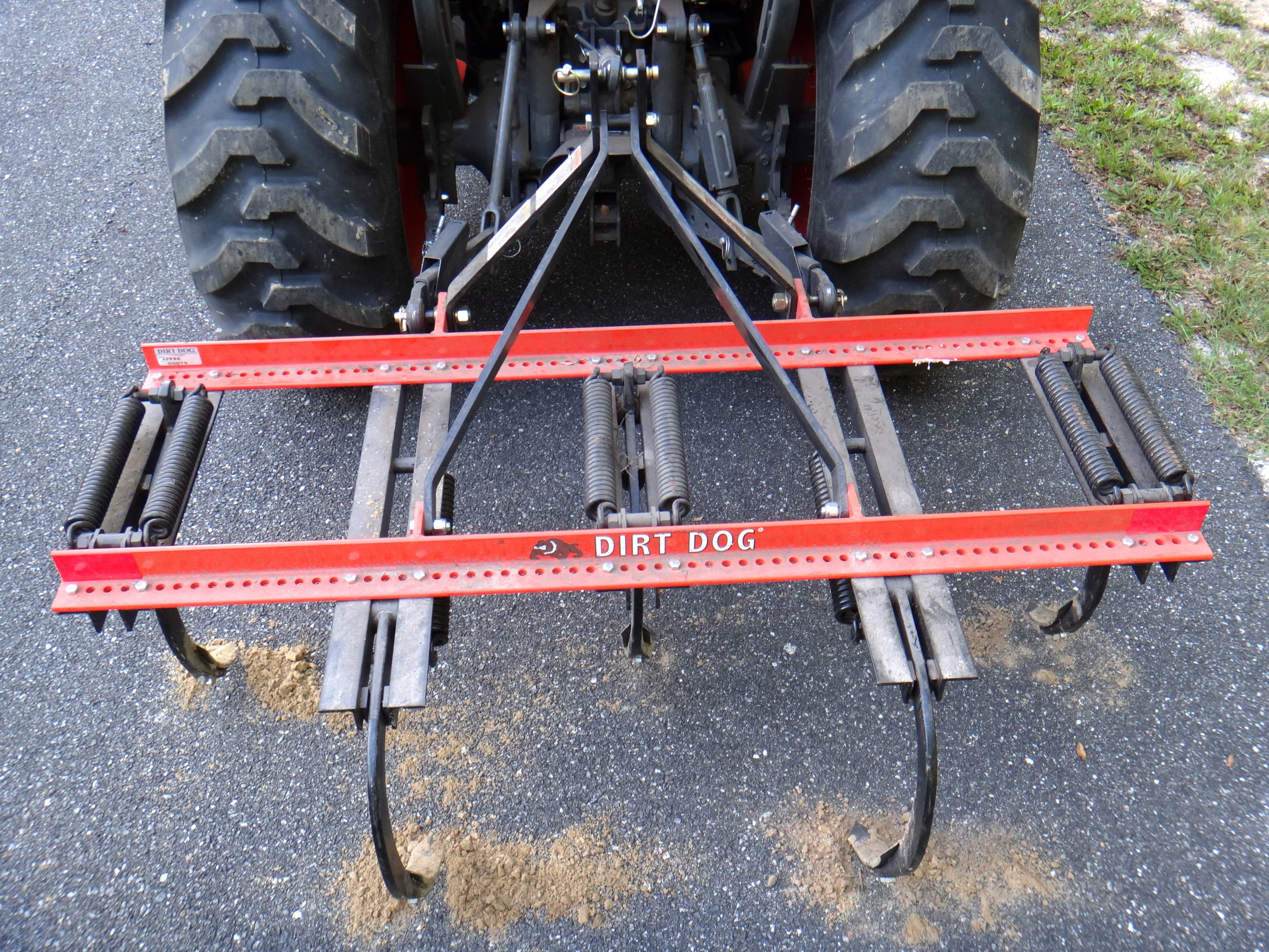

A Field Cultivator will penetrate soil to 14" but I usually rip at 10" depth.
Field Cultivator is a tough implement. Note coil-spring protection for each tine. One of the first implements designed for the Three Point Hitch.
I have a Field Cultivator and a Tool Bar Cultivator, which uses spring tines a bit heavier than CATFEVER'S implement.
A Dirt Dog (brand) Seven Tine Field Cultivator/All Purpose Plow is <$1,000 new, 40% of the cost of a similarly capable Disc Harrow.
Field Cultivator is a type of Conservaton Plow, designed to leave some soil surface undisturbed.
Disc Harrow is a form of tiller, which mixes soil. Most Disc Harrows discussed here mix soil 6" to 8" deep.
