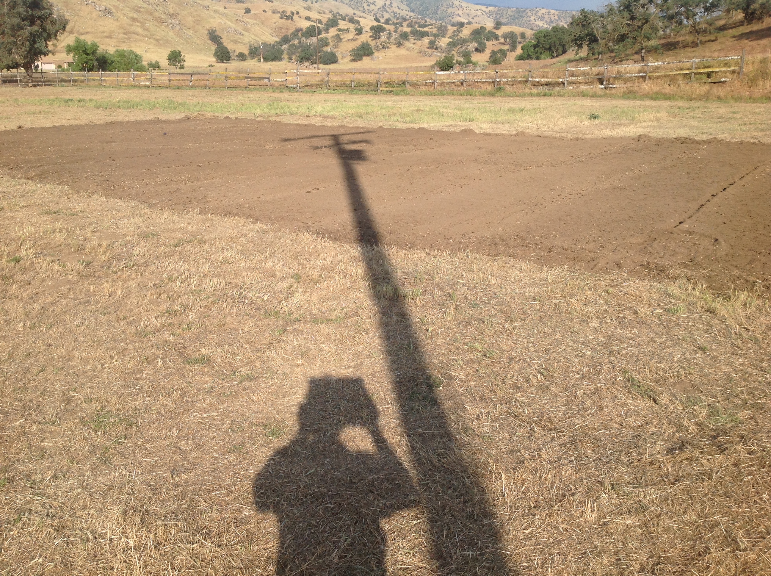

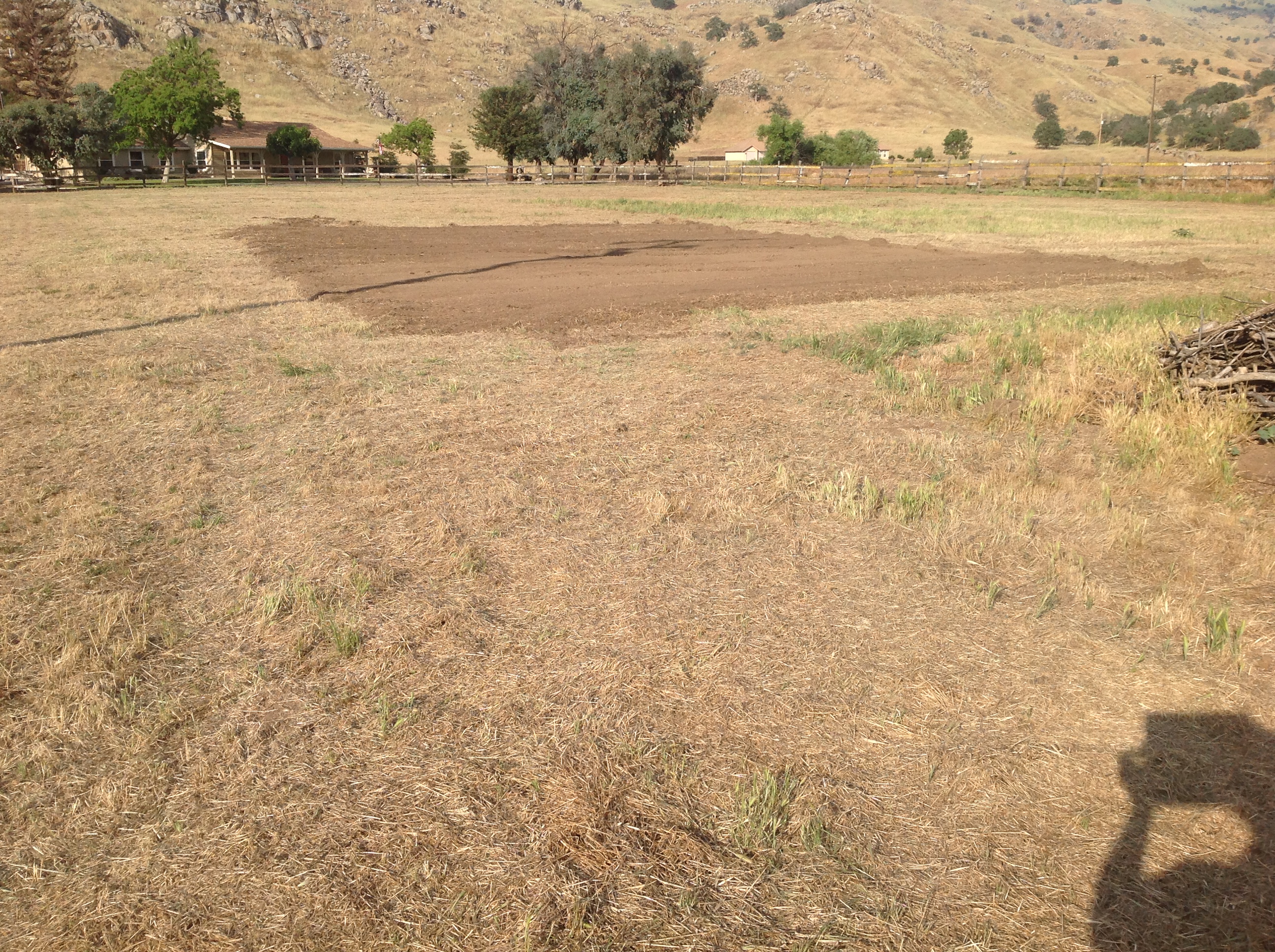

Thanks for all the great ideas so far, one thing that I need to understand is what method kills the weeds, is grinding the weeds and roots up and mixing them under the soil going to kill them or are you just replanting them for next year, are we trying to turn them under before they seed. I used my roto tiller today on a small area with two passes, took a little over an hour and was about 8" deep, it ground all the dead grass into the dirt, is this going to help slow down the growth or is it important to break the ground deep with a field cultivator like others have suggested.
View attachment 508764View attachment 508765
If you want to eradicate the plants growing in your field keep it black with cultivation for the summer. As for the implement whatever works. If a cultivator use one that has the broad shovels. The spike toothed will not do what you want.
Replant grass for a late fall or spring start.

I would run a disc over it first to prep it, then break (plow) it deep and bury the seeds. Some will eventually come back, but they will be thin for a while.
I would plant some bermuta grass and let it choke it out. if you are looking to keep it dirt, I would run a disc over every few weeks.

Would turning the weeds over with a plow have a different affect than tilling or using a cultivator.
