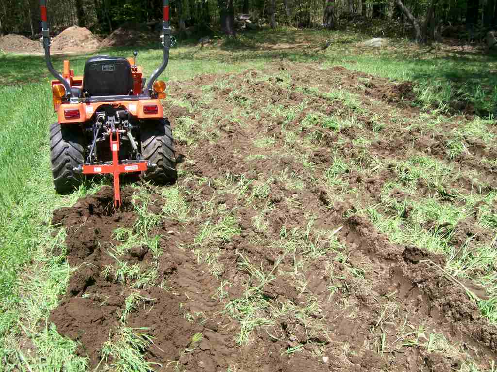

   / What implements should I get for gardening #7

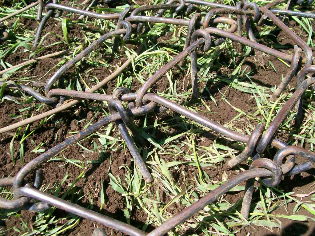

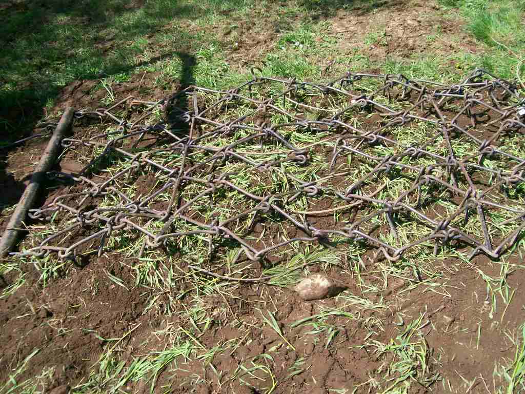

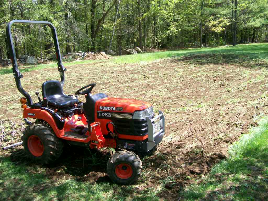

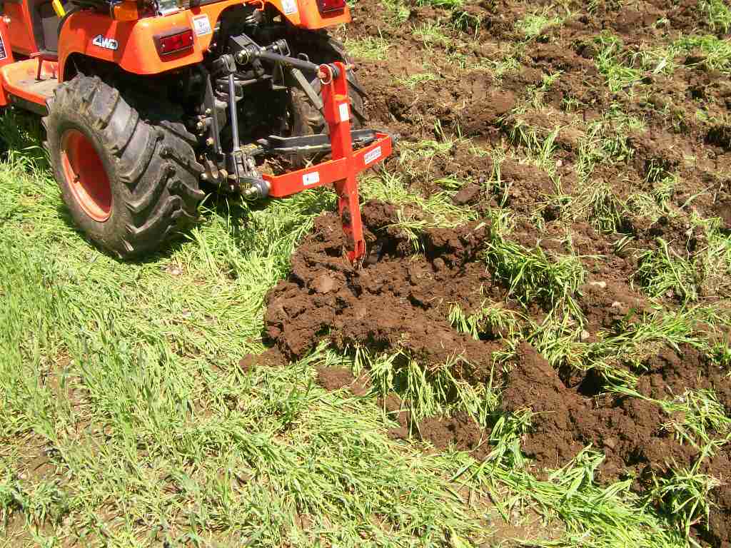

I agree with Botabill that after my gardens get growing my 6hp Troy built walk behind gets more use than anything on a tractor would. I did plow one garden with a middlebuster, and then smooth it with a chain harrow (see pics) but I ended up still tilling it lightly with my walkbehind for the shallow seedbed needed. I was a bit surprised about how good a job the chain harrow did smoothing out the rough furrows. By the way, that was some winter rye that I was tilling under.

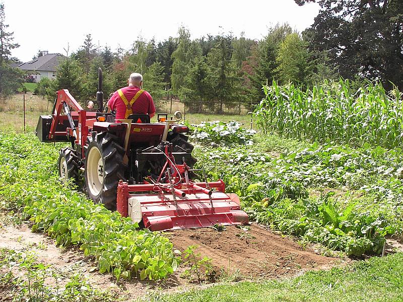

Don't know much about local conditions in your part of the world but here is what I'd suggest given your budget.
As others have suggested, a 3pt tiller is hard to beat for typ home sized gardens. As for wrapping things around the tiller, It's not been a big issue for me and my 3pt tiller. Grow a green crop during the winter months and needing worked in in the spring, one can always hit the crop with a mower first then till it under.
With your budget, I'd suggest looking for a used 3pt tiller and one that is either wide enough or is offset to at least cover one rear wheel's foot print. I think you should be able to find a decent used model is good condition in the $400-$600 range. With the extra bucks look for a walk behind tiller to cultivate between the rows during growing season.
I have a total of 4 tillers of different size and 3 get used on the garden yearly.
Here are a couple pics of the larger tiller turning under crops at the end of the season. It gets worked in and no wrapping of the crop.
