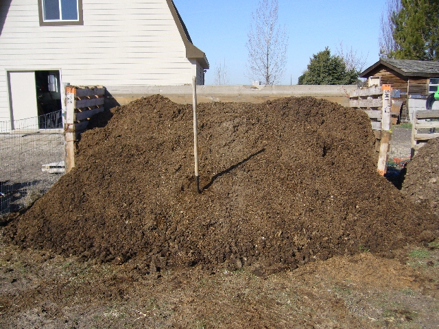

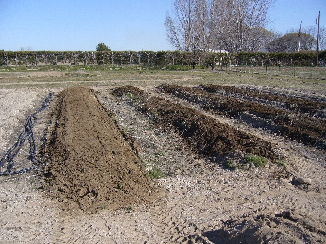

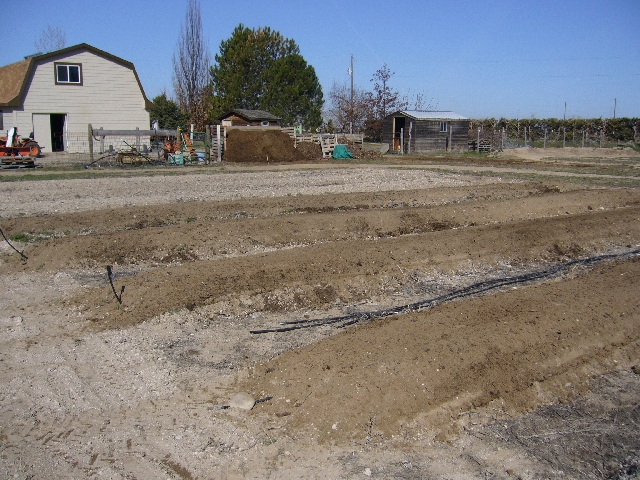

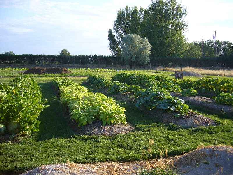

Here are a few pics.
We flood irrigate here, I get water for 12 hours every 8 days. I have a good sized pond that I pump from but irrigate the fields, including the gardens, when its my turn for water.
I use 'drive on' raised beds to keep the veggies out of the water when flooded, the rest of the time they get watered by drip.
Back in March, tilling the raised beds and a shot of the composted horse manure I get from a local stable.
What it looks like today, I planted grass between the beds to keep the weeds down and eventually provide mulch for plants.

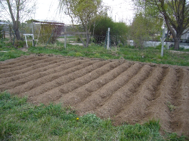

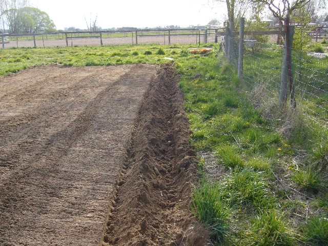

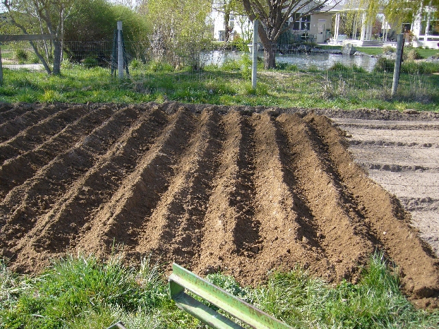

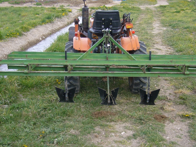

Here are some shots of laying in a head ditch with the middle buster and then the 'corrugator' and using it the to lay out rows. I have decided that I don't like the narrow rows as the flood water breaks them down pretty fast so now I omit the middle plow and lay out rows the same width as my tires.
Little bit of rake work to provide a good planting surface between the last two pics.

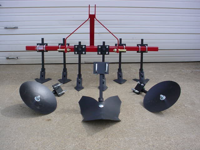

In the meantime, I am keeping my eye out for a used 3ph tiller but one thing that CHARLZ mentioned has sparked my curiosity. I've attached a photo of a toolbar I have seen, is this something like you are speaking of ? Anyone have any experience with this ? If you have a photo of one you own that you really like, a photo would really help. I'd rather buy something that's already proven it's worth by someone else rather than trial & error by me. My Thanks.
