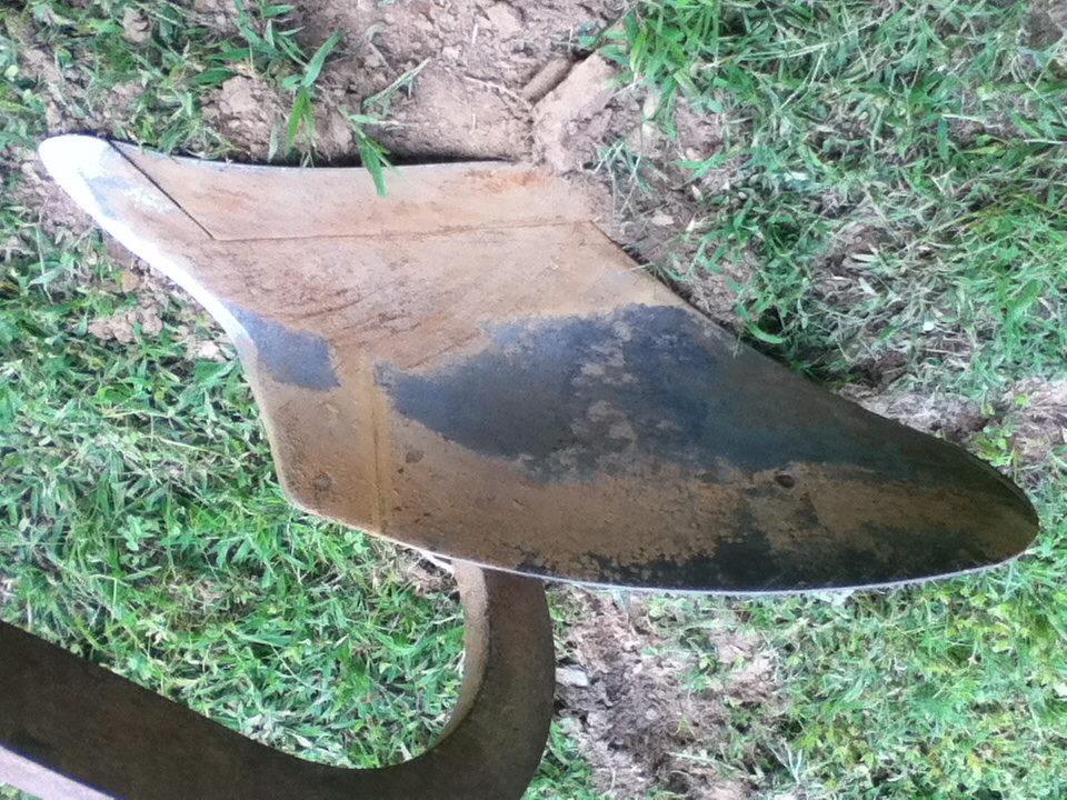

As far as the plow not going in the ground this time of the year, but it worked OK in the Spring and you have it set up exactly the same, it can only be one of two things (or both): 1. The soil is very dry or 2. the plow share(s) are dull/worn out.

My research indicates that the plow share needs to be sharpened and we need some rains and the plow will suck in just as it should. Serious about a garden, I will grow something until I can no longer get out of the house, but my disability is slowing me down a lot faster than I want. I grew up in the country, born in NW Indiana in corn country we raised a garden all of my young life. My adult life took me to larger cities where work was plentiful and my neighbors could hear and smell my gas. I was fortunate enough to return to country life with my second young family and have been loving every minute of my life. My family has grown and moved on my disability has been kicking my but the last 3 years. Thanks to all who are helping me with this decision.

Plow rides on top because it is wore out needs new share to cut and possibly point share too. Now if I can find a source for plowshare parts.
