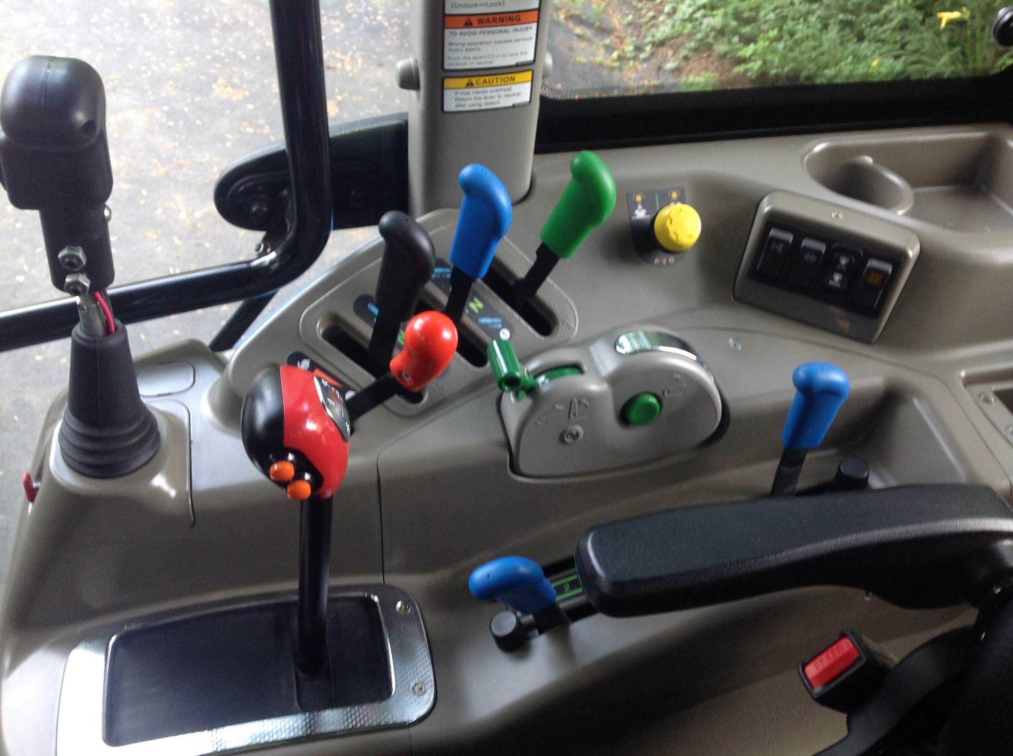

Here's a picture of inside the cab and you can see where the module would go. You would lose the three point and draft levers and they would be set with dials. The little green lever and button is a great feature that raises the three point with the lever and a push of the button lowers it to your set levels.

On your LS tractor, I have a few questions. When did you buy it. How many hours are on it. Would you buy it all over again if the one you have was destroyed? Please explain the transmission, can you just put it in gear without using the clutch? Can you shift up or down in gear with no clutch? I appreciate your input, thanks.
   / What is a good modern chore tractor for 40K or less? #18

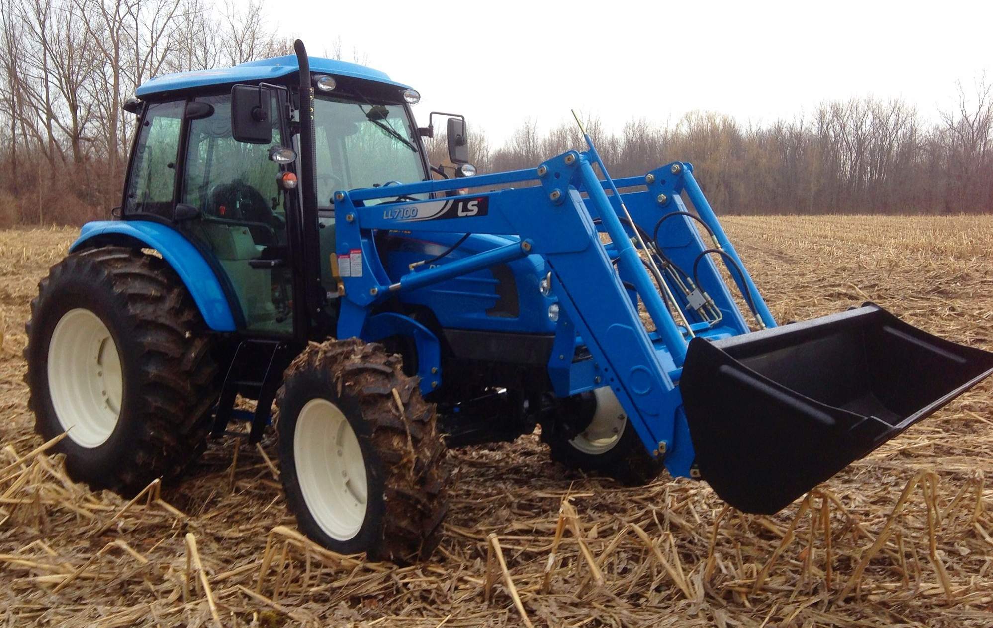

I bought it this spring and it has about 100 hrs on it. I hope it doesn't get destroyed, that would mean I would be DEAD because I don't let anyone else drive it but if I lived, yes I would get another.
You need to use the clutch when you shift the L,M,H lever (located on the floor left of the seat) or the 4 speed. (red handle in my previous post's picture).
You do Not use the clutch when going from forward to reverse or using the hi/lo feature on the aforementioned 4 speed shifter. (Two buttons on the side) This tractor will NOT let you ride the clutch. After 6 seconds a loud warning buzzer will go off (which is mentioned NOWHERE in the manual) and if you don't let up immediately it will put itself into neutral. A little unnerving if your trying to back up a hill to pick up an implement some moronic dealer leaves at the steepest part of the driveway....
This tractor has plenty of grunt so I seldom use low range other than hooking up implements. High range would be good for fleeing the police or road travel in general so medium is usually where that selector sits.
If I'm doing loader work I hardly ever use the clutch, I use the neutral to stop.
When I am choosing a gear to plow in for instance, I will Select it with the hi/lo in the hi position. That way if it starts to bog down a little, I just let up a little on the gas and hit the low button and she keeps on going. Same with mowing.
Good luck in your search!
