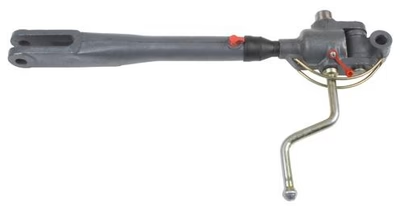

/ What is a leveling box? #4
It is used for the "adjustable" side of the 3 point lift arm linkage. This allows you to tilt an implement.
Thanks LS Tractor, I didn't know what that was and didn't understand Willy's description either. Now I realize it's a "manual" hydraulic link. Good to know, although I'll never need one.
/ What is a leveling box? #5
It also helps when you are trying to connect an implement to the 3 pt. system.

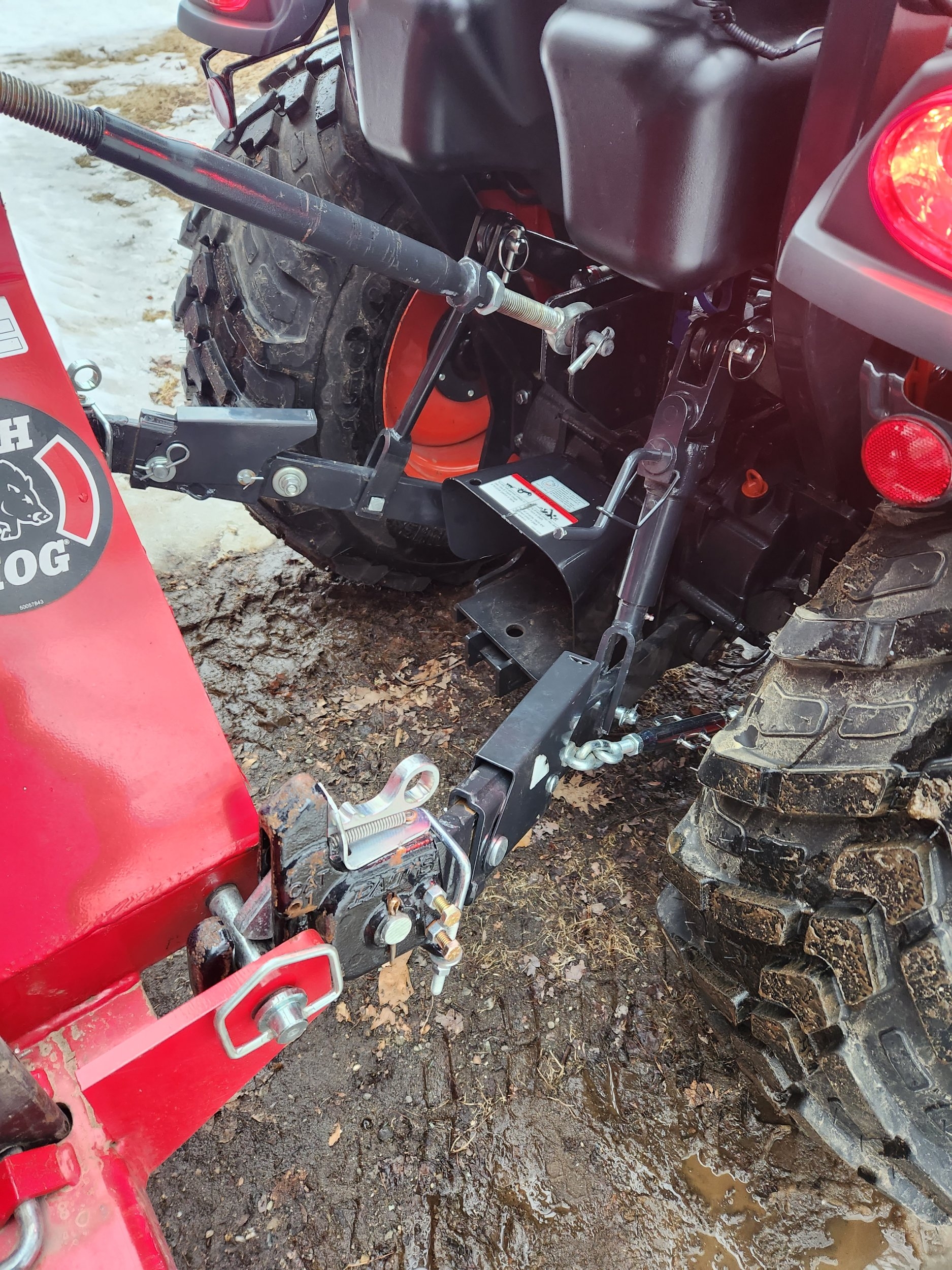

/ What is a leveling box? #6
It's a lot better than the damnable turnbuckles the machines tend to come with, and cheaper than a hydraulic tilt.

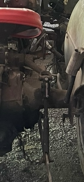

/ What is a leveling box? #7
This is the most refined form of the original on a 1951 Ford 8n. It was first invented by Harry Ferguson and offered to the public, in partnership with Henry Ford on the Ford model 9n, in 1939:
