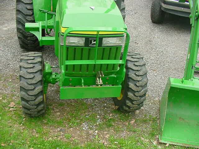

</font><font color="blue" class="small">( Thank you for the info. I'm getting the FEL so I may not ever need any front weights but was curious. Is the weight bracket and the brush guard the same thing? )</font>
On the Deere 790, the weight bracket is incorporated in the grill guard as shown in the attached picture. one must remove the loader safety latch (bronze colored component in the picture) and install the pin that holds the suitcase weights.
I don't have any suitcase weights yet. I really don't have any dire need for them, but I wish I could find a set of used ones. They would be handy on occasion, but not at the price Deere wants for new ones.
