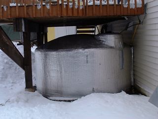

I'm looki ng at buying a house that will likely be on well & Septic, and have been advised to make the offer to purchase conditional on a "well flow test". I did so, and guess I'm glad I did as the first vendors refused to permit the test to be done! But now, they are having their own test done and say they will share the results with me. This apparently is in a subdivision where there are known areas of good water volume and other pockets where water supply is a known problem.
My question I guess is, if they do have a flow test result to share, what is an "acceptable" flow rate? I am just one person but when I sell the house in 2-4 years' time, I don't want water availability to be a problem for the purchaser(s), especially if it's to a family of say 3 or 4 or 5 people.

Not sure how it is where you are, but here there are requirements on minimum flow...generally 1 gpm in order for the property to be legally sold. Your realtor or local permits office/health department should be able to advise you on specifics.

Out here I believe we need to have a 2 gpm flow rate minimum. With that low of a flow rate, folks would typically put in a submerged tank that can fill day or night from the submersible well pump and hold 1500 to 3000 gallons with a second pump in the tank to then supply and charge the domestic water. That pump does not have to be substantial because it only needs to charge the system to 60 PSI plus any rise to the house. The big benefit is with several thousand gallons, you have plenty of reserve for almost any situation. The well pump only needs to have enough pressure to lift water into the tank and not to the house with the additional charge pressure.

When getting a subdivision permitted here in New York the NYS Health Dept. typically requires a minimum of 5 gpm yield from wells to serve a single family home. Sometimes for wells with yield between 2 and 3 gpm you can over size the hydropneumatic tank to help maintain pressure and flow through out the residence. personally I would find a well with less than 5 gpm highly undesirable.

Thanks so far for all the comments! Sounds lioke 2-5 gpm would suffice. I neglected to mention that there is an 11,000 gallon cistern located under the rear deck of the house. (see attachment). That alone should have told me there is a water supply issue! I will advise further as I find out more.

I believe that might be a 1000 gallon tank.. A 11,000 gallon tank would be much larger....... extremely much larger... and bigger than that...... /forums/images/graemlins/grin.gif /forums/images/graemlins/grin.gif
Gallons : 10500
Diameter x Height : 142" x 168"
Weight : 2500 lbs
web page
While poking around the site of the tank company, I came across this web page that might just be what you are looking for. After reading about the product, it seems that it will take care of the low producing well, but I don't know at what the $$$$$$ cost will be.. Junk...
   / What is Acceptable Flow Rate? #10
In fact, just to give you an idea, a double tanker gas truck carries about 4000 gallons in each tank for a total of 8000 gallons. 1000 gallons for that size would seem about right.

When my well was drilled my guy mentioned if it was 3gpm or less that I'd need to have a holding tank as they have under the deck. He said you can live this way but you couldn't water the lawn, take a shower and run the wash all at the same time. So common sense prevails I suppose.
