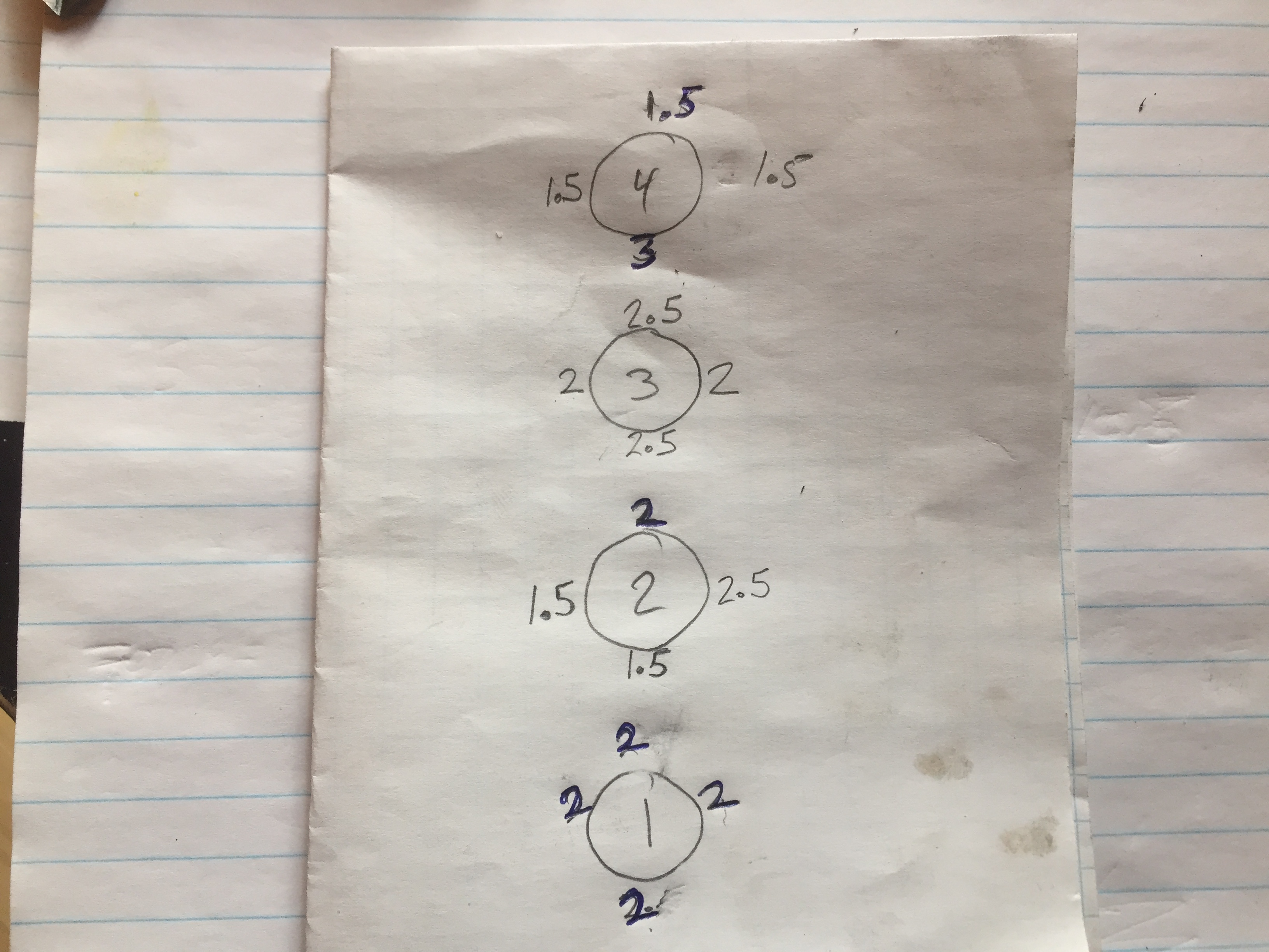

These are the protrusion measurements. I didnt bolt them down - just tapped them down to make sure seated fully. Used a dial indicator and measured each place several times. My dial is 100 thou range so not ideal - .5 thou is best I can read off it. Nothing alarming here though. I would think a gasket could make up 1.5 thou difference?

you have 3 thousands on #4, though.. how thick is the gasket?.. also, the cylinder liners are NOT even!.. they should all read the same..

Still waiting to hear the thickness of the fire ring. To me #4 looks bad. Don't think shims are going to help that. I think you will have to have the block decked. Please review that video I posted.
Yes, I watched that video and dozens more of that guy痴 over a year ago when contemplating the rebuild. This machine has been broken for almost three years now. I fully understand the concept. I have read different tolerances for other engines but have seen none for Yangdong. For example, there is a marine Perkins similar size that says individual liner must be within 1 thou, no two cylinders can稚 be more that 2 thou different and a range of 7 thou. In that example, the head gasket is very forgiving. Others are much more specific and tighter tolerance.
The deck is dead flat. The counter bores will have to be machined and then liners shimmed to get all these measuring the same. Every time I learn something about this machine it makes me sad. Lol
The fire rings are about 60 thou IT did crush all the way around but clearly not uniformly

After the last post, I rigged something to press down on the liners uniformly and bought a better dial gauge. The protrusion measures showed the problem. The cylinder bores were not perpendicular to the deck. All of the liners were tipped so the front edge was higher than the back by 1.5 thou. Protrusion was lower than spec on 1,2,4. 3 was higher than the rest because the counter bore was wrong.
We cut the counter bores to a uniform depth perpendicular to the cylinder bores. Then shaved the deck perpendicular to the bores so that it produced 5 thou protrusion on all liners.
