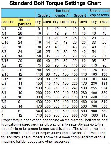

Hello, Had to get the tire / innertube replaced in town and now I'm trying to re install wheel onto hub but cant find the tighten specs for it. Thinking no more than 80 foot pounds. Your thoughts, Dave
   / What is Farmall 504 front wheel bolt torque specs #2
When in doubt, I use a standard bolt torque chart.
   / What is Farmall 504 front wheel bolt torque specs #3
Unless I'm seriously mistaken - torque specs are most always "standard".
Want more torque - go to a different grade bolt or fine/coarse threads or a heavier bolt. There are also bolts made from different materials.
No qualified engineer is going to request more torque than a bolt can handle.
