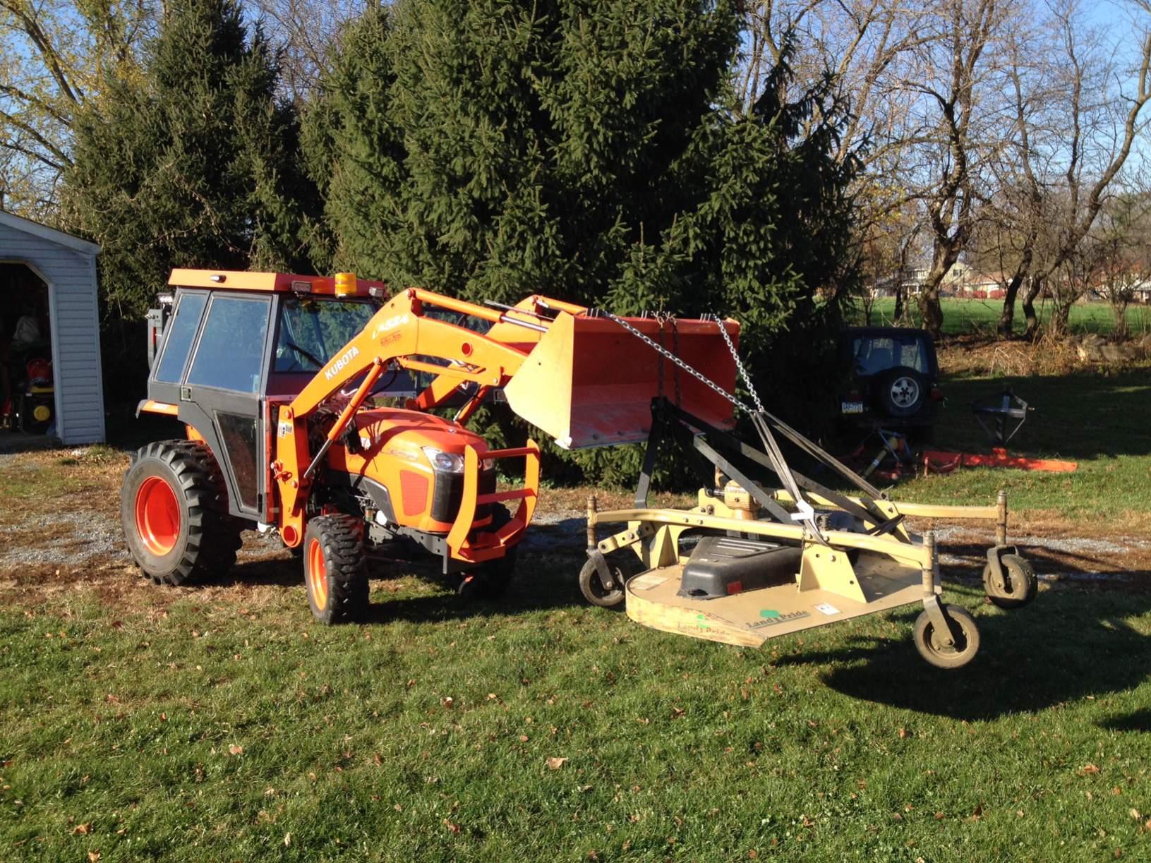

There are exceptions (when I'm using a 3-point scraper, landscape rake, etc). But mostly there is one implement per season connected to the 3PH. In warm weather I use a 6' LandPride RFM. In cold weather I use a rear mounted snowblower. Sometimes - nothing, as in the picture below. That deck weighs in at 619# according to the manual and it's hanging way out beyond the bucket. That's about max without something on the tail. I wouldn't drive down or across a steep slope with that setup.
Removing a perfectly good counterweight (implement) to replace it with a ballast box, then removing the ballast box to put the finish mower back on doesn't appeal to me.
