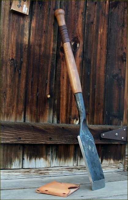

Most slicks are off set like this.
I am sticking with framing chisel. You can put different handles on them.
There is a stamp on your chisel, can you read anything on it. or is the name of the chisel stamped on the other side?
Can you take a picture of your chisel sideways?

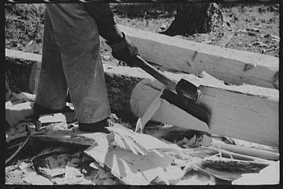

The Broad Axe has one side flat for facing logs and comes in different sizes see attached. My father use to call that hatchet head style a Swedish Axe, go figure, and I am sticking with the timber framing chisel, ;)

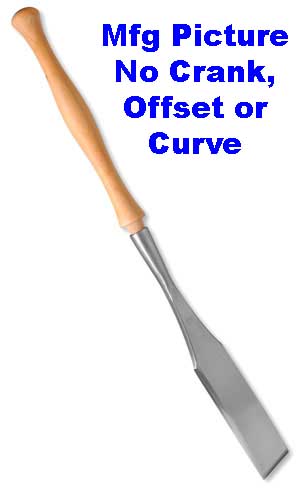

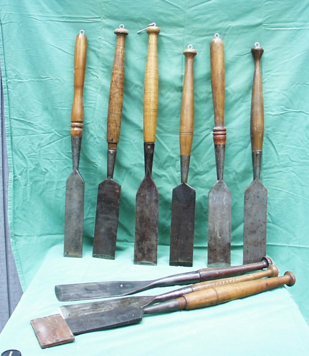

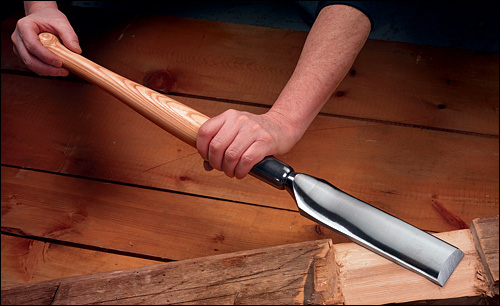

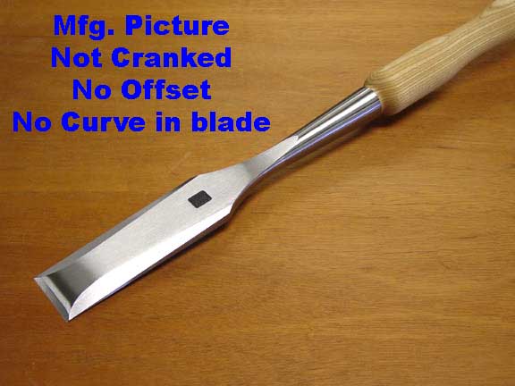

A "Slick" can be straight, have a Slight Curve in the blade, offset socket, canted or cranked socket. Were I going buy or acquire another slick, I like the curved blade. As It lets you lever out the shavings a little easier.
I posted a video of a shipwright using a slick, his is straight.
Timber Framer's Slick
Mfg. Description of their Slick
The large paring chisel used by timber framers and shipwrights, a slick is propelled by hand for removing substantial amounts of material, leveling broad surfaces, and fitting joints. Its 1-3/4" diameter ash handle is canted to provide clearance, and terminates with a knob to give a secure grip. The 2-3/8" wide, forged high-carbon steel blade is hardened to Rc57-59 for durability and has a rounded back for strength. Overall length is 27".
Quote from a How to article.
In use, a slick is always pushed; never struck (thus the slender handle). Using a combination of the tool's weight and bracing the handle against the shoulder or upper arm, fine paring cuts are made. Slicks are used mostly by shipwrights and timber framers.
The tool is 39" in length and has a 3 1/2" wide cutting edge of excellent laminated steel which will become scary sharp with little effort. It operates just like a big chisel except that you don't hit it with a mallet, you slide it along and allow it's weight, inertia and sharpness to remove the wood in thin ribbons.
