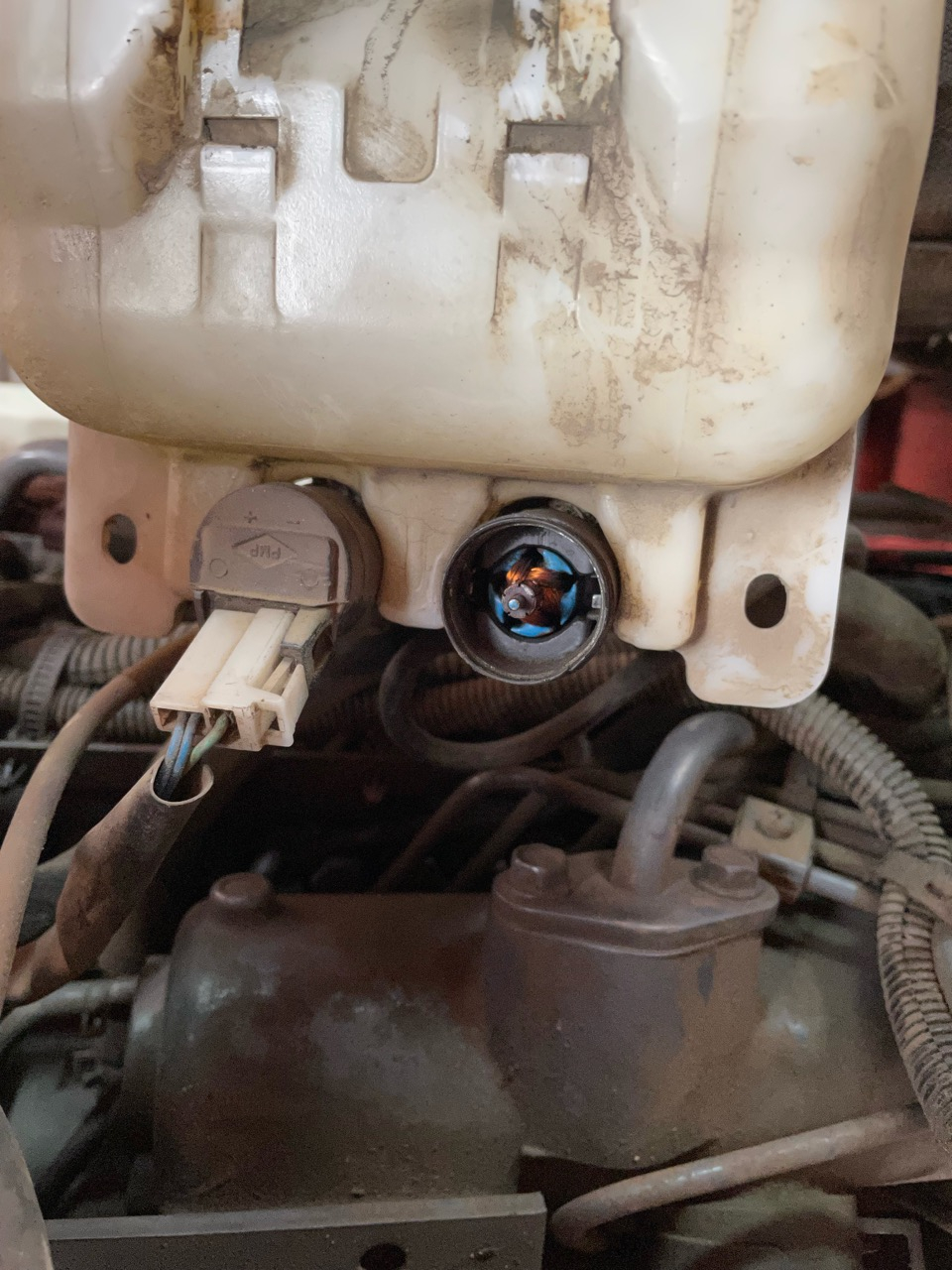

The AC on our Kubota L5740 is not cooling. In trying to diagnose, I discovered something that is not plugged in. The inside appears to have "points" like I remember from my old motorcycle days. It plugs into the back of the reservoir for the windshield washer fluid. The plug in location appears to have a coil (like copper wrapped around something. I tried to plug it back in and it wouldn't stay. I then noticed the insulation is stripped a bit and, likely will require replacing.
I took a photo of the stripped wire. I know better photos would help but thought I'd post first to see if anyone knows what this is.
I've got a copy of the service manual but searching it didn't tell me anything.
My suspicion is it has something to do with the windshield washer. I'll go back out and give that a try when the weather cooperates.

The picture tell's me nothing but the device you described is called "Relay" in your service manual and scamatics.
   / What is it? #3
I don't think it's a relay since there's only two wires. Maybe part of a broken windshield washer motor?

Those things at the bottom of the washer bottle are probably relay/pumps. Do you have a cab with a front and rear wiper/washer? I agree with tx jim on troubleshooting your AC issue.

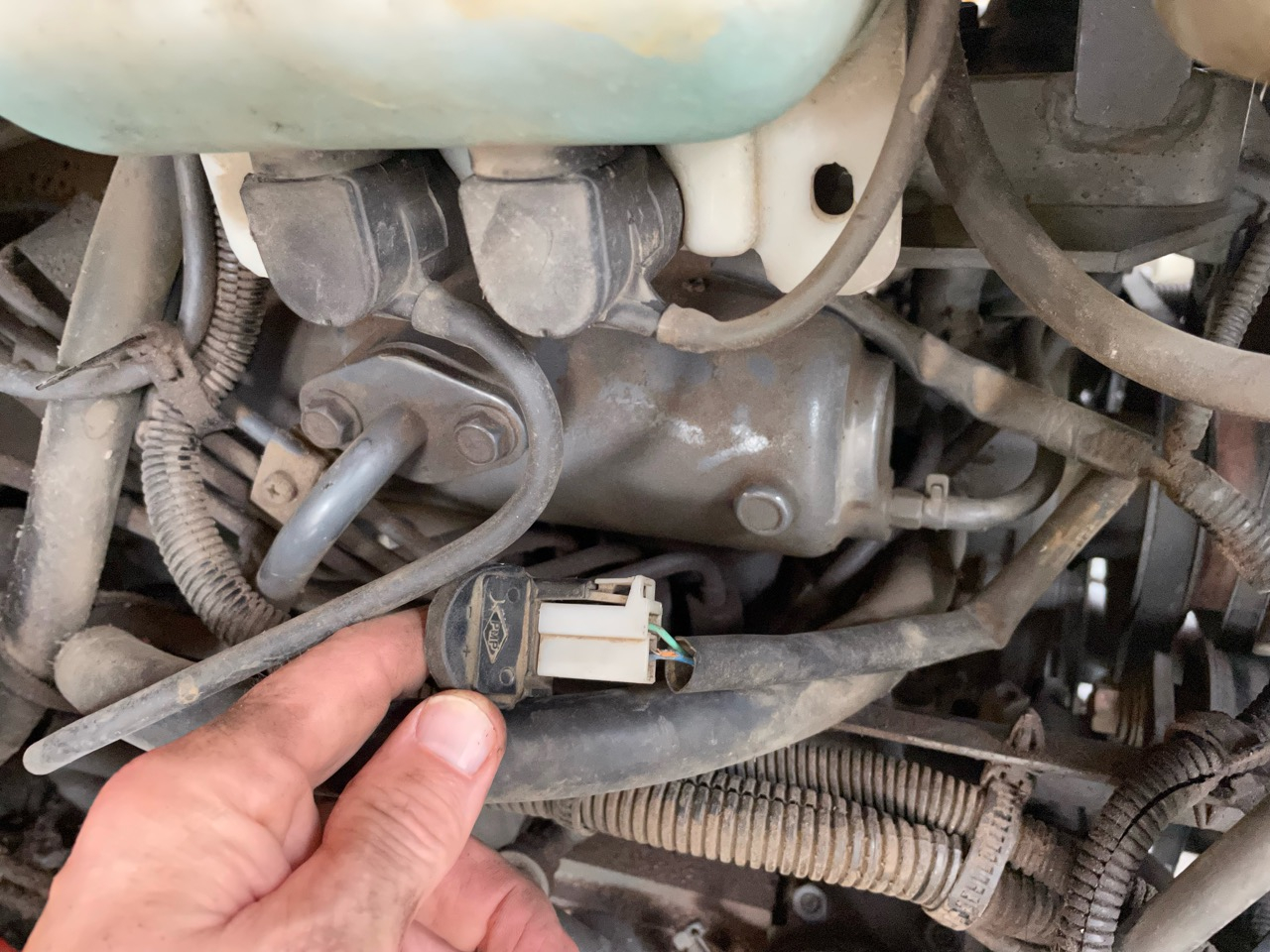

Here are the photos I should have taken yesterday. I suspect it is a relay for the pump for the windshield washer.

That's halves of a motor.
   / What is it? #10
Yea the points and coil is a relay for ws washer pump. Look's like the housing is busted and that's why it wouldn't stay "plugged in".:) The white piece is actually where it plugs in.
