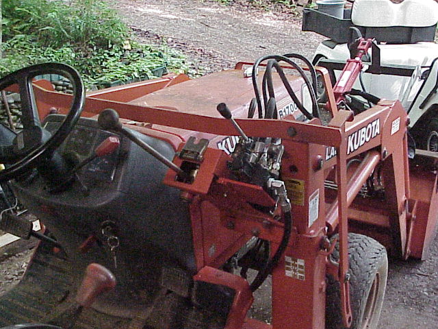

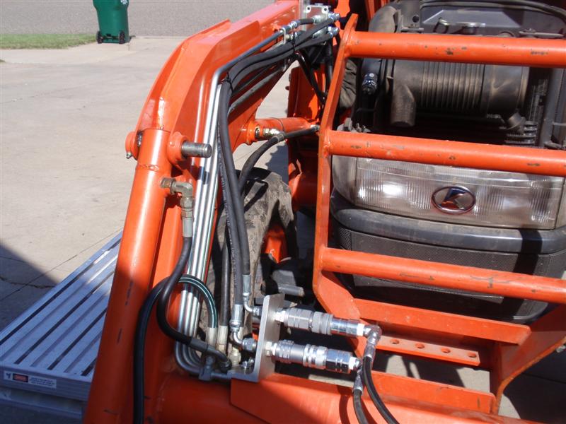

Great picture dstig1 & srs. I'm starting to gather the items needed to run my grapple hydraulic and your pictures help me decide now to plumb the front couplers. Initially I'm going to use my tractor rear remotes. My question is are there any recommended electric over hydraulic valves? If I can figure out what value to use on my DK40SE I believe I setup a electric hydraulic grapple thumb controller for less then a kit.

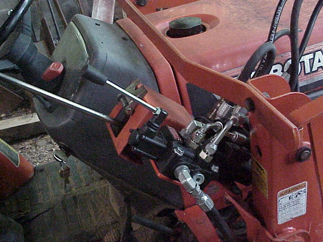

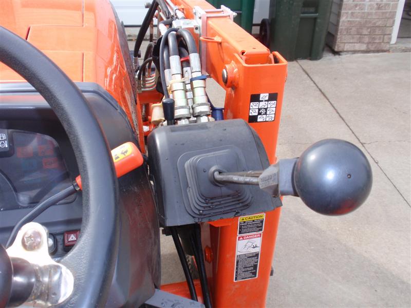

I got my valve and wiring harness from Fasse (Farm Equipment Solutions | Fasse Valves) I did need to modify the wiring harness as it did nto reach to the places I wanted it to for how I wanted to connect it. But the switch is a nice weather proof rubber covered thing that mounts nicely on the joystick with a couple small zip ties. They were really very helpful, especially for such a small order (to them).
You can see the black rubber switch on the joystick, if you look closely. It sort of looks like a gray blob just below the knob in the pic, with the wire running down the joystick shaft and through the boot.
attachment.php
Oh yeah - it took me 2-3 good days to get everything connected up including trips to Metalsupermarkets, the hydraulic shop (twice), hardware store, marking/drilling/cutting and just putzing around with how I wanted to do everything. Don't plan to bang this out in an afternoon unless you are very experienced in this type of thing.

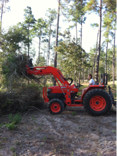

Once she realized how much time the grapple saves, my wife started to not mind the large price tag.

:thumbsup::thumbsup::thumbsup: I'm planning on the same location (either above or below). I was going to plumb it in with fittings vs. connecting it with hoses.
If surpuss center sent my package within a reasonable amount of time, I would have installed it last week :mad::mad::mad: I bolted on a piece of 2" angle that I was going to weld on for the bracket but wanted to mount the spools first...

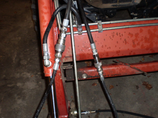

I put quick connects on the valve also. Just in case I want to take the loader off for some reason I can leave my grapple hoses connected to the loader. And all of mine is bolt on. The two bolts on the bottom of the factory bracket are long enough for another 1/8" steel plate. Then I got a longer bolt that holds the plastic cover and ran it through my bracket and back into the cover so it could keep the lever end from flopping around. Just a little stouter in my opinion. Works great!!!
/ What is needed hydraulically for a grapple? #49
I did the same thing with my first tractor and had it set up to split when the loader came off. I would not recommend that for most people though as I never took the loader off (most of us don't) and therefore it was just extra expense. It also means you have a lump of four bulky QCs dangling at the base of the FEL mounting post. If I were to do it again I'd just run a single length of 1/4 or 3/8 hose from rear remote all the way to the torque tube. It would not tale long at all to remove the lines from the rear and leave them on the loader if you ever do take the FEL off. Snip a few zip ties under the tractor and you are done.

Understood. It is still relatively clunky compared to plain single piece hose though and offers four, eight or more additional places for leaks. My bottom line is that because I simply zip tied the lines under the operator station, it would be trivial to snip those and just leave the whole kit in one piece with the FEL. Otherwise you have twice as many caps etc to fool around with each time you remove the FEL. You also need to secure the QCs on the FEL mount mast to keep them from banging around or getting snagged.
Don't get me wrong, the dual hose multiple connector system works fine. That is actually what I used. I just wouldn't do it again.

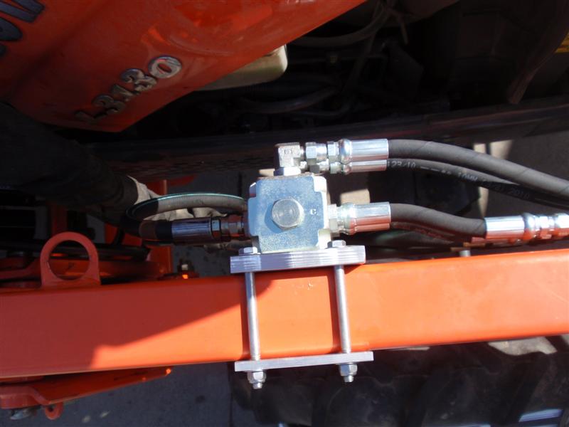

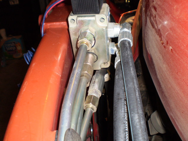

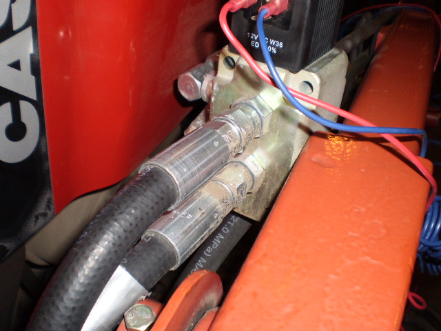

Dave.... Here are some pictures of the valve.
