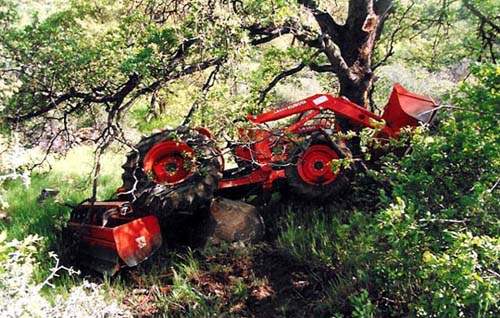

Ask me how I know these guys are somewhat correct? This one did not roll over, it did an end over end twice then sliding down the hill until the large Oak tree told it to stop being silly! I was not the operator....
