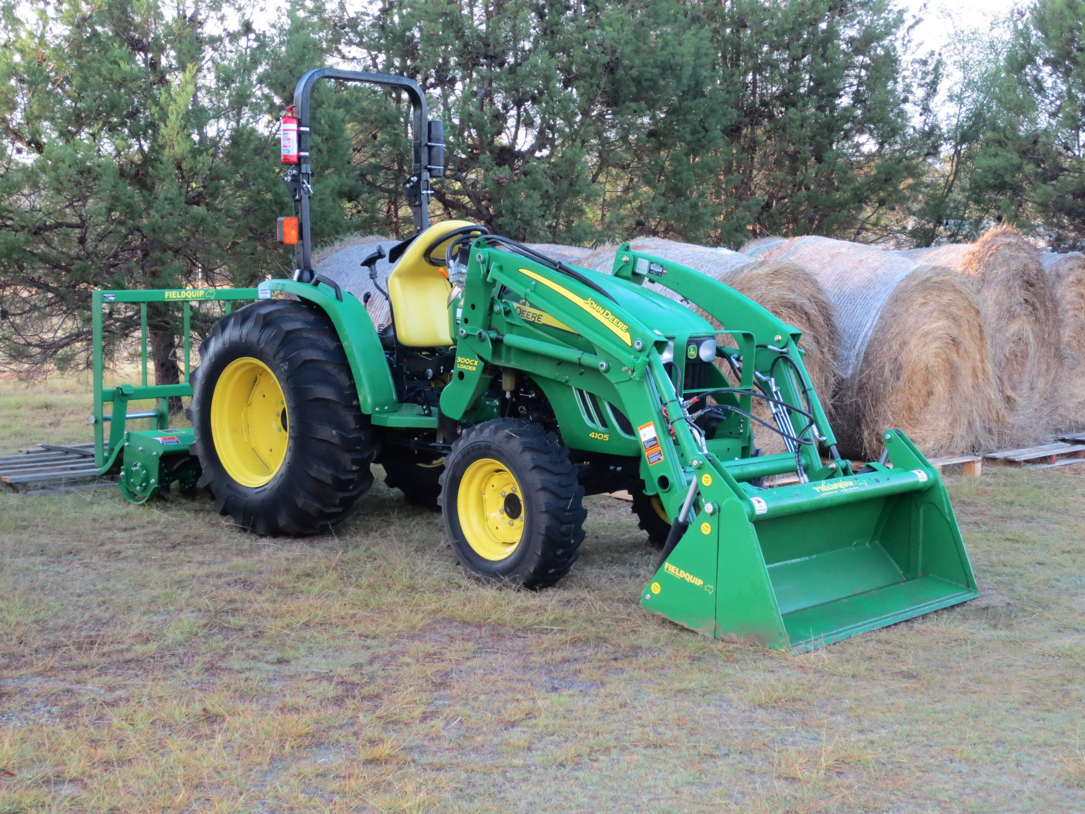

I know Mate, and being retired Navy myself having fire extinguishers around the ship (+ bi-annual shipboard fire fighting training) has made not having them around uncomfortable. I've got two in the house, one in the kitchen & one by the wood heater, one in the Ute and one on the 4105.
I've never had to use any of them... YET.
But they're there if I need them. :thumbsup:
