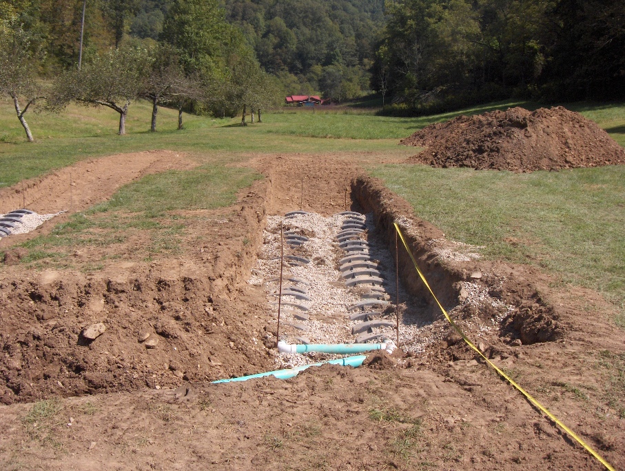

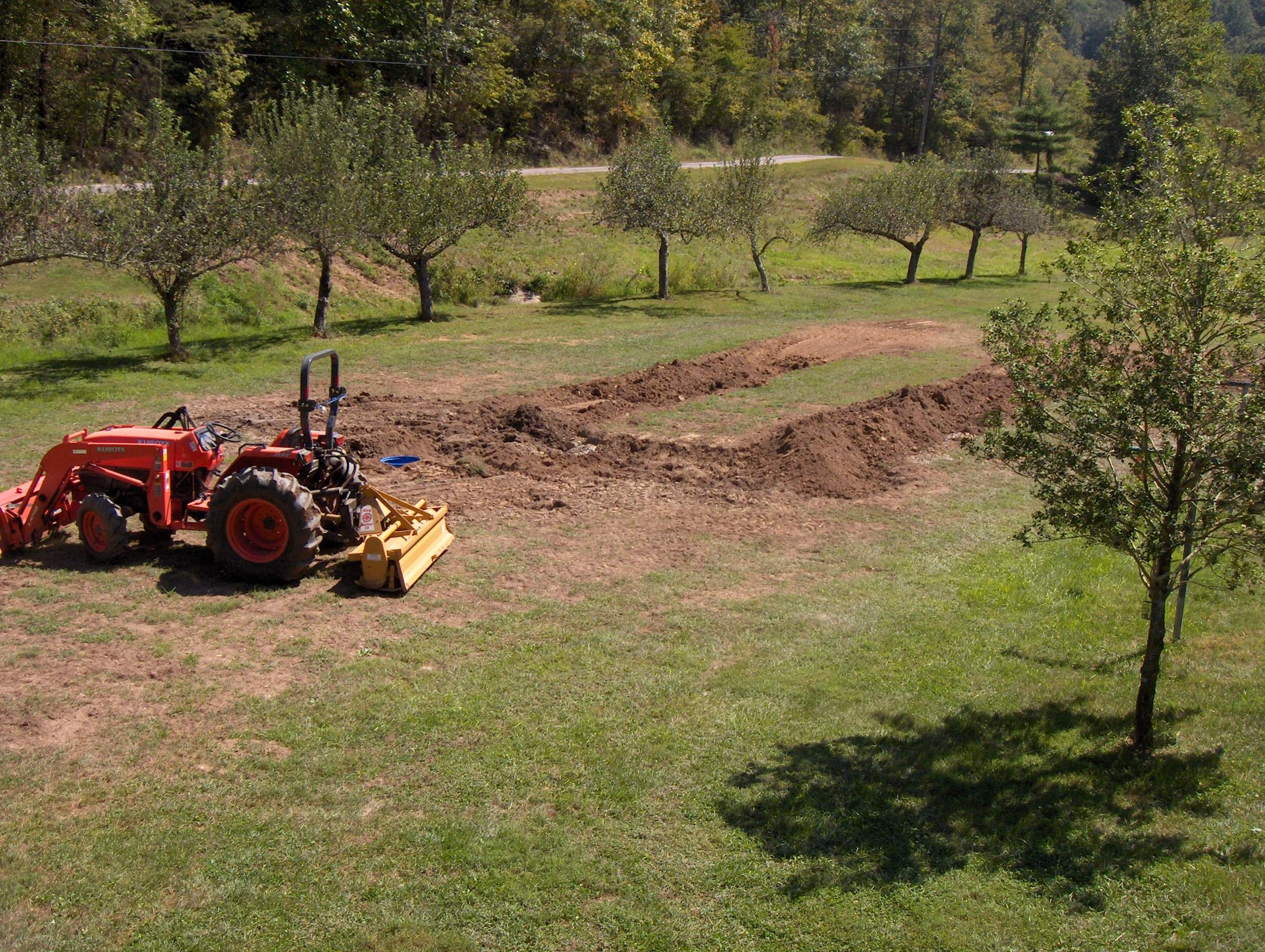

I used the no gravel type of leach field called Bio diffusers and I figured this would be plenty of additional leach field to solve my problem and here are how they lay in the bed.
We call those envirochambers up here, I also have used them, easy to install and work way better then the ole pipe an gravel method{IMO}. I did not lay my together in one hole thought instead I dug 4 different run offs. :thumbsup:

I started to dig separate trenches but I did some research and this is an acceptable method. This way putting 2 runs in a trench allowed me to do the install without bringing in a back hoe.

Thats good to hear. I think my leach bed was getting overloaded and I wanted to add onto the old rather than replace it. My soil is gravel and sand. If this turns out to not be enough I can use the distribution box to add more or go to the end of the Bio diffusers and add more.

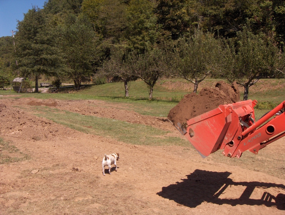

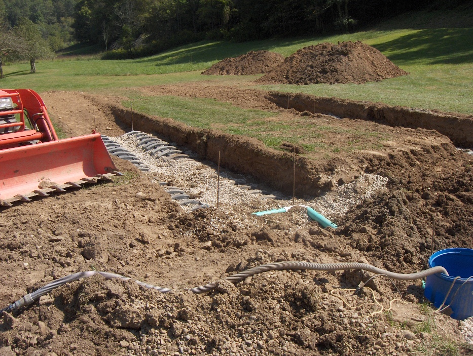

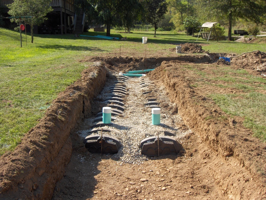

Thanks. The tiller worked very well and I needed it mostly at the layer of crust and then used the FEL with the tooth bar and when I had the proper grade I tilled my way out of the trenches a few times to make sure that the ground was not compacted. Here is a few pics of how I filled in the sides with gravel this was said to make the system less likely to collapse. The gravel was also supposed to increase the perc area of the system. If you didnt use the gravel you had to fill along the sides and then walk it in to compact the soil to prevent the system from collapsing when backfilling.

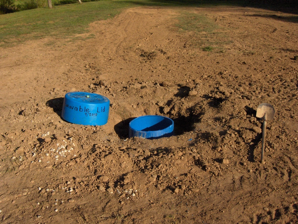

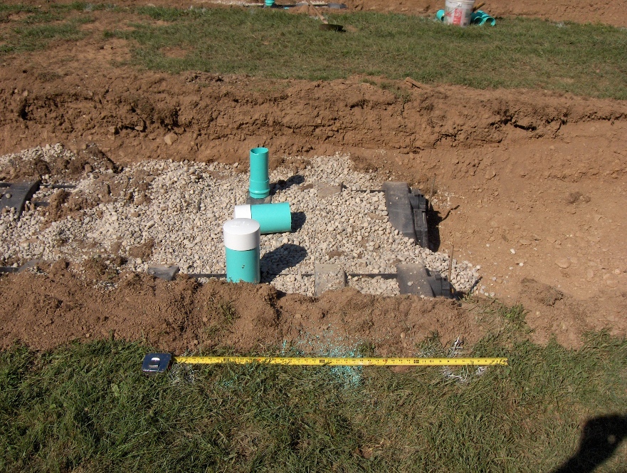

What do you think of Ridx or other additives? I put re-bar at end points of the system so I could locate the critical places later. I did that with the first Leach field and it was great to be able to locate what you wanted with a metal detector. I did the back fill and of course the Jack Russel Terrier had to supervise the whole project. He (the dog) is a tough one to work for. I had to fashion a lid for the home made distribution box. I cut the top off of another barrel and heated it up and stretched it a little to slip over the lower section. Seems to be working well so far. The finish grading and reseeding will have to wait till we have a few good rains to settle the soil.
