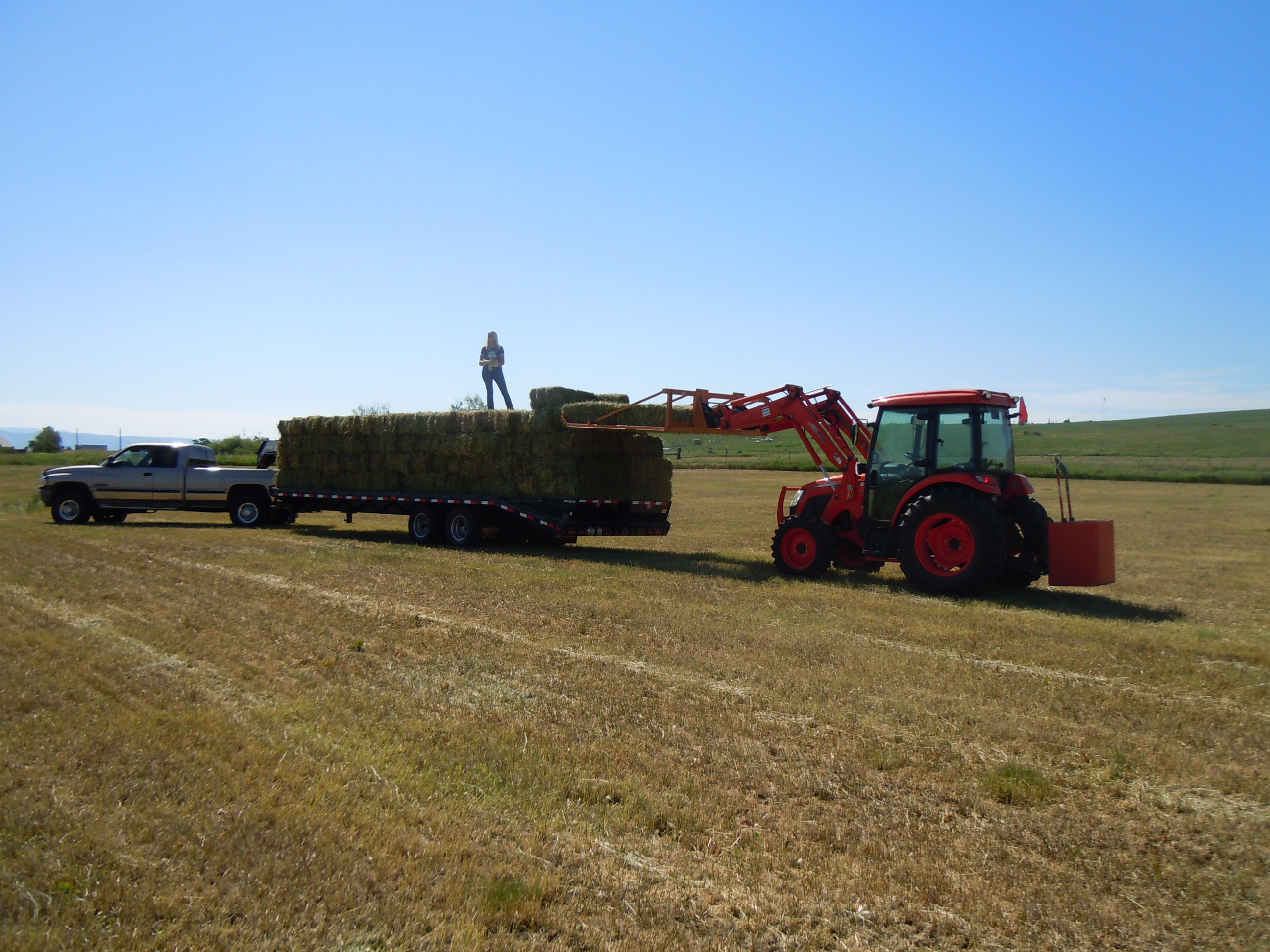

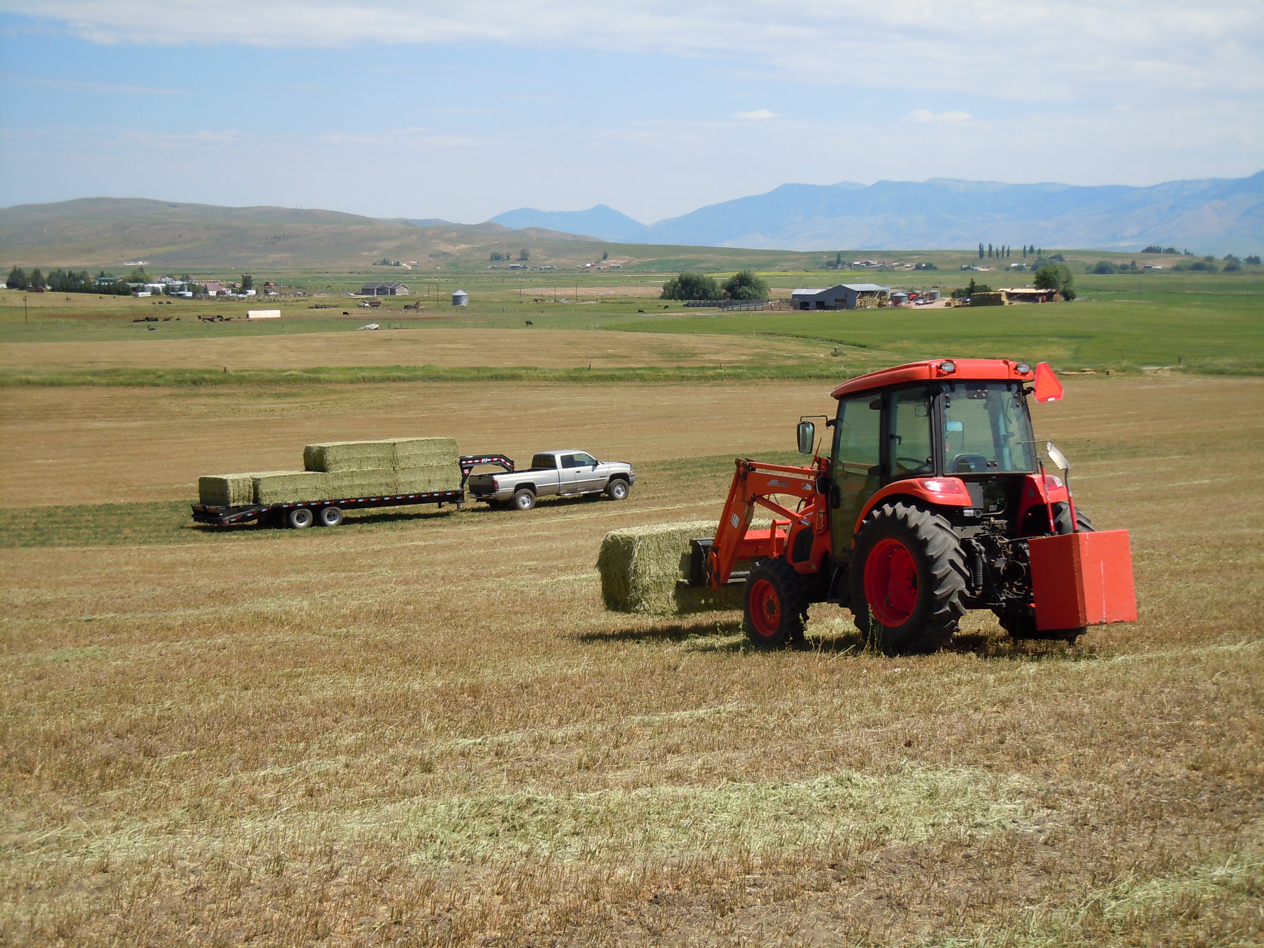

I think Rimgaurd filled rears and a ballast box is the way to go for lifting the bales you mentioned. My tires are not filled yet but this is what I use. Concrete ballast coming in around 1700 pounds.
The big bales were about 850 lbs.
   / What is the best Ballast #17
Thanks Jeff, yes filling for Lifting. My FEL is rated for 1200 at the pin or 900 at 500MM. Planning on using forks for 3x3x8 bails but because of the length will be taking them off the trailer from the side of the bail so I don't have too much hanging forward. I don't want to scratch up the ROPS!
Have you weighed those bales? I am seeing 800 lbs each. You will definitely need ballast, probably an implement on the back (ie box blade, etc) as well. You are 900# at 500MM, but your bale weight goes out to 3 ft. In addition, that 900# is with no forks. Forks add a few hundred # right?
Please be very careful and try working with one on the ground first so you see the limits.
