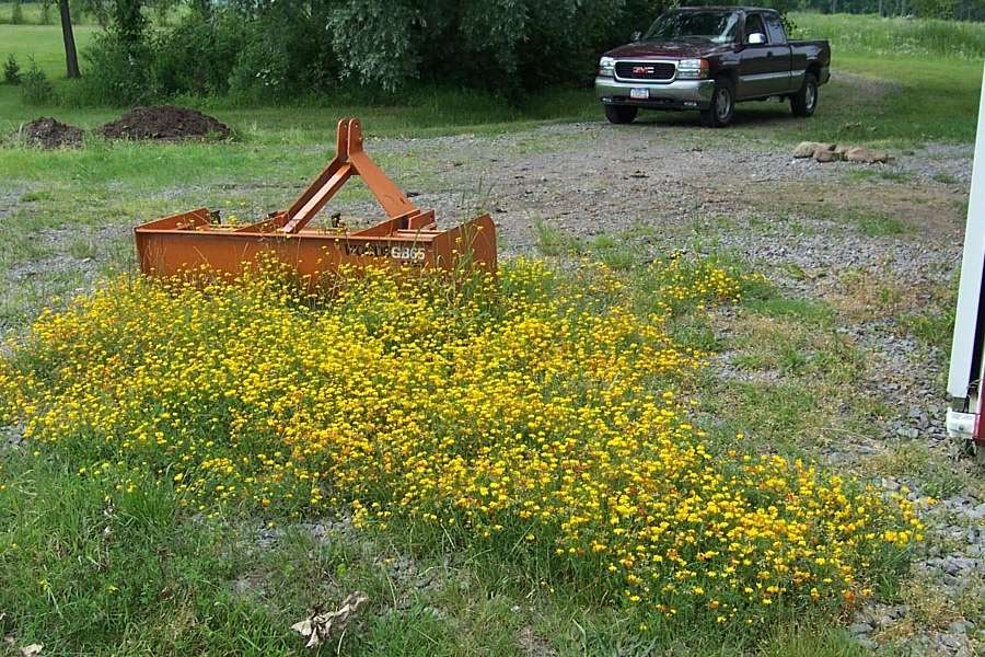

Scott,
I bought a Woods GB65 and have been happy with it. It is very heavy duty. (See attachment) I am not worried at all about its robustness. I paid $550, delivered.
Is it better than a King Cutter? We'll I saw my first KK blade at TSC over the weekend and yes I'll say it is. And I doubt if anybody who put these blades side by side would disagree.
Now ask me, What would you buy today, with the knowledge you've gained over the last year.
My answer: The KK. It is cheaper, lighter and would suit my needs just fine.
Buck

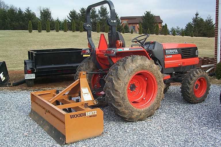

I like Woods products for their quality and really like this HB-72 for it's heft. I wouldn't say it's the best box blade but it will do the job. It fits my L3410GST perfectly but sometimes it is a little too much box scraper. I then have to use my 60hp M5030SUMDT but the wheel spread is over 7 ft. with the 16.9's and surely doesn't fit it perfectly.
