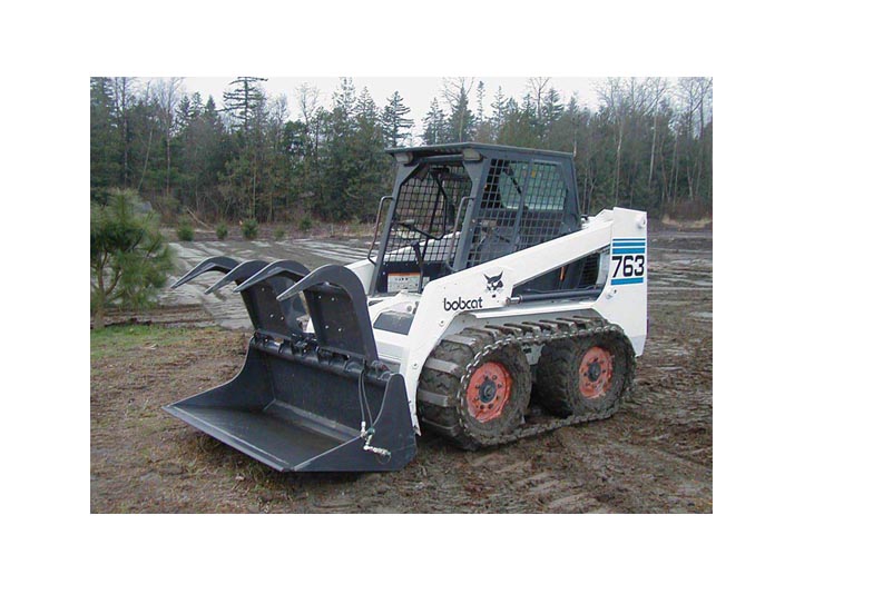

Here's a picture of a bobcat skidsteer with the industrial grapple attachment. Also has tracks on it.
Blake
WA

Egadd, they've got those tracks too tight, awfully hard on axle bearings and chains, good looking unit tho.
