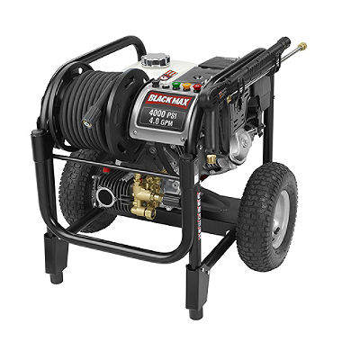

Bought the 13HP, 4000 HP, 4 gpm pressure washer at Sam's Club about 3 years ago. It was $999 back then.
BlackMax :: BM80917
Looked this when I got it.

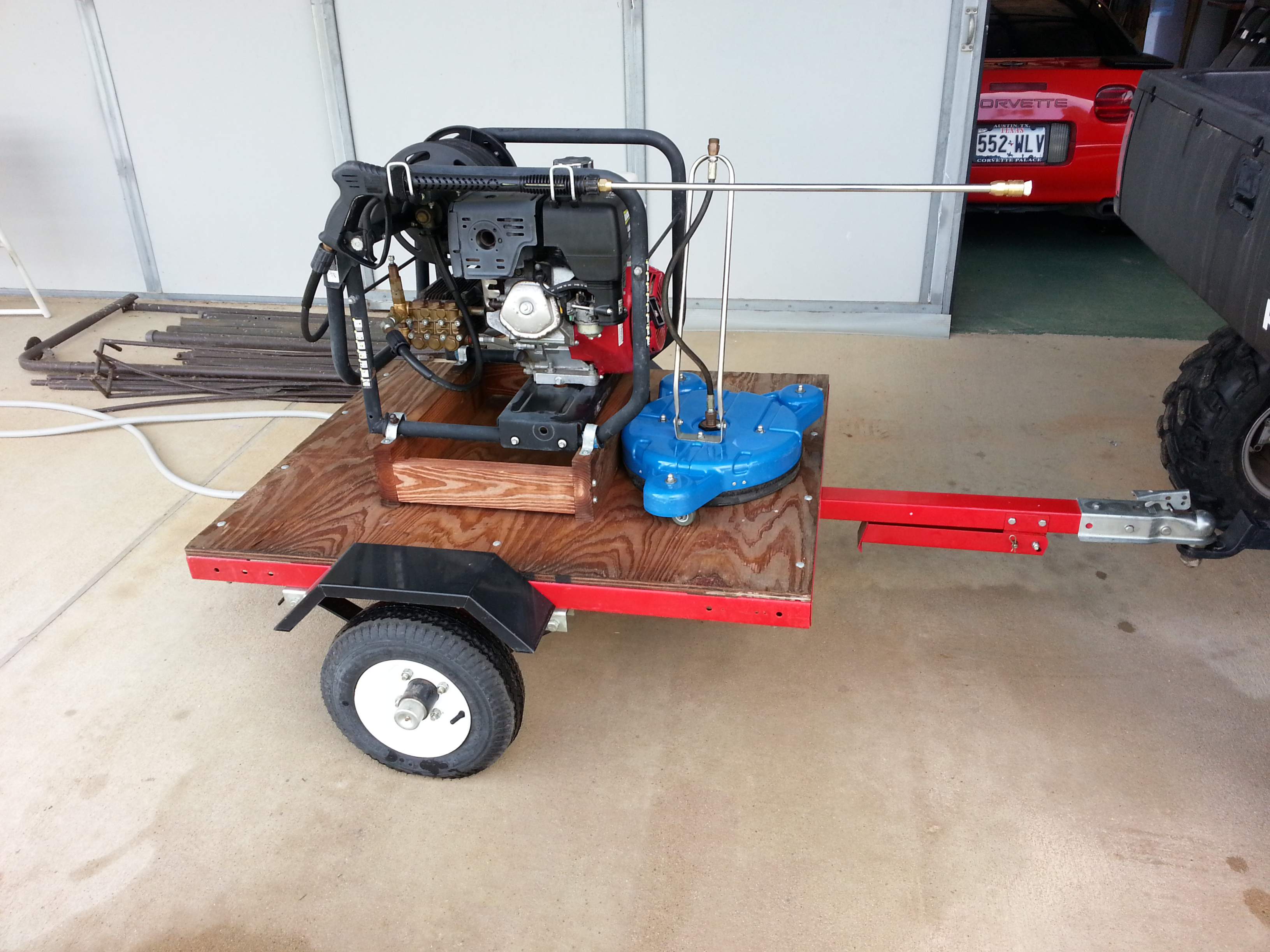

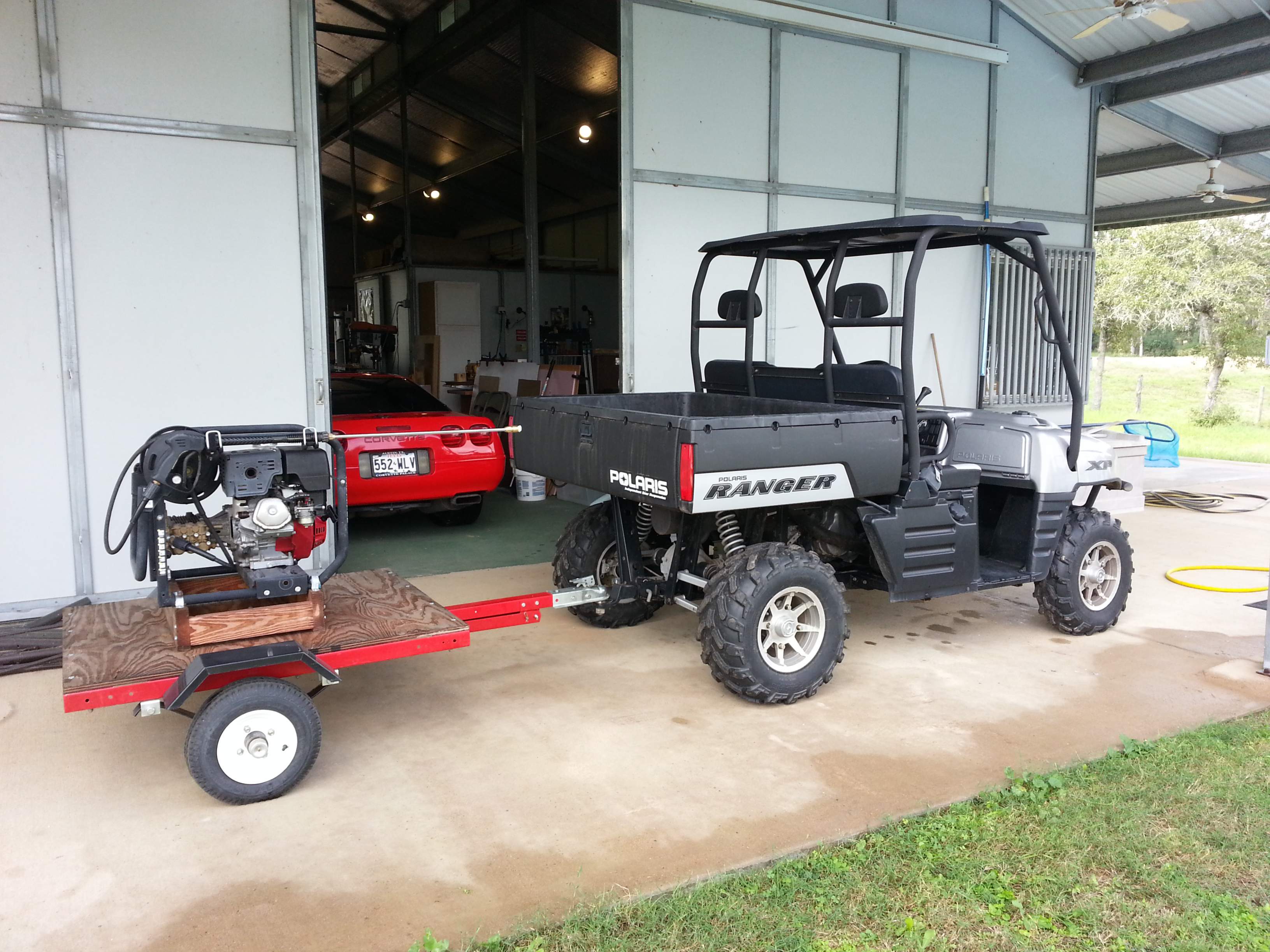

It is heavy and not as portable as I would like so bought a 4' x 4' trailer from Harbor Freight Tools for $199 less my 20% coupon. Removed the wheels and installed the PW on trailer.
Now I can pull behind Ranger and use it anyplace I have water.
It has hose reel and 50' hose plus a set of various angle nozzles.
