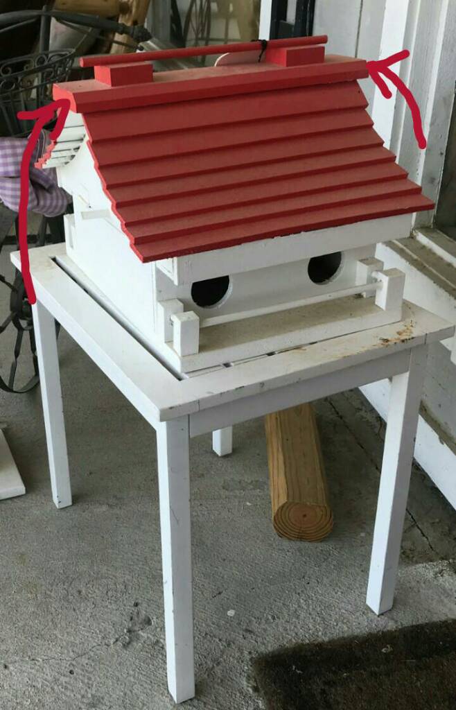

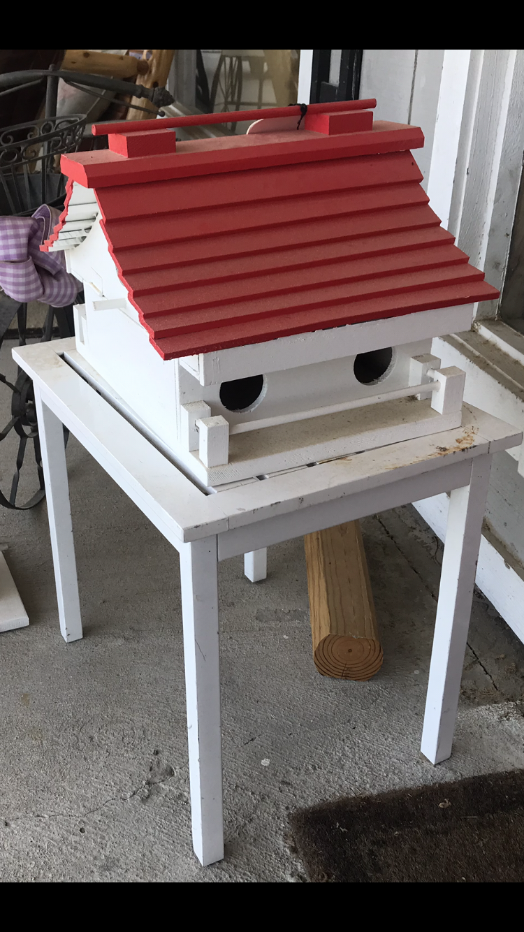

Not sure how to put this on a pole. Do not have a pole yet.

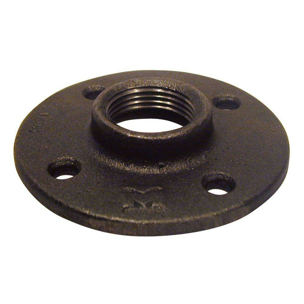

If one end of the pipe threaded screw on flange than fasten to bottom of bird house
   / What is the best way to mount birdhouse on a pole? #3
If top (marked) is strong enough, a screw eye each end, wire across with piece of rubber hose, hang over tree limb.
Or pipe flange on bottom, about 2" pipe.image_2019-06-19_18-29.jpgblack-pipe-fittings-521-605hn-64_1000.jpg

Thanks. Thinking about the flange idea.
   / What is the best way to mount birdhouse on a pole? #6
Or pipe flange on bottom, about 2" pipe.View attachment 609699View attachment 609700
I mounted my bird feeder via the flange method; used about 5' of gas pipe and put a flange on the bottom also, to provide stability without cementing it in.
