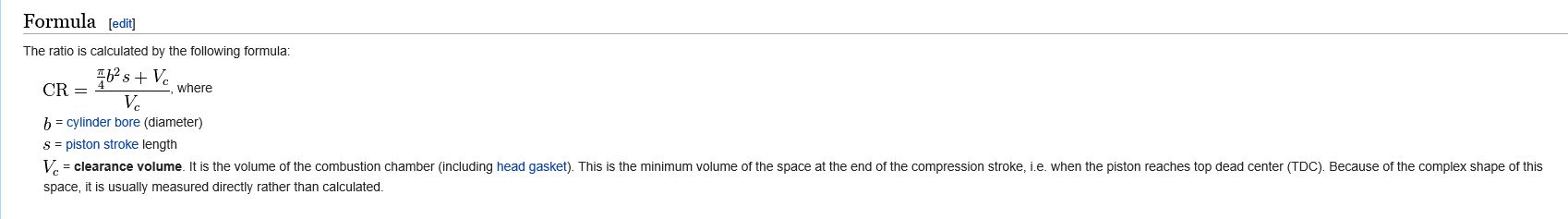

This is the one that was over my head:
//greg//
I hear ya on that, there is a little more to add and take away to get the true rating
