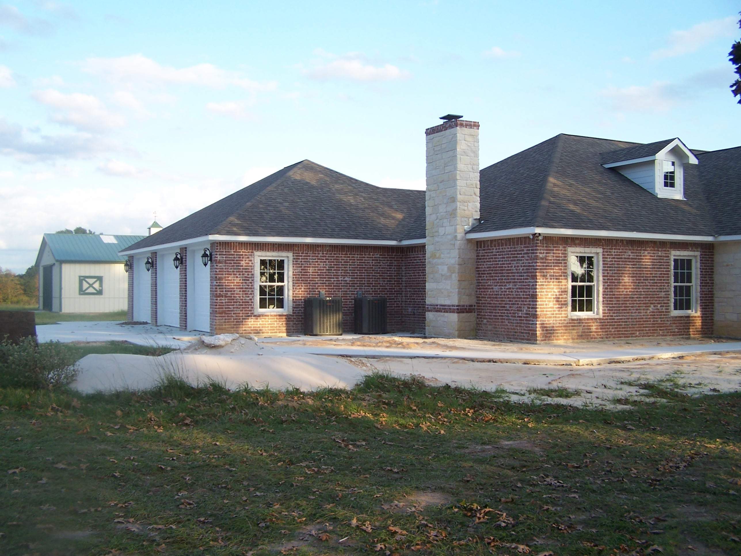

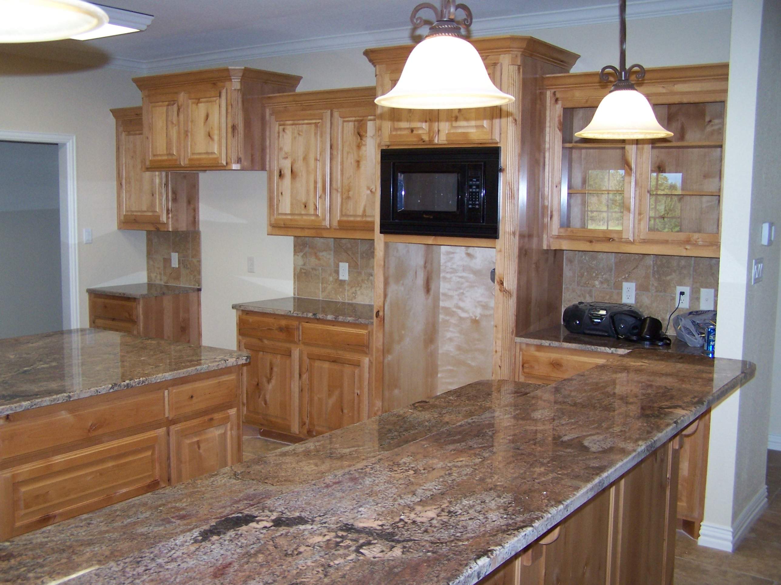

Seems pretty high to me but it does depend on the area. In 2009 we built all brick/Austin stone 3200 sq ft heated/cooled, 5200 sq ft under roof for $100/sq ft. It is pretty nice with custom kitchen cabinets, 135 sq ft granite countertops, 9' ceilings, crown molding in every room, etc.
