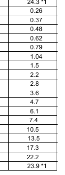

M7060 12 speed creeper has 6 speeds 1.04 MPH or less, but that isn't enough selection for OPs application.
Most of my caking is .4 .5 .6 .7 mph.
Where litter is deeper I need .1 .2 or .3 Again all depending on litter depth.
I need .8 .9 & sometimes 1.0-1.2mph where litter is thinner out in center of 40’ wide house.
Think of it as bush hogging really thick tall grass.
The tractor has plenty of power but the machine can’t process the clippings (litter in my case) with too fast of ground speed

yes, i was referring to Kubota M series Utility creep options.
