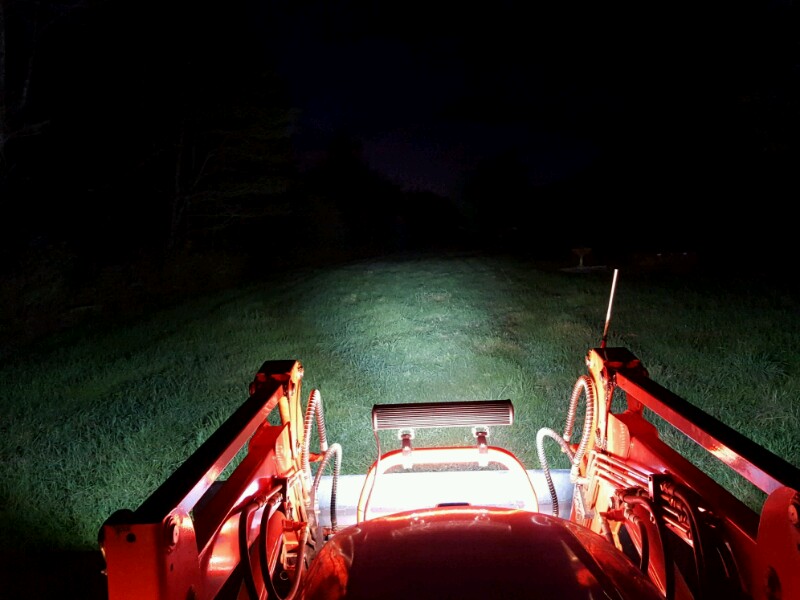

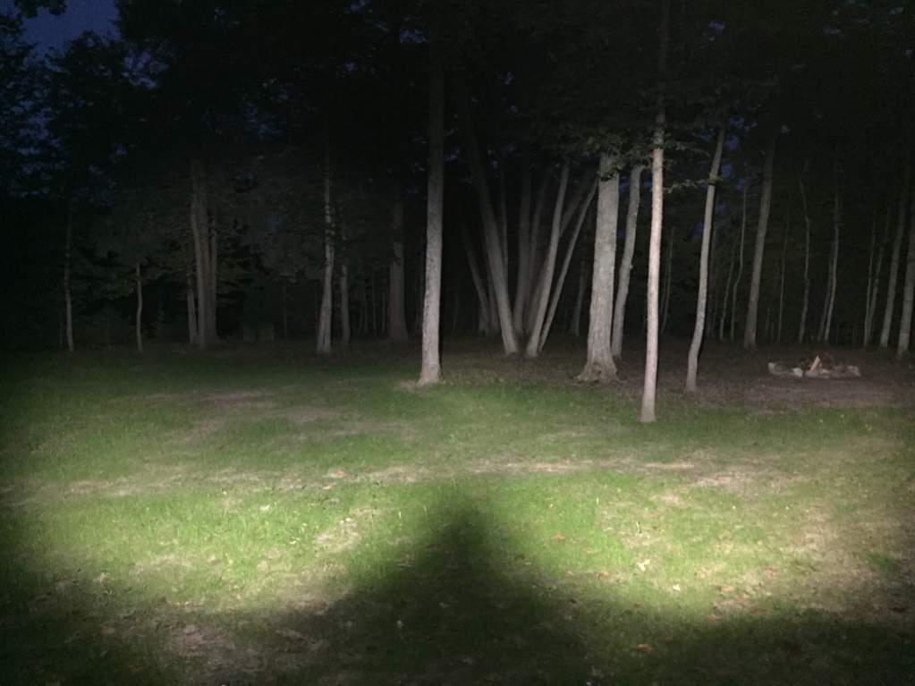

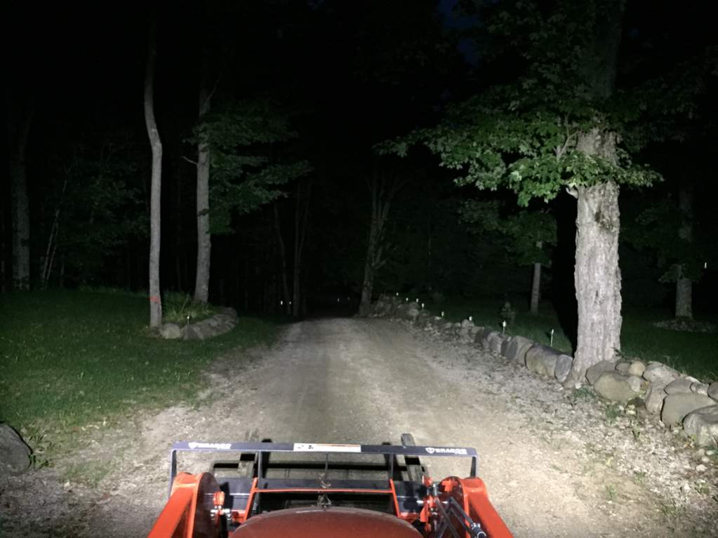

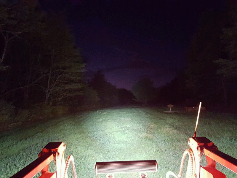

Not the same tractor, but probably similar alternator output. I run a 108W tied right into the high beam switch, because the high beams are pretty much useless. No extra switch to deal with. No problems so far. Pics are low beam - high beam. I think the 108w is plenty.
