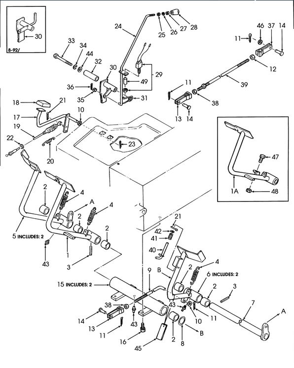

This rod is connected to the clutch pedal but does not move when the clutch pedal is depressed. What is the purpose of this rod?
It's the operating rod for the left brake. It is not connected to the clutch pedal. The clutch pedal is supported by the shaft that operates the rod in question.

All I can tell you is that the tractor is a NH 1920. This is a friend's tractor who bought it used and has no manual. This is my first experience with a tractor. I have used it to plant food plots and bush hog his property. In another thread about the trouble engaging PTO, it was suggested to check/adjust clutch pedal free play. As I was looking at the clutch adjustment rod I noticed the other rod in the pic and was curious as to it's purpose. Thanks for everyone's replies.

If it doesn't move when the clutch pedal is depressed then they are not connected. Which means "keep looking."

Let me restate..the mystery rod is attached to the same shaft that the clutch pedal is attached.

asked and answered a couple times now.. it's never been a mystery ;)
   / What is the purpose of this rod? #16
Nope. Apparently. "Attached" and "pivots on" is a critical difference.
   / What is the purpose of this rod? #17
Here's a parts diagram of a 1920 pedals and brake lock...
New Holland 1920 Transmission/PTO 07I01 PEDALS & BRAKE LOCK - 1920
It's listed as a "rod" with part # SBA358510740
with an alternative part # of SBA358500320
It appears to be a brake rod w/clevis assembly as is shown here...
Ford, 1920, Brakes, Sub-Component, BRAKE ROD W/CLEVIS ASSEMBLY, SBA358510740 at Wengers Of Myerstown
It also appears that the brake and clutch rock on a common shaft. So, instead of pushing the clutch, push some other pedals and see what moves it.
Here's a bigger picture of the pedal assembly...

and there you can see the clutch / 2 stage lockout to keep the pto engaged and keep you from pressing the clutch all the way down.
