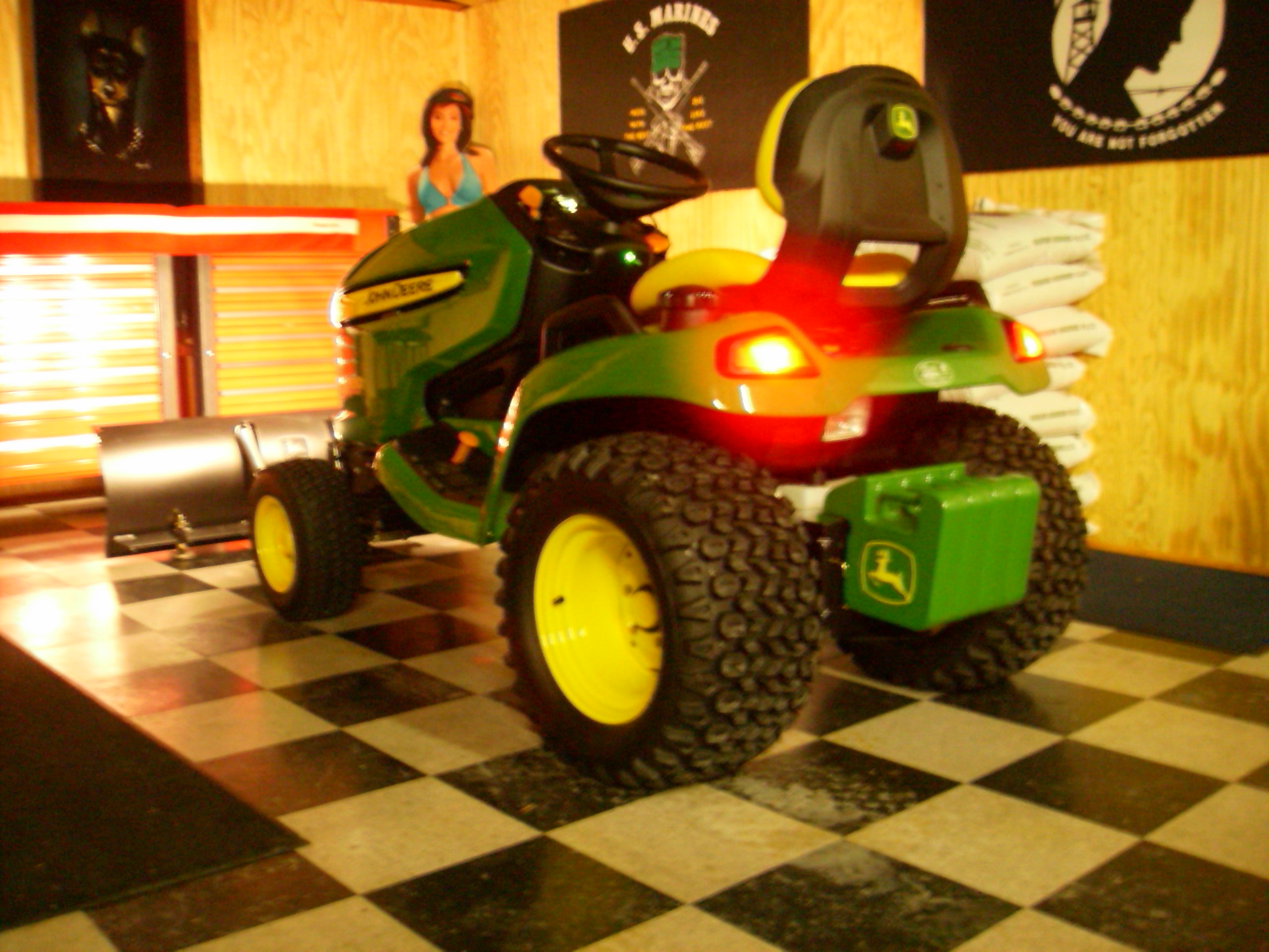

I guess I'll be the guinea pig here. I have an X530 that I cut grass with last year, plowed several feet of snow with and am cutting grass with again this year. I've also moved and spread several yards of dirt with the Johnny Bucket jr. So far not a single problem or complaint.

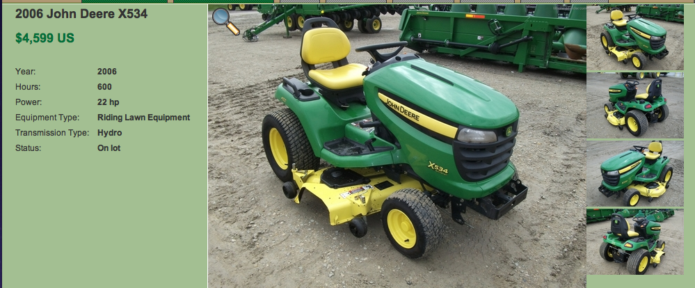

How many hours will the air cooled engine last?
I've got a line on this machine at a local dealer but the number of hours seems high. I've offered 3500 and he's stuck at 4100.
Thoughts?
