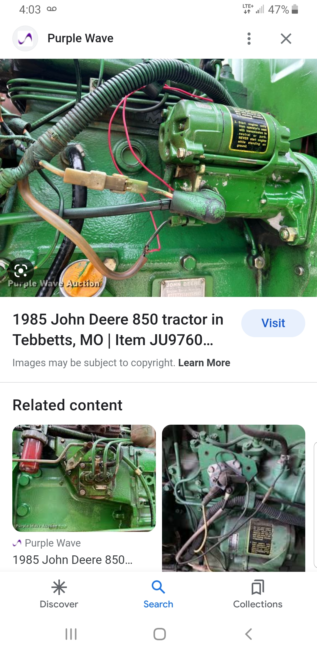

What is this capped hole right behind the starter? Had it blow out. Kinda stuck could use some knowledge.
   / What is this capped hole right behind the starter? Had it blow out. Kinda stuck could use some knowledge. #1
jkgeiger42
Apr 16, 2023
1
John deere 1050 TM1192
   / What is this capped hole right behind the starter? Had it blow out. Kinda stuck could use some knowledge. #2
You talking about the freeze plug?
   / What is this capped hole right behind the starter? Had it blow out. Kinda stuck could use some knowledge. #3
You need that. It holds the water in.
   / What is this capped hole right behind the starter? Had it blow out. Kinda stuck could use some knowledge. #4
   / What is this capped hole right behind the starter? Had it blow out. Kinda stuck could use some knowledge. #5
Don't run the engine until the freeze plug is replaced and the tractor is refilled with antifreeze. Hopefully, the block is not cracked.
   / What is this capped hole right behind the starter? Had it blow out. Kinda stuck could use some knowledge. #6
Keyword, ANTIFREEZE. In as much as no one knows your location it might be prudent to use a 50-50 mix of antifreeze and distilled water.
   / What is this capped hole right behind the starter? Had it blow out. Kinda stuck could use some knowledge. #7
   / What is this capped hole right behind the starter? Had it blow out. Kinda stuck could use some knowledge. #8
OP's pics are from an auction....this is the first post from this person? :unsure:
   / What is this capped hole right behind the starter? Had it blow out. Kinda stuck could use some knowledge. #9
Shows the freeze plug they are talking about. Let's give the benefit of the doubt.
