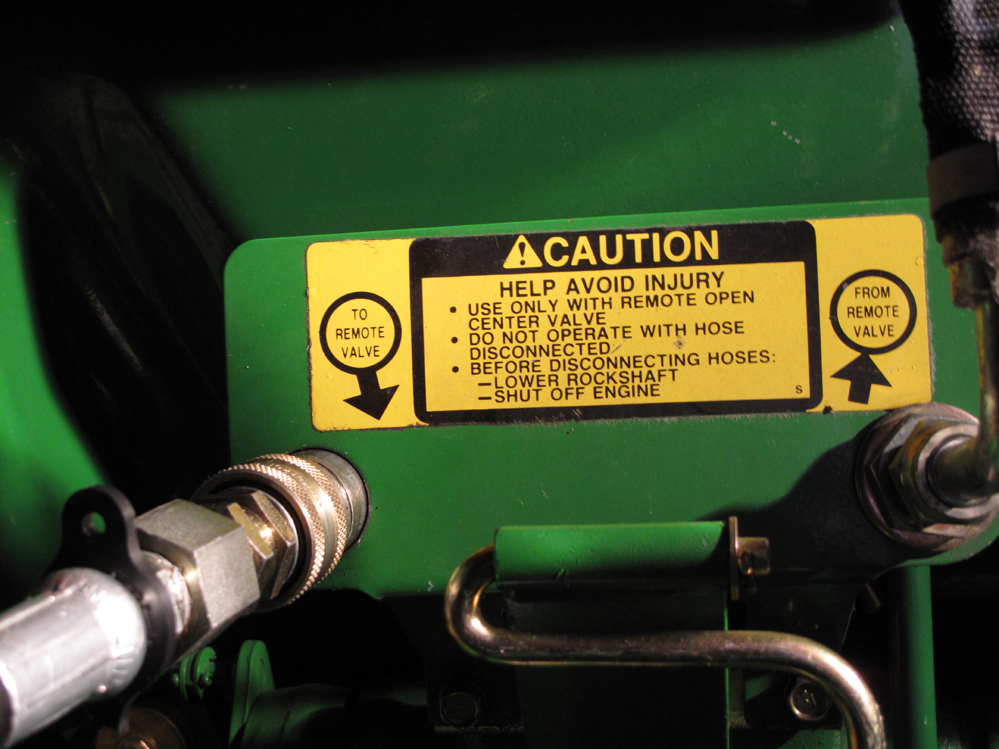

What is this extra hose for on my 990?

sjhulsmn, When you disconnect your 8B bh from your JD1070 do you then connect the hose that is free into connection on the left? That is the only place that mine could connect because the other connection is different.
   / What is this extra hose for on my 990? #12
The loose hose should have a male QD. When the BH is disconnected you MUST connect this male QD to the female QD that the BH supply line is currently hooked to. The BH return line probably has a female QD and connects directly to a male QD on the lower right of the tractor. When the BH is disconnected that male QD on the lower right should have a dust cap and be left alone.

Thank you all for your help. In addition I have been reading a lot of different posts on Power Beyond. I now understand that PB is a continuous flow and that if nothing is hooked up to it that the hose that is free on my 990 that is labeled "from remote valve" (see pictures) needs to be connected to the Quick Connect labeled "to remote valve". The 3rd connection from what I can understand dumps directly into the rockshaft case. I have attached a schematic from JD's part site. My understanding on this may not be correct but with the 8B bh connected as it is right now to the 3rd connection, that the Rockshaft will not raise or lower. I have not been able to test this yet myself. However if I were to connect the bh to the 2 connections labeled "from" & "to remote valve" that the bh would still work and that also my Rockshaft would work as well. The other note is that you don't hook it up that way because you don't want the rockshaft to operate with the bh connected although the arms to the rockshaft are completely removed (as there is no way you could have the bh connected and have the arms attached) so even if it did work it would not cause any harm. One person noted that they wanted to use the PB with their wood splitter which was a 3 point hitch so they needed the rockshaft to work in order to lift it up and down so they connected the wood splitter to to the "from" & "to remote valve" connections and not to the 3rd connection like the bh is connected to and then the rockshaft worked.
Does this all make sense and would you say that my understanding is correct on my "new" "used" 990?

Doubt any damage, relief valve for pump may have opened and prevented damage.
Interested in what you find on the rackshaft operation, vs how splitter is connected. Same as BH or with PB connectors.
