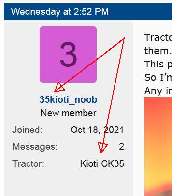

Yes, It's a CK35. Approximately 2012 with the manual transmission. I'm gonna talk to a mechanic today. Tried some wire splicing-seemed low risk as they were probably not high current. No luck yet.
